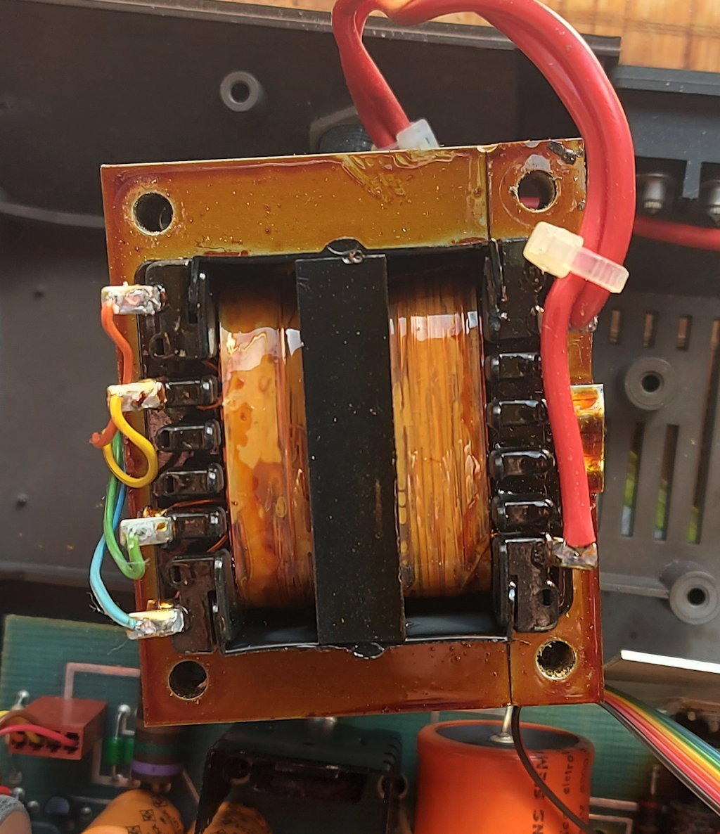

RE: PC-100 US Version - Maximilian Hohmann - 03-08-2022 11:22 AM
Hello again,
you made me curious enough to open one of my PC-100 Printers (this one is a PC-100C) to look inside and take some measurements.
This is what the transformer looks like from the bottom side:
http://www.bombie.de/tmp/20220308_114815_crop.jpg
Is is 67 x 55 x 48 (height) millimeters big. The power rating is 20W. There is only one primary winding for 220V and two separate secondary windings. Between the red and yellow cables I measure 24V and between green and blue there are 9.5V
Beside the transformer there is quite a lot of empty space in the housing. I am pretty sure that a small 110V to 220V tranformer (mayby taken out of one of those cheap adapters) would easily fit there. If I were you I would try that solution instead of finding a matching 220V transformer. Unless you can find a broken PC-100 that you can cannibalise for parts.
Hope that helps,
Max

RE: PC-100 US Version - Duane Hess - 03-09-2022 07:09 AM
*** Edited as prematurely posted somehow.
Measured the voltages across my transformer and they agree with Maximilian's and the ti58c.phweb.me schematics:
- Red-Yellow 23.5 VAC
- Green-Blue 9.2 VAC
This certainly implies if you can get a transformer that matches the power and voltage ratios you should be good. Tried to measure the ohms across all the coils, but my meter is screwy.
The transformer is marked:
1014877-2
TEX TRANS
1181 7827
Attached a couple pictures. They are poor; only have my flip phone and cannot hold my hands still. However, they show the transformer has only the number of taps needed. I took it out and all non-shown sides are plain other than the markings above were stamped on one side. The circuit board is quite blurry, but it shows the unit closely matches any pictures I've seen on the web. i.e. the 100B & C are very similar if not identical in overall layout.
Its very hard to see in my pic, but from what shows in Maximilian's photo does match my unit. Except the big CAP in the lower right of his picture is orange, where mine is dark blue, color differences in some other items and a very small ceramic capacitor directly right of the printer motor cable.
datamath.org seems to indicate the B&C models are very similar. Where the original PC-100 (no suffix) and A likely have pertinent circuit board differences due to different calc model support.
My 100C is marked at 120VAC and 0.35A.
The various PC-100 models supports different calcs, but seem to have the same printer (judging from pictures). Also, all the different calcs supported between the various PC-100s use the same battery pack, but some have different power adapters (output voltages and amps). So, the original 100 or 100A might have different transformer values for the spare battery charing compartment. (personally doubt it)
From datamath.org its hard to tell if earlier PC-100 support for various calcs was in terms of how it communicates with the calculator or had different power for charging the batteries. Would make sense it was for communications differences, as they all use the same battery pack (BP-1A).
You'd assume since the various calc models take the same battery pack, PC-100 powering the attached calculator and printer circuits should be the same. i.e. older calcs had different power adapters, but might simply be an "age revision level thing" of plug and charging circuits, but internally all operated at the same levels?
Just my guessing.

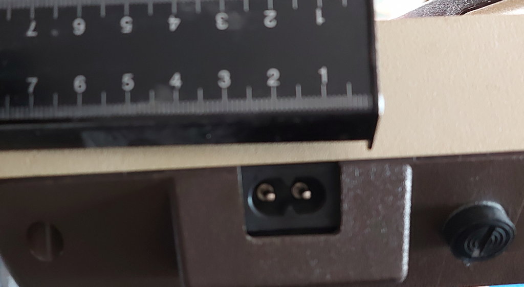

However, I'm afraid that the power cable connector at the printer side is different between the 220V and the 110V version,
I'll take a picture later today, and this is probably more difficult to solve ...

RE: PC-100 US Version - Maximilian Hohmann - 03-14-2022 03:04 PM
(03-14-2022 02:39 PM)albertofenini Wrote:  However, I'm afraid that the power cable connector at the printer side is different between the 220V and the 110V version
Yes it is very different. The 220V version uses a "standard" European 2-pin socket (very similar to this one here: https://www.reichelt.de/kleingeraetestecker-c8-laengsflansch-mpe-42r511122-p263305.html?PROVID=2788&gclid=Cj0KCQjwz7uRBhDRARIsAFqjulniROncGN4rj5iE_DwrtTZsr9v1ri6RygXJMeyAT-ESEBHjtfu-NHYaAq8FEALw_wcB) which is certainly smaller than the US socket. You will proably have to 3D print a part that will let you use the Euro-socket in the US cutout. If it helps I can take precise (as precise as my caliper allows...) measurements of the socket. Worth the effort? Only you can tell :-)

so, wanted to make a comment. Should you convert the unit to 220V, do not throw the USA socket/cord away. The specific USA connector/cord you have is somewhat rare here. Many devices older than the PC-100 use the same connection and collectors may be interested in the cord and device socket. For example, some very late 60's/early 70's USA Monroe devices have that connection.
My 100 does not have a detachable cord. However the grounding does match your unit. The ground wire goes to the transformer frame. In all units the transformer is mounted via plastic support points. So, the ground attachment appears to be simply for plug compatibility. Certainly, attaching ground to the frame isn't bad. Hence, changing the power cord and plug on your 100A should not affect device reliability or safety.
The picture Maximilian showed at http://www.vintage-calculators.nl/P1000679as.jpg clearly is a 2 wire connection and no ground.
The 220V and 120V pictures show removable power cord units. It seems the plug is held in place via shield which is screwed down. Hence, replacement obviously looks feasible.
The real concern is not to forget insulation. Swapping the socket/cord and transformer to 220 should warrant swapping the socket to transformer wires. And possibly the fuse holder. The plug to transformer wires are sheathed together in one and cable tied together in the other unit. There is a real concern reusing the 120V wires may result in insulation breakdown (arcing) or heating if used with 220V.
