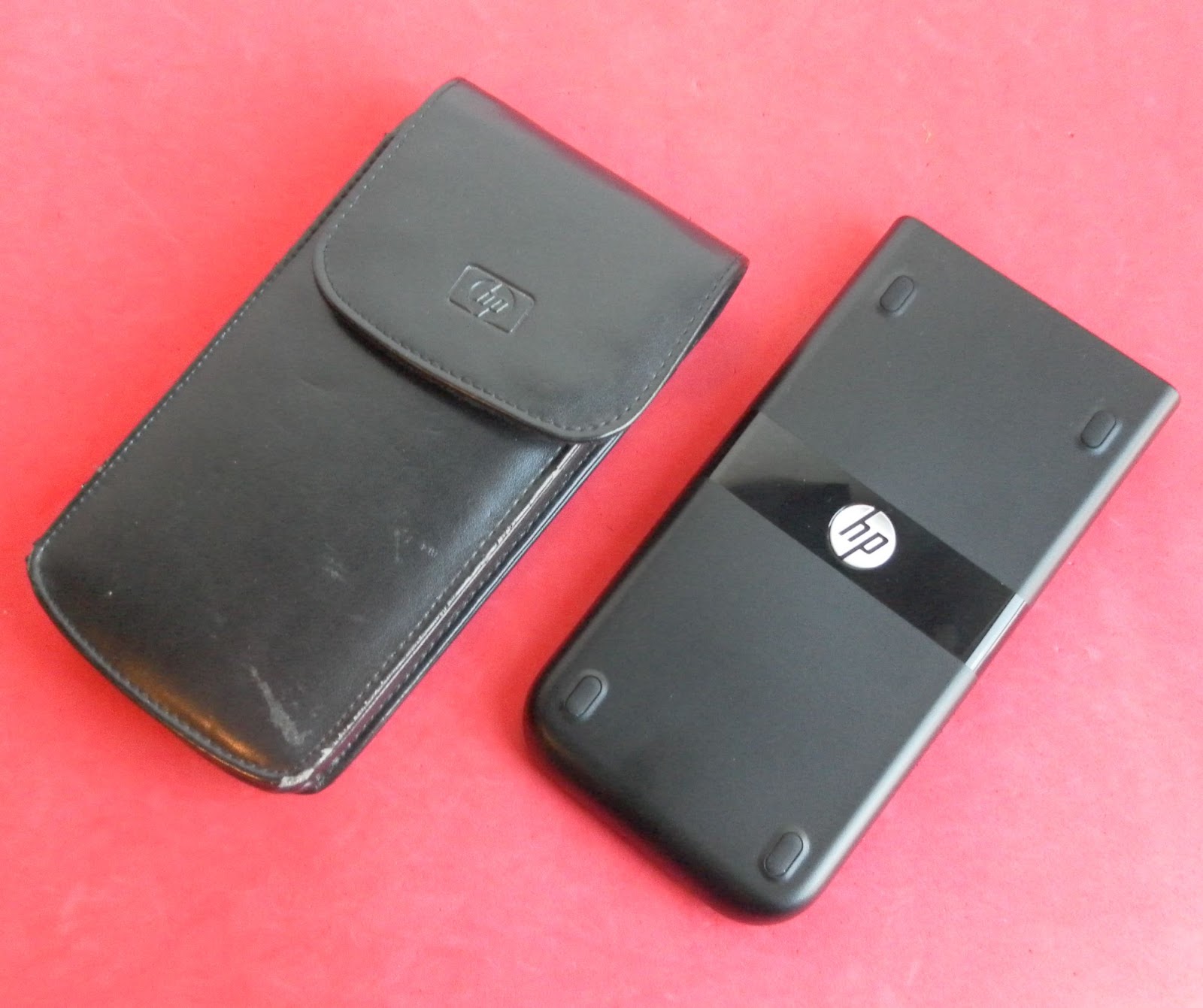

Since I acquired it new in 2013, it has been protected by a HP-50G pouch.
The Prime fits nicely in it.
[Image: HP_Prime_001.jpg] [Image: HP_Prime_002.jpg] [Image: HP_Prime_003.jpg]

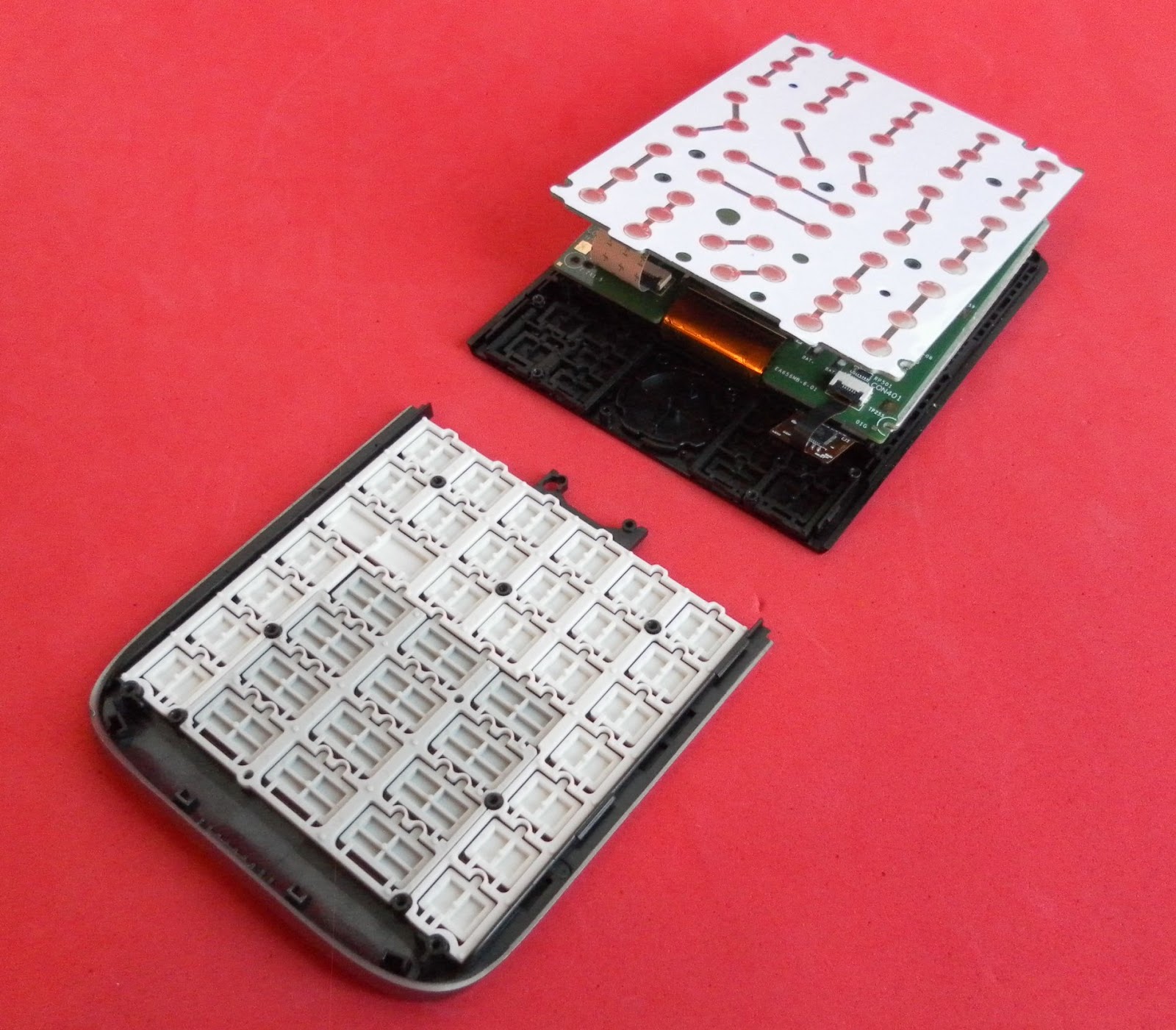

Then undid four screws to remove the back cover.
Used a plastic pry tool to help release the back cover lateral latches.

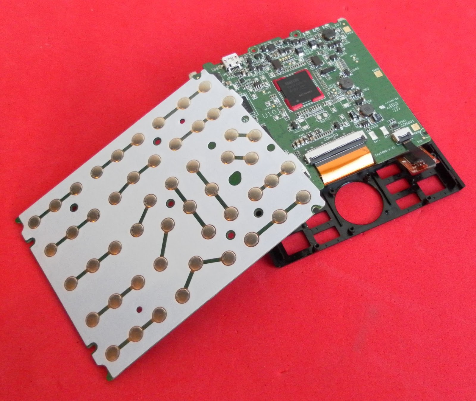

Undid ten small steel screws to release the keyboard PCB.

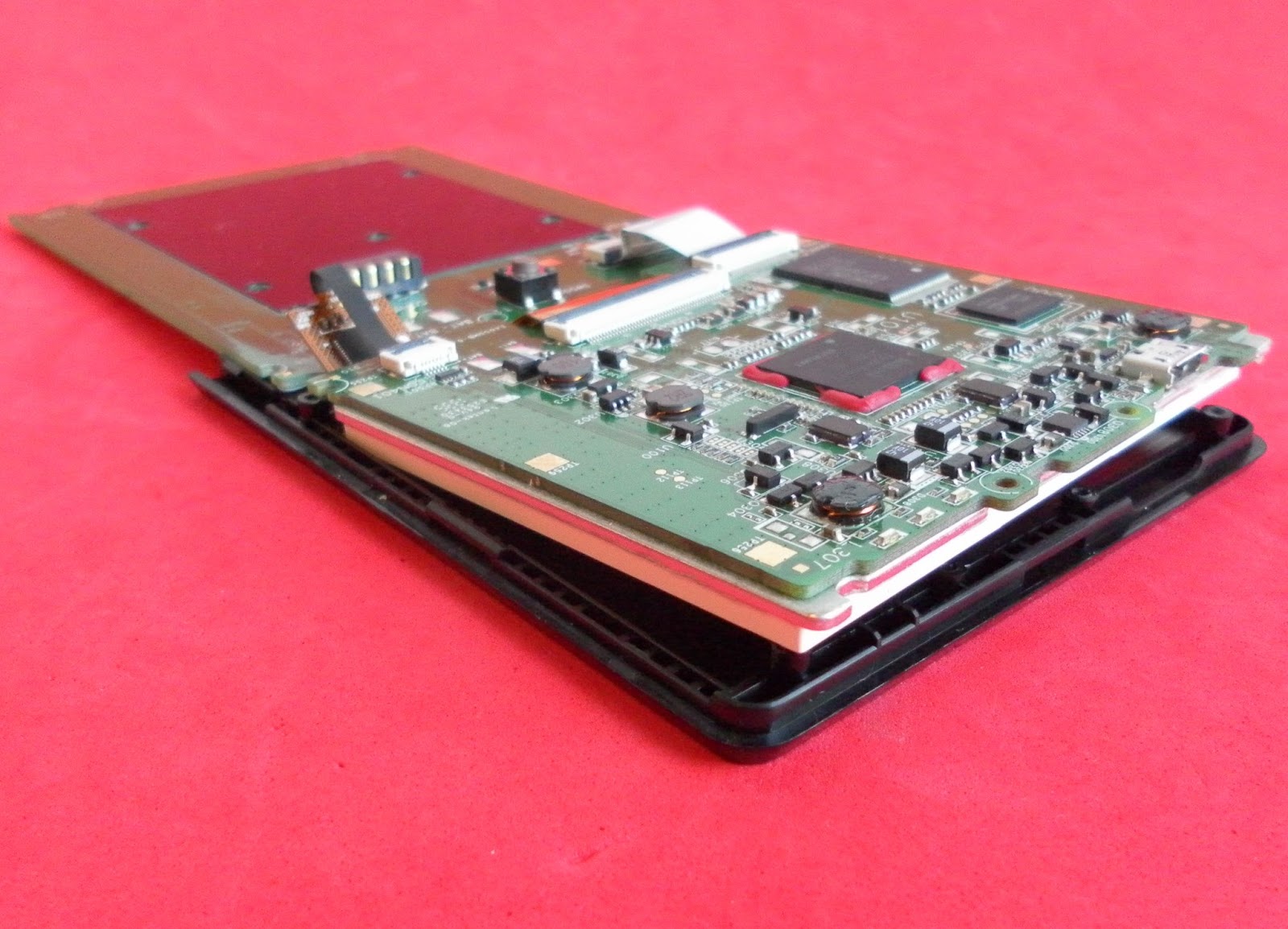

Undid four steel in black screws to release the main Processor/Display PCA.
[Image: HP_Prime_007.jpg] [Image: HP_Prime_009.jpg] [Image: HP_Prime_008.jpg]

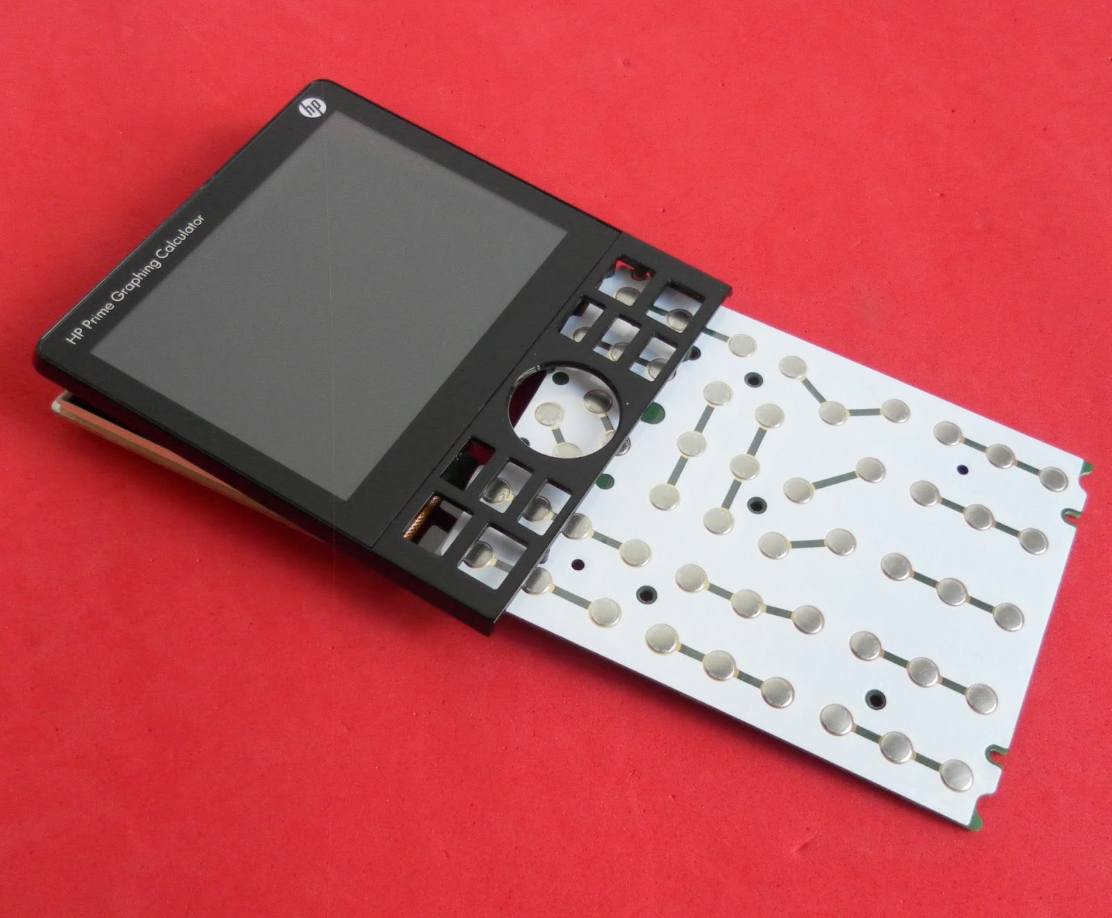

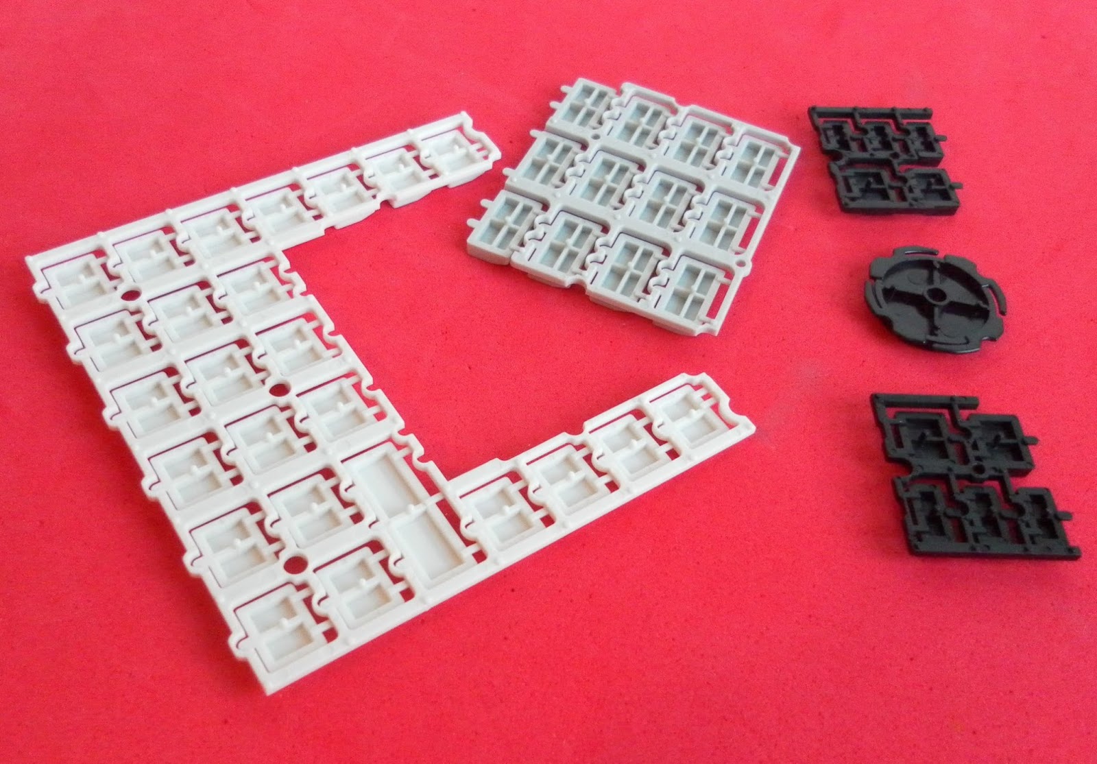

Rising the Keyboard PCB gives access to the keyboard membrane.
Removing the KB membrane exposes the keyboard frame assembly.
[Image: HP_Prime_010.jpg] [Image: HP_Prime_011.jpg] [Image: HP_Prime_012.jpg]

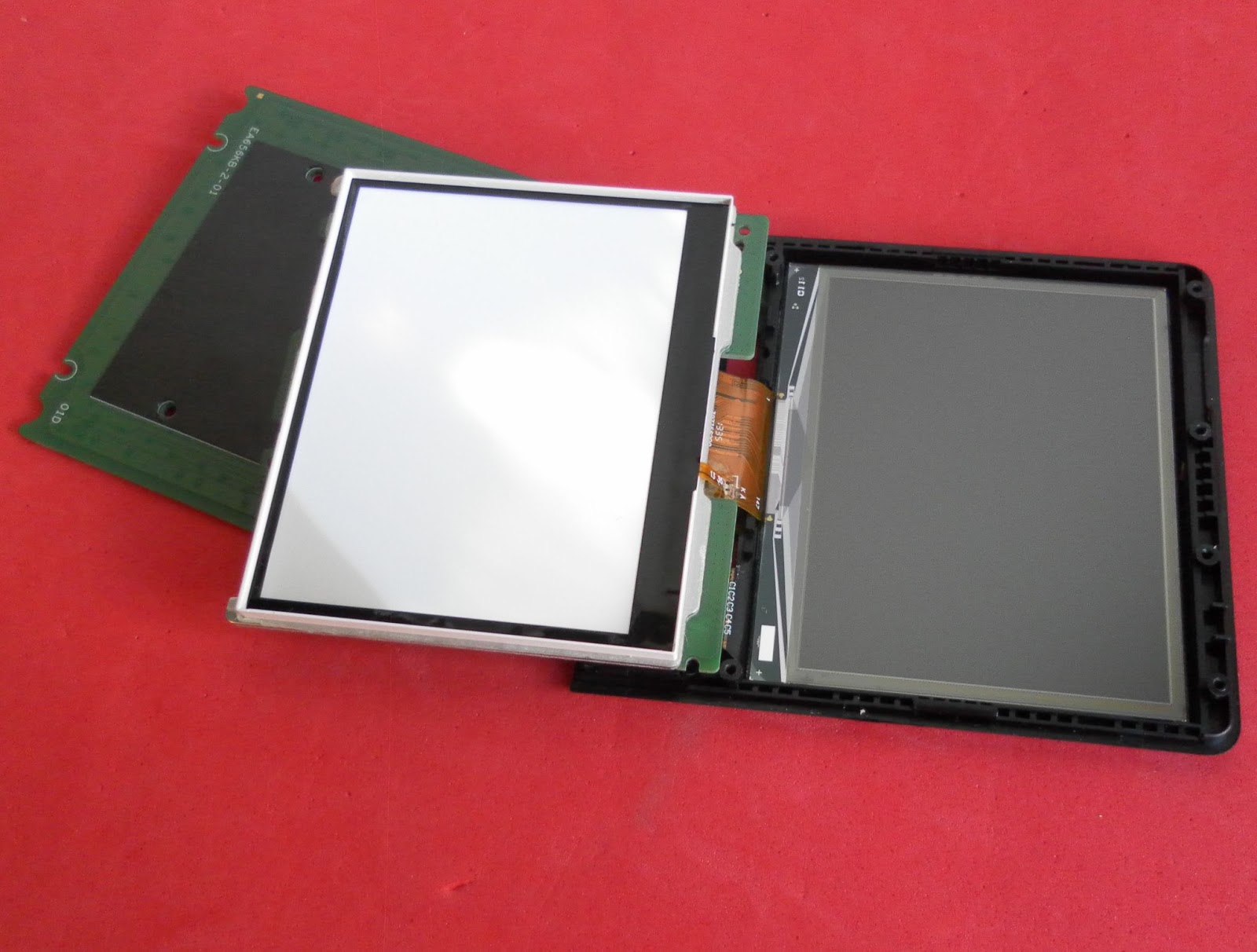

To remove the Processor/Display assembly and expose the touch pad assembly, used a plastic pry tool to lift the white display frame.
Some force is needed as the frame is glued (sticky glue).
The exam three color LED devices are visible on the down middle right side of the 1st picture.
[Image: HP_Prime_013.jpg] [Image: HP_Prime_014.jpg] [Image: HP_Prime_015.jpg]

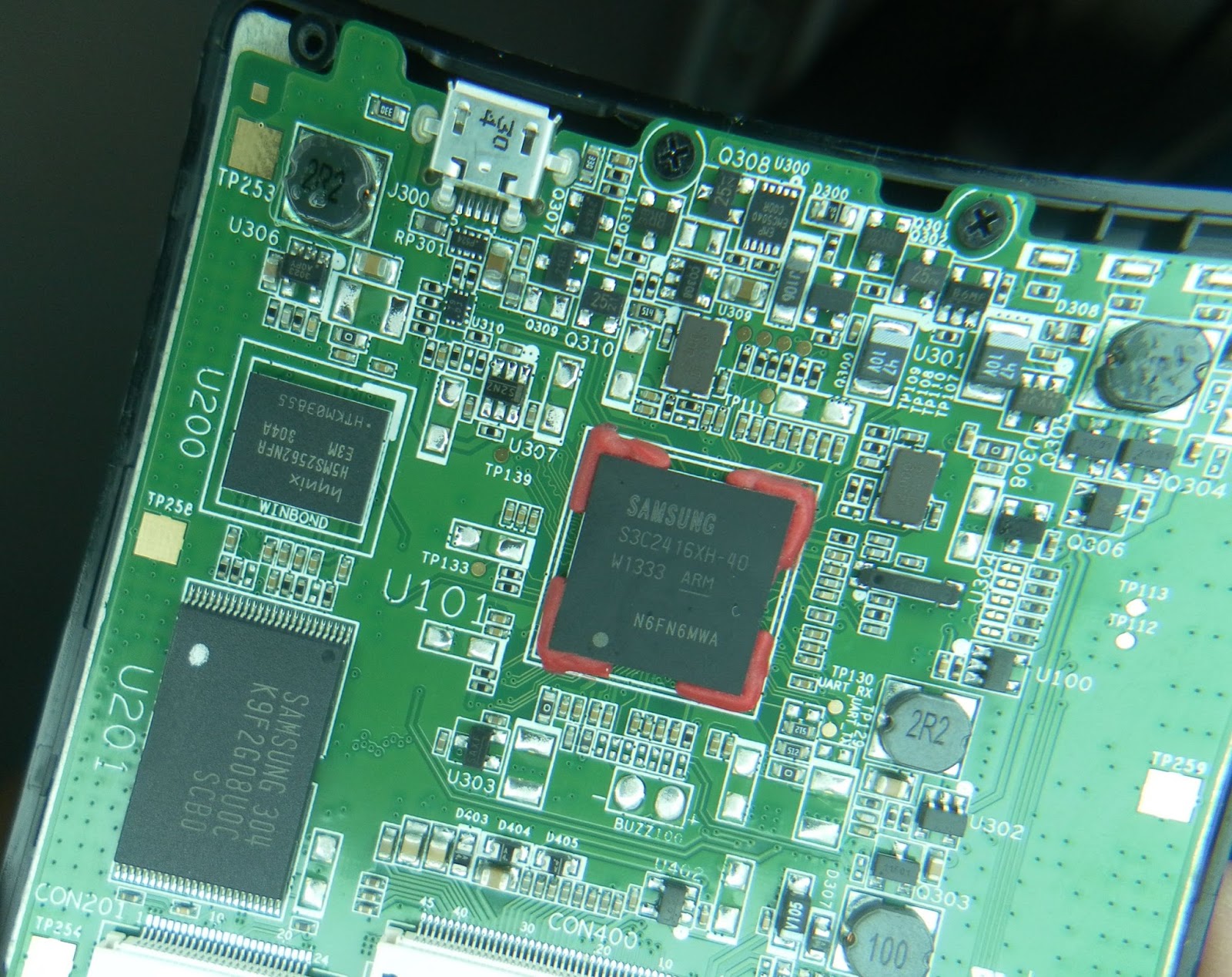

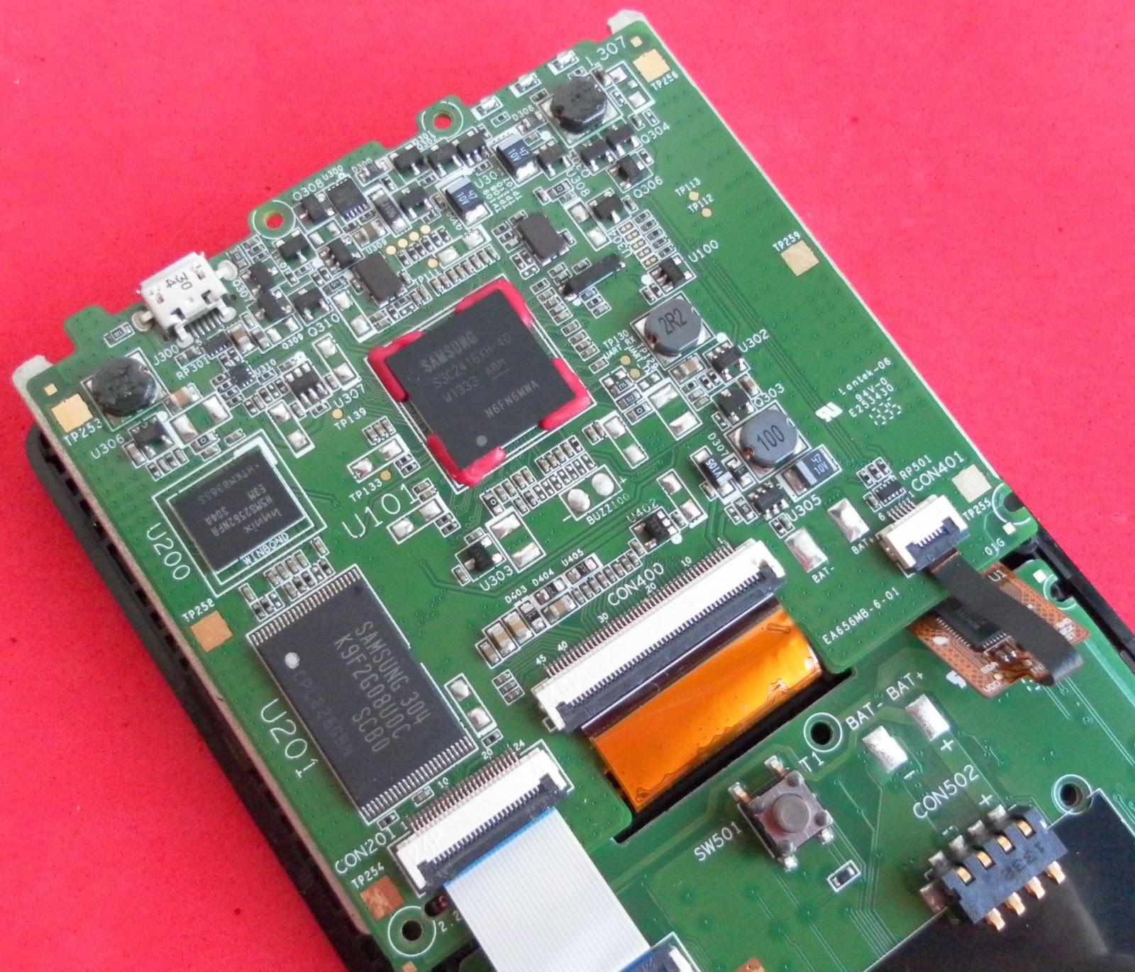

Main PCB. Some identified components:
- SAMSUNG S3C2416XH-40 SoC 400MHz ARM9 based processor.
- SAMSUNG K9F2G08U0C-SCB0 2Gbit 3.3Volt SLC Flash ROM memory (8-bit words).
- hynix H5MS2562NFR-E3M 256Mbit 1.8Volt DDR400 RAM memory (16-bit words).
By the way, Samsung has announced the EOL status for the SoC processor in the link above.
What will be the future of the HP Prime? A re-implantation of course!
[Image: HP_Prime_016.jpg] [Image: HP_Prime_017.jpg]

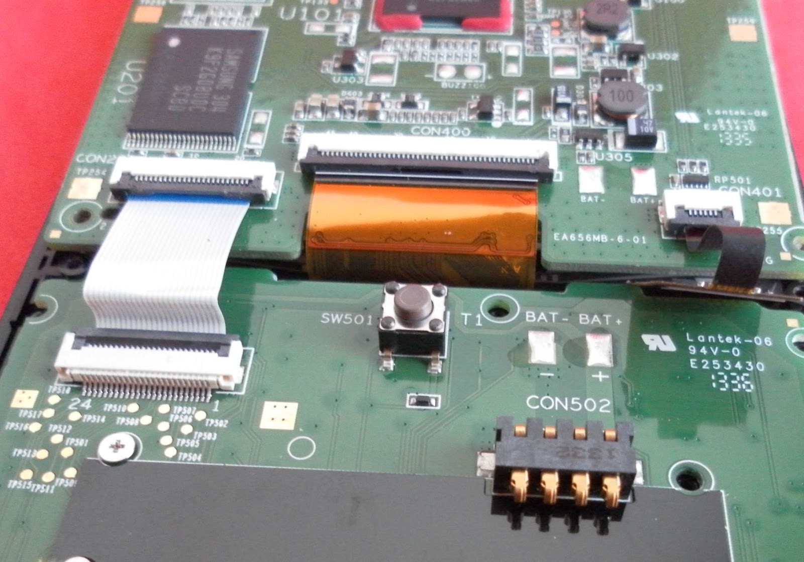

NOVATEK NT11002 1306-AD Touch panel controller, partially hidden by the flat cable.
This IC can be found in many Android devices as well.
[Image: HP_Prime_018_Novatek_NT11002.jpg]
Lifting the display assembly (in white color), reveals the touch screen input device (gray color).
[Image: HP_Prime_019.jpg]

Extra details from the Processor PCB.
A Buzzer reference in the PCB.
And a UART serial I/O as well.
[Image: HP_Prime_020.jpg] [Image: HP_Prime_021.jpg] [Image: HP_Prime_022.jpg]

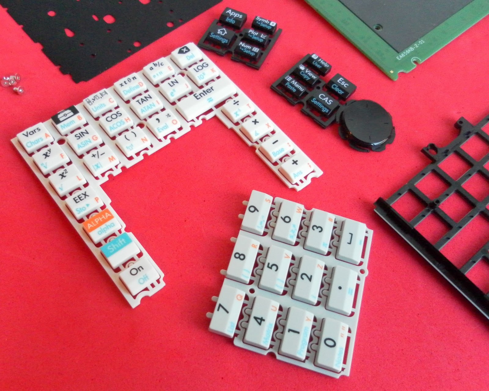

General parts view.
The Prime uses five key sets.
[Image: HP_Prime_023.jpg] [Image: HP_Prime_024.jpg] [Image: HP_Prime_025.jpg]

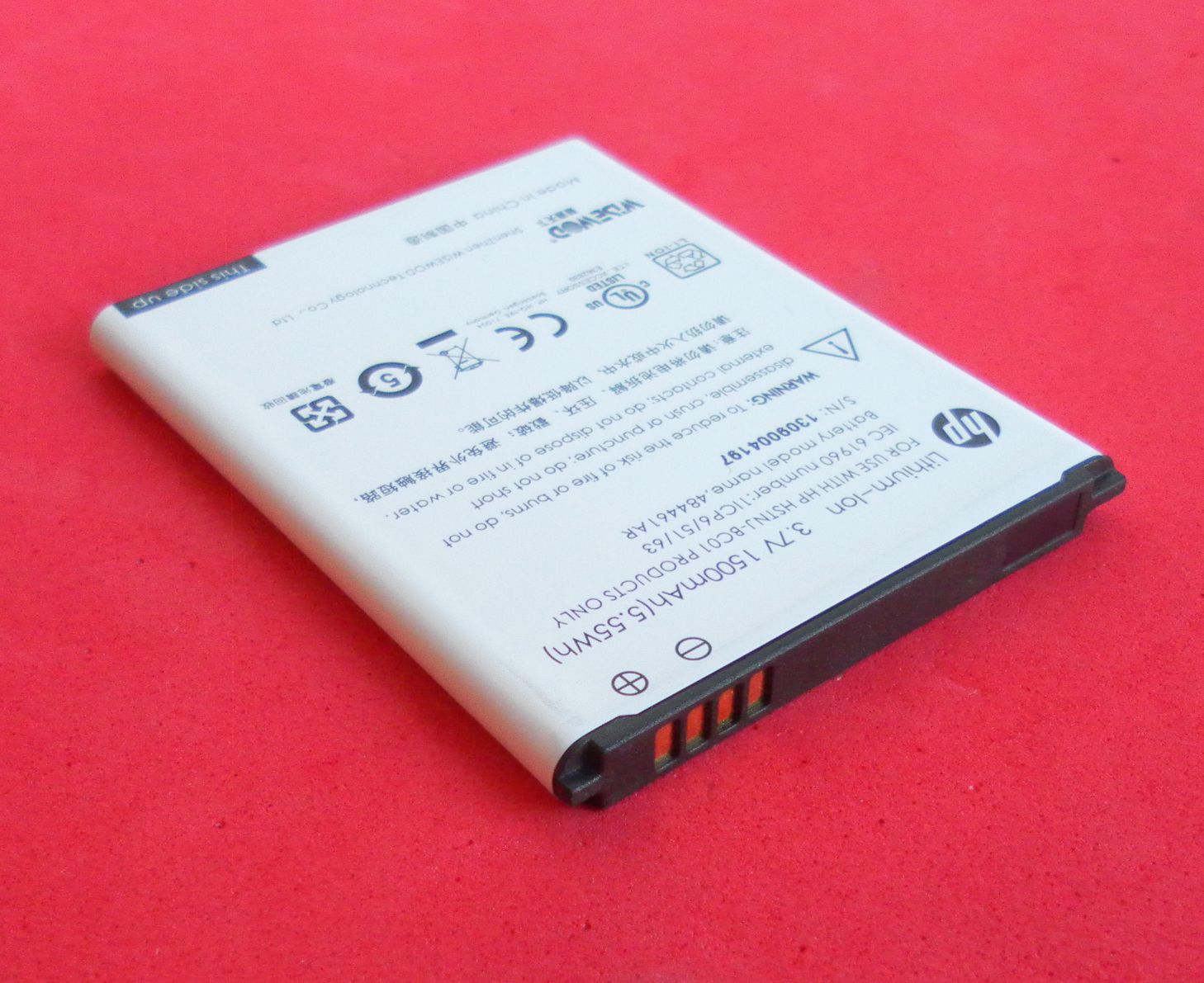

The battery is a pretty standard component, available in most retail shops under the Samsung cell phones accessories section, although with a different reference number but as long as the specifications are similar it should be fine.
Specs: Lithium-Ion 3.7V 1500mAh (5.55Wh)
Battery model: 484461AR
Note:
Meanwhile I have tested the Prime with a 3-years old battery from a Samsung Galaxy SIII I9300 and it worked fine.
Samsung Battery Specs: 3.8V Li-Ion 2100mAh (7.98Wh)
Samsung Battery model: EB-L1G6LLU
[Image: HP_Prime_027.jpg] [Image: HP_Prime_028.jpg]
