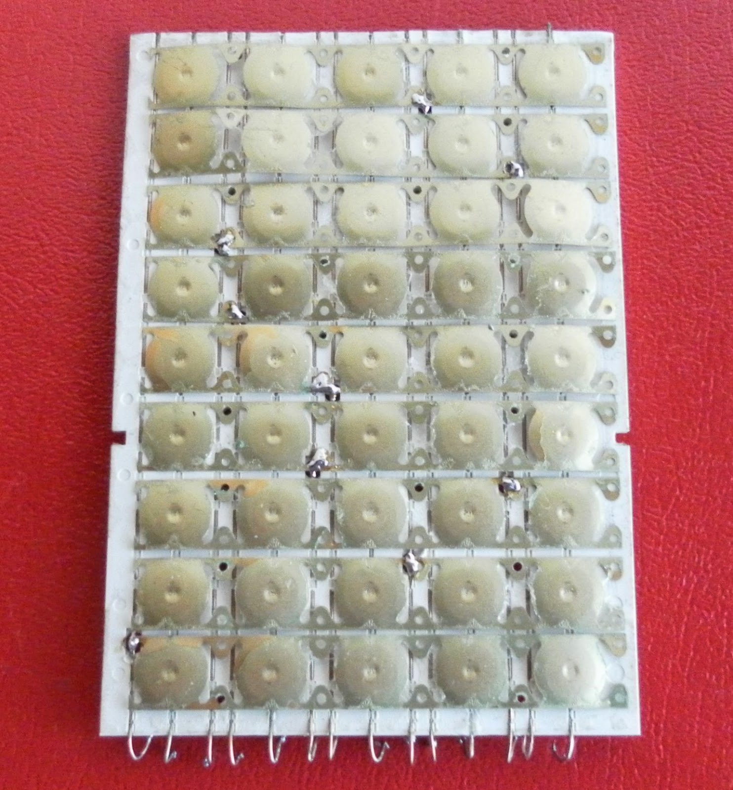

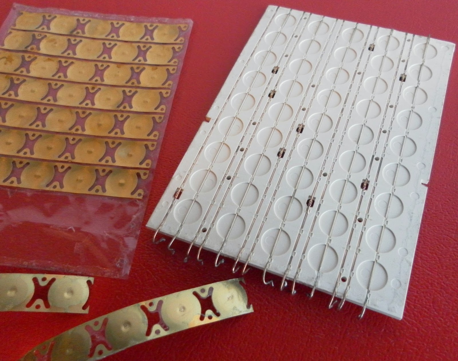

Separating the 9 dome rows from the keyboard assembly.
Once the keyboard is desoldered from the main board, the starting point is to remove the plastic cover from the keyboard base, where the 9 dome rows comes attached to it.
Some of the joints of the 9 rows were lose, creating the issues. Other joints were good, so some force is required to pull all the set apart from the keyboard base.
The plastic cover and the metal domes are resistant, though, so no damage was caused by this procedure.
Next step involved the separation of each one of the 9 dome rows from the plastic cover.

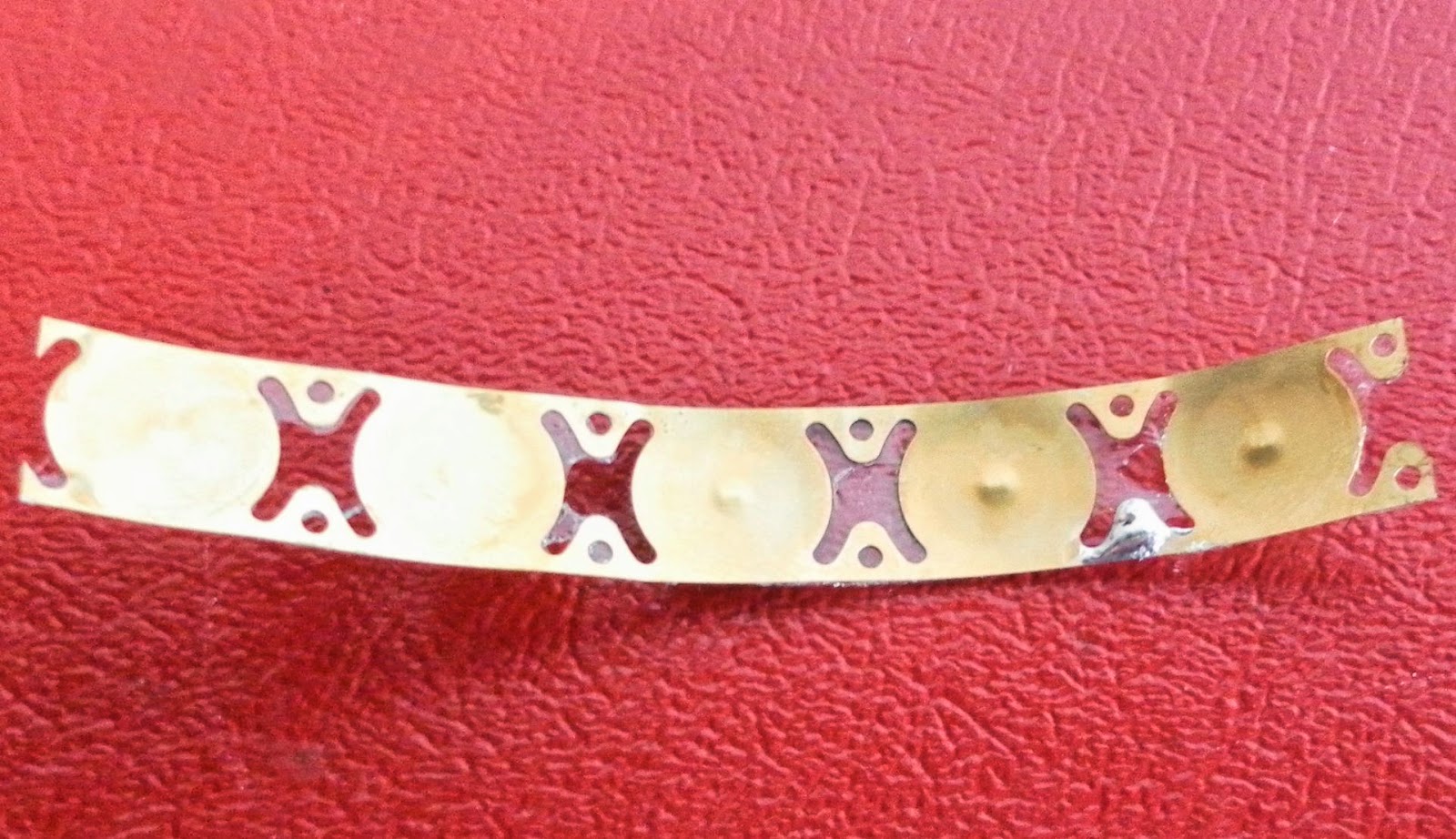

Prepare the 9 metal dome rows by tinning the joint points on the both sides.
Very delicate operation, as one needs to apply the least amount of solder as possible on the underneath side to tin just a small area. Otherwise it can short circuit the 5 columns wires as well.
Tinning the underneath side first:
[Image: Texas_TI_5X_Keyboard_Repair_006.jpg]
Tinning the upper side of the dome row allows to do a fast and precise soldering operation when putting it back into the keyboard base. Before tinning it, it is necessary to remove a small portion of the strong glue layer that covers the entire dome row.
Tinning the upper side next:
[Image: Texas_TI_5X_Keyboard_Repair_007.jpg]

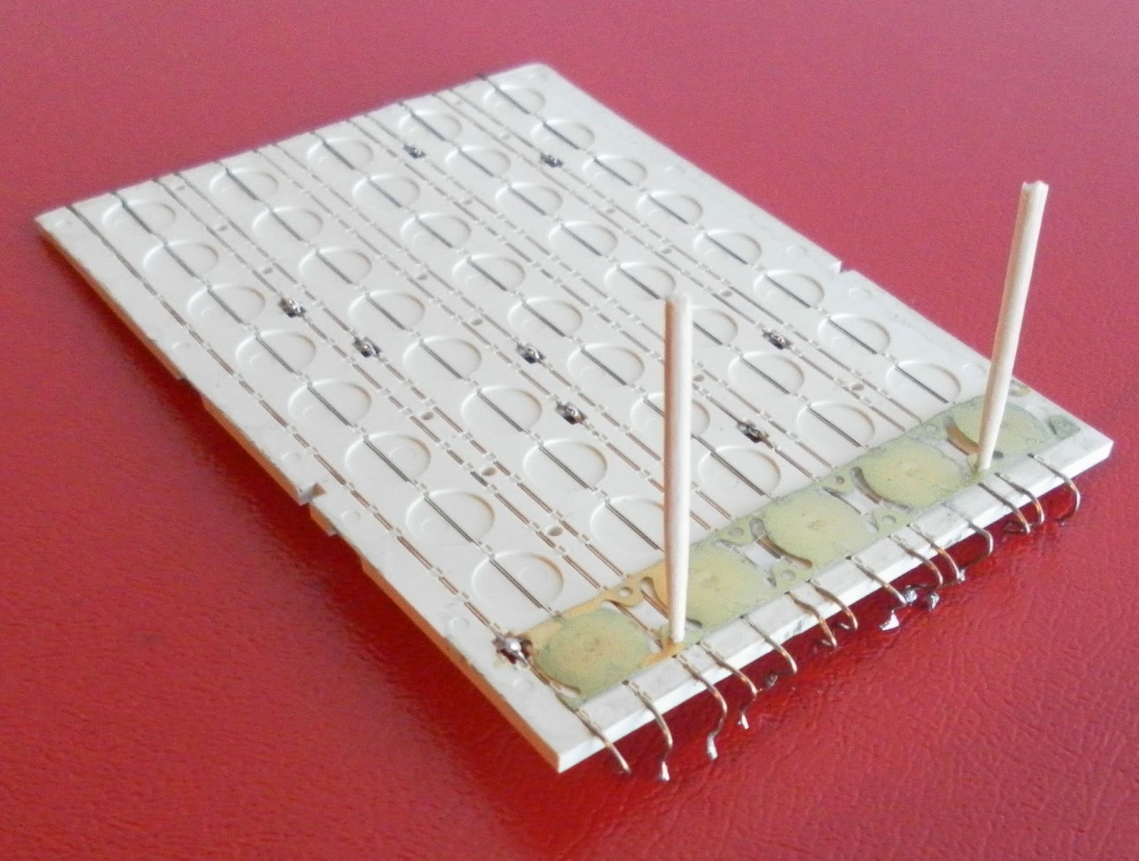

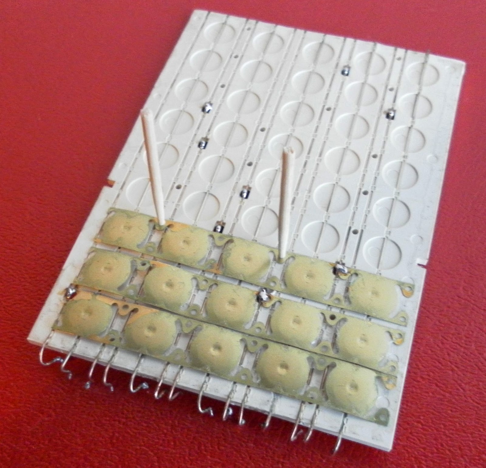

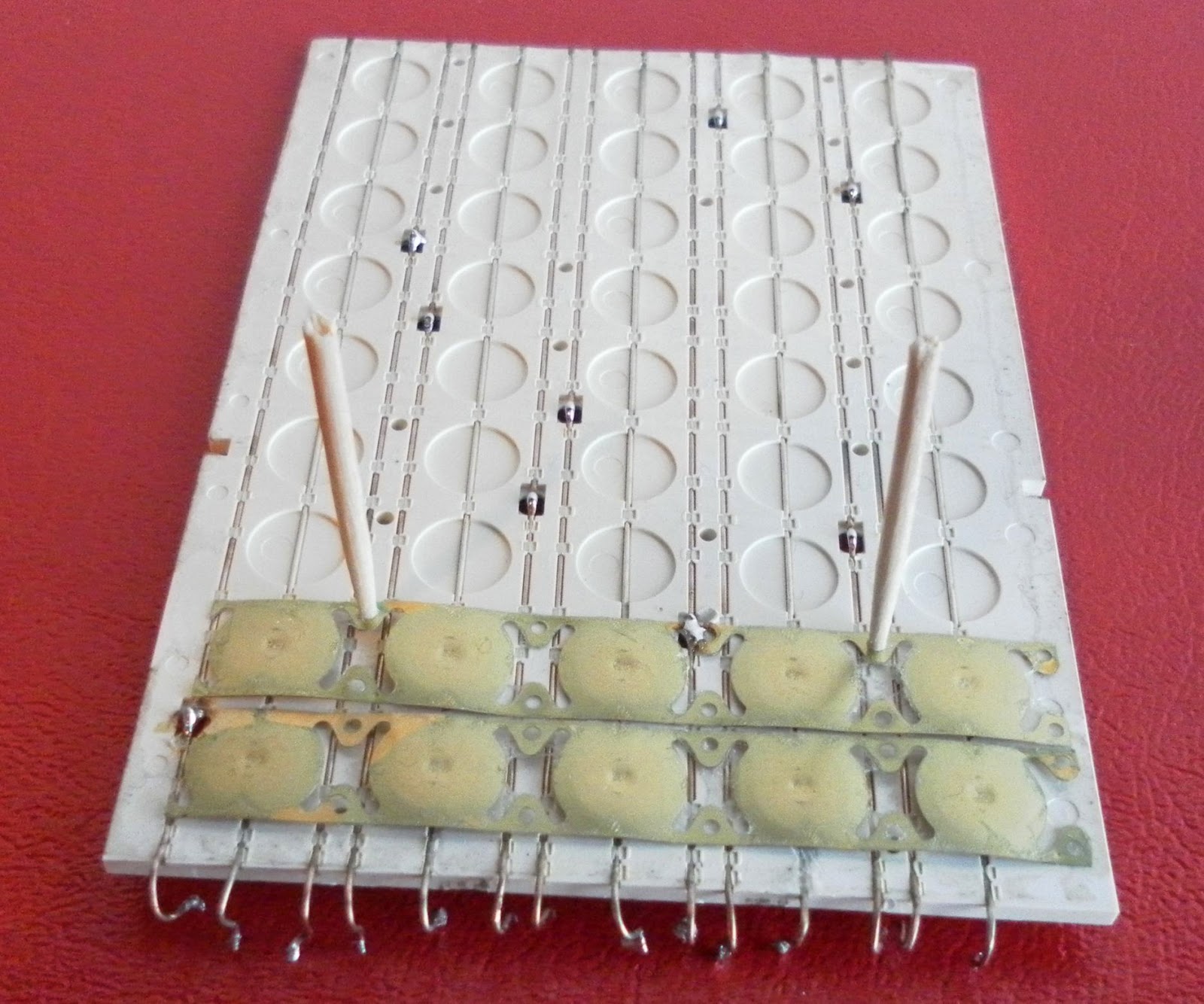

Reassemble the 9 dome rows
Put back the 9 dome rows by soldering them to the keyboard base at the 9 rows joint points.
I used tooth ticks as dome's alignment guides by inserting them into the two existing small holes in each one of the 9 rows.
[Image: Texas_TI_5X_Keyboard_Repair_008.jpg] [Image: Texas_TI_5X_Keyboard_Repair_009.jpg] [Image: Texas_TI_5X_Keyboard_Repair_010.jpg]

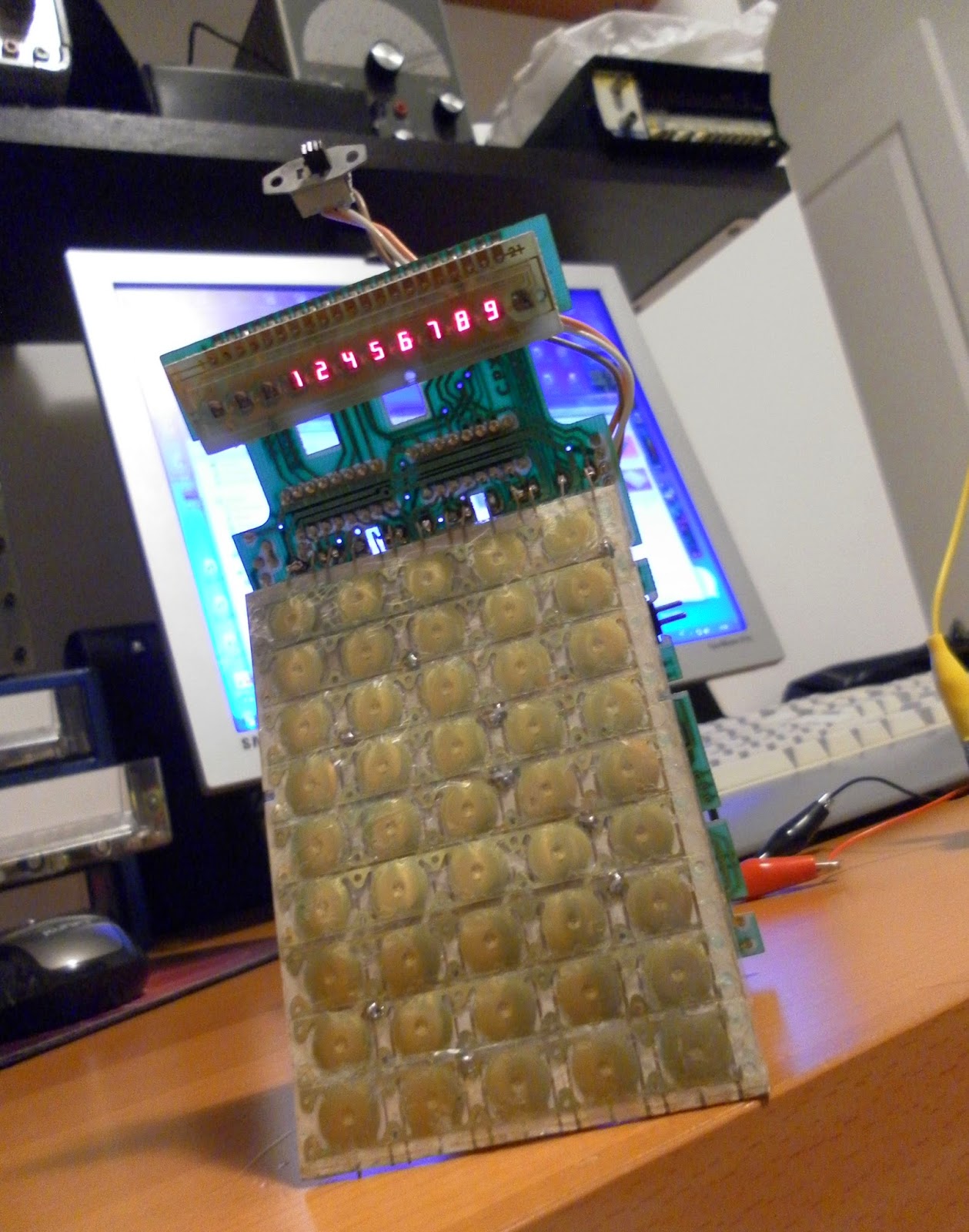

After soldering back the keyboard to the calculator main board, it was time for testing.
Power ON, and CLR and typed the sequence "123456789" without looking to the display.
Result: No duplicated entries and no missing keys.
EDIT: I did miss one key entry above. So, bounce is gone but typing too fast can still miss one key register.
It is too soon to say that the bounce issues are gone for good.
But at least it didn't fail so far.
[Image: Texas_TI_5X_Keyboard_Repair_013.jpg] [Image: Texas_TI_5X_Keyboard_Repair_014.jpg]

But I did miss one key to register entry above.
So, bounce is gone but typing too fast can still miss key entries.
I have yet to assemble it and do the final test in the proper way.
