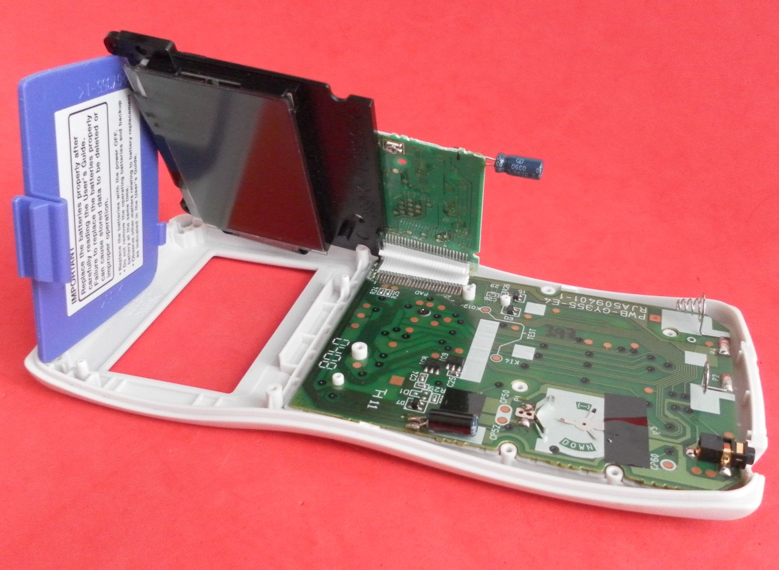

General parts view.
[Image: casio_cfx-9850gplus_we_001.jpg]

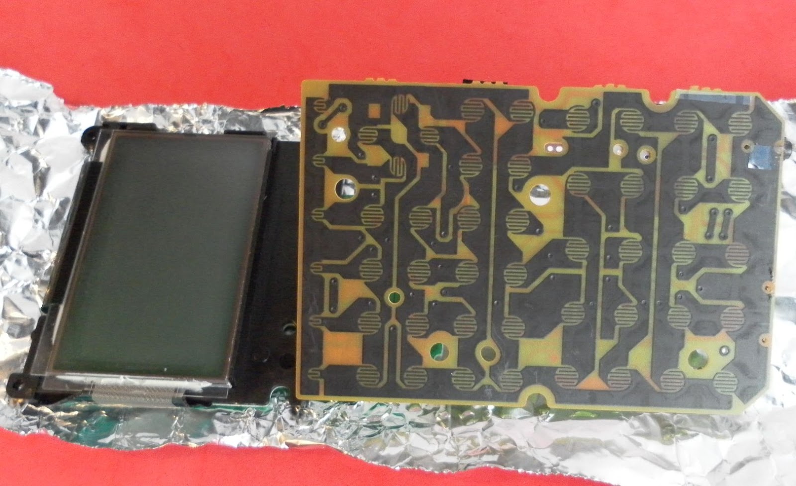

Processor PCA and Keyboard/Display PCA.
[Image: casio_cfx-9850gplus_we_002.jpg] [Image: casio_cfx-9850gplus_we_003.jpg]
Contrast preset potentiometer underneath the Processor PCA.
[Image: casio_cfx-9850gplus_we_004.jpg] [Image: casio_cfx-9850gplus_we_006.jpg]

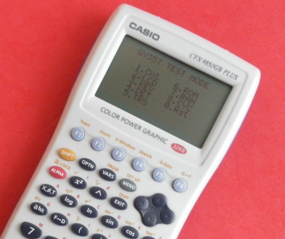

Running again the self test by pressing F6 + a b/c + AC/ON.
This calculator shows this model code: GY357
[Image: casio_cfx-9850gplus_we_015.jpg]
