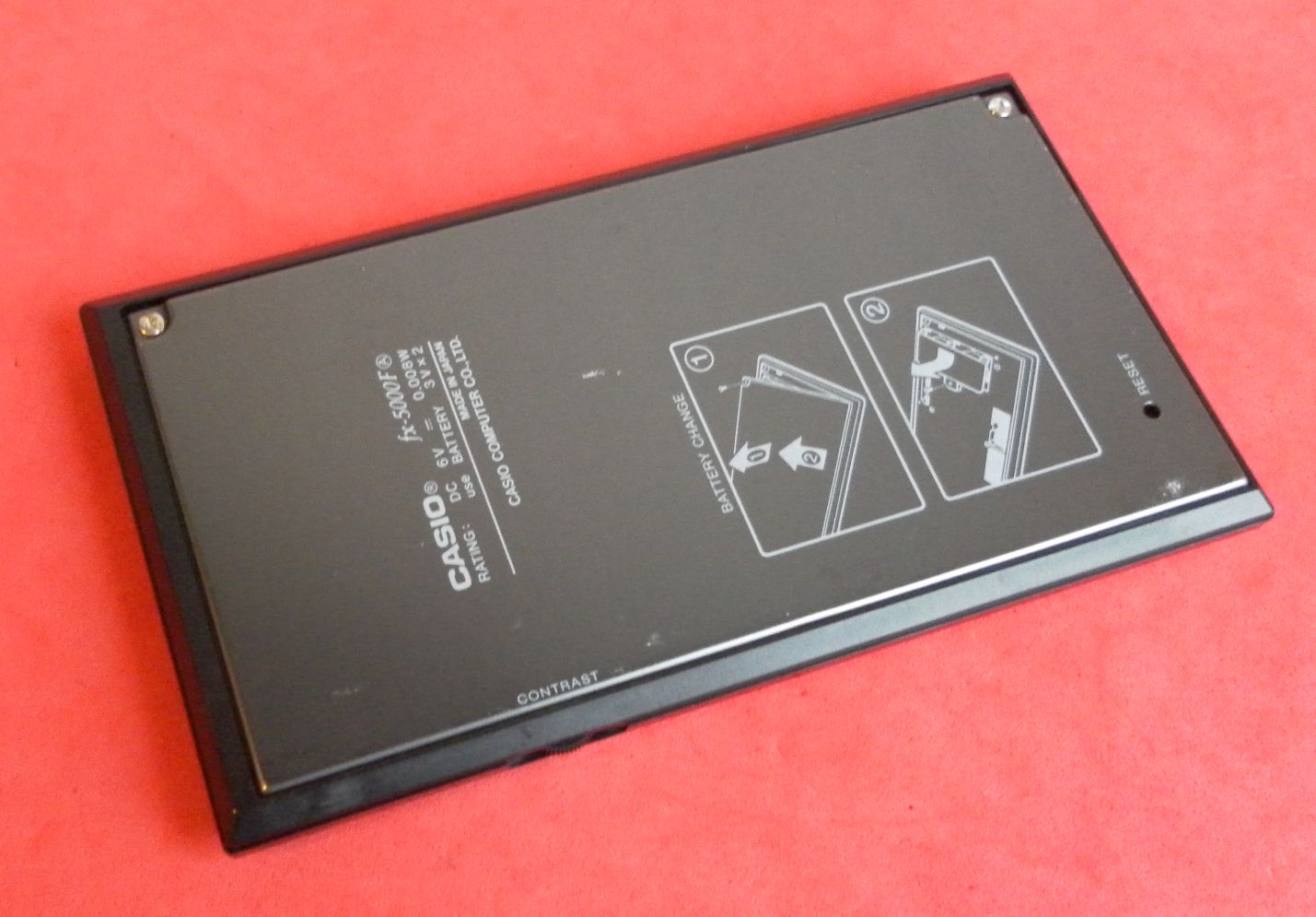

[Image: casio_fx-5000F_023.jpg] [Image: casio_fx-5000F_022.jpg]
With 128 stored formulas ready to be used, this model was very popular among students and professionals at the time, and it is probably one of the best pocket Casio calculators from the late 80's.
One of my beauties was made in 1991 according to some internal component date codes.

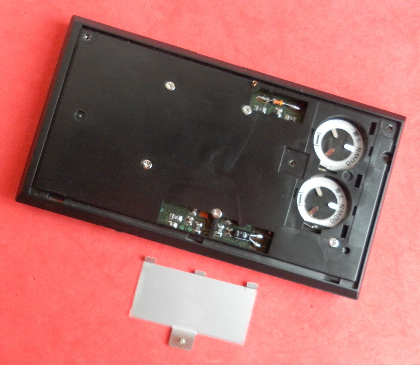

Tear down
to inspect the inside and have a cleaning.
2 x CR2032 batteries for a total of 6Volt are required to power this unit.
[Image: casio_fx-5000F_014.jpg] [Image: casio_fx-5000F_013.jpg]

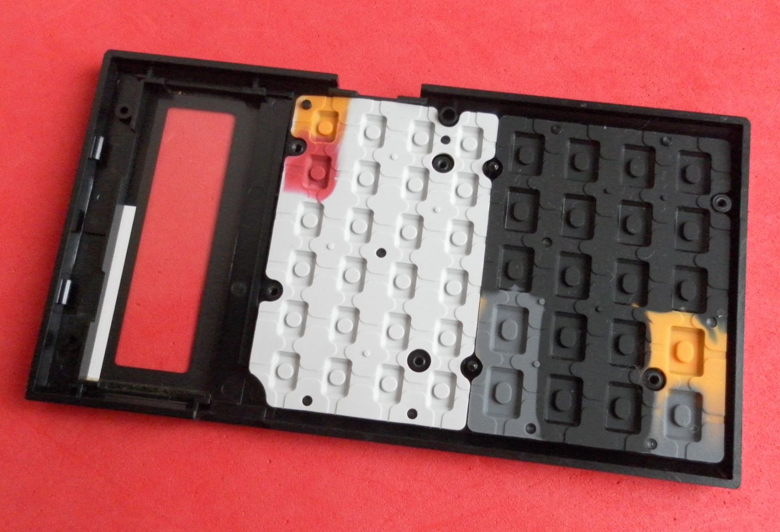

Keyboard membrane and keyboard rubber keys side view.
[Image: Casio_fx-5000F_007.jpg] [Image: Casio_fx-5000F_008.jpg]

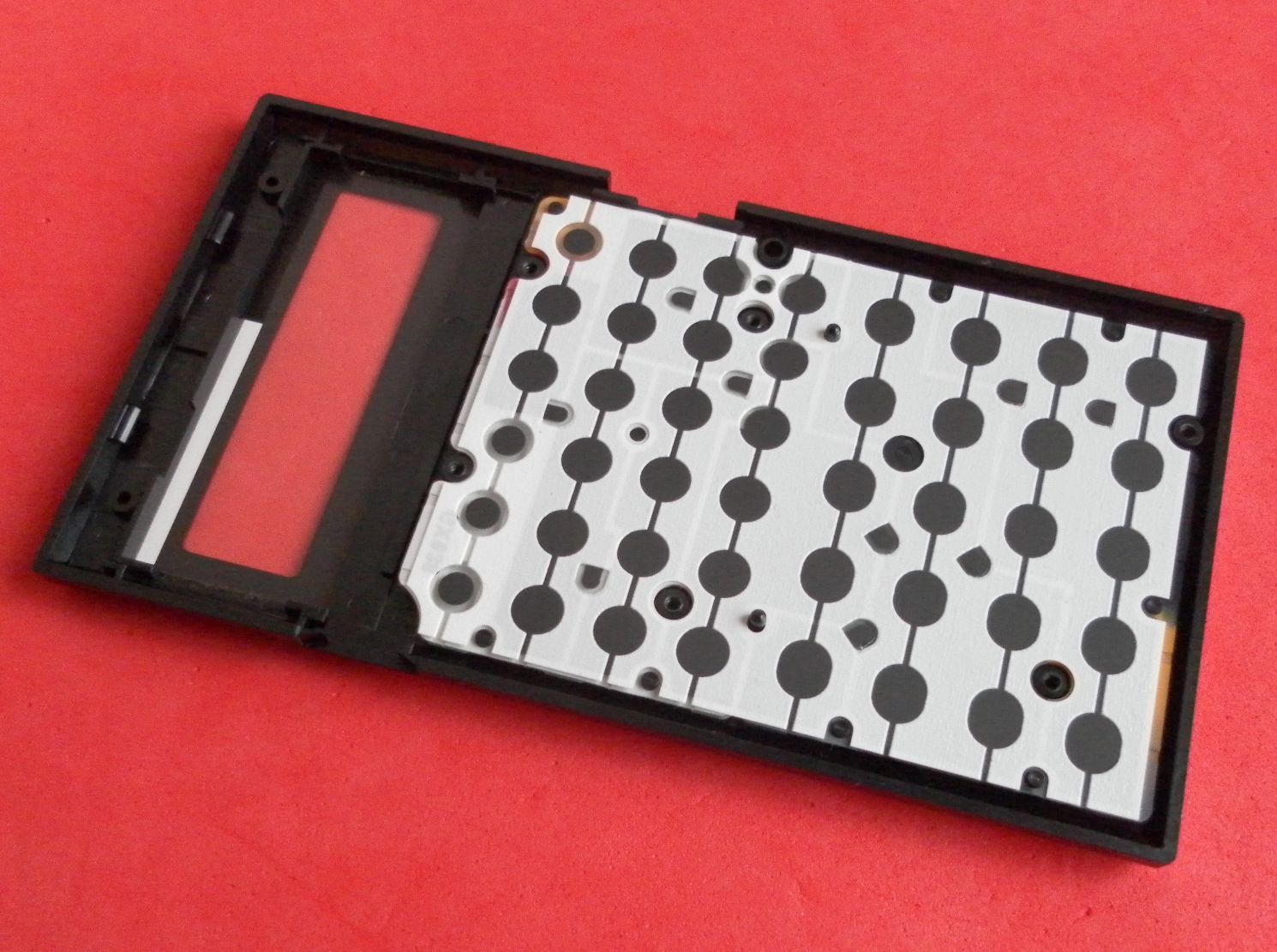

Keyboard membrane over the rubber keyboard, PCA side view.
Rubber keyboard painted keys.
[Image: Casio_fx-5000F_006.jpg] [Image: Casio_fx-5000F_005.jpg]

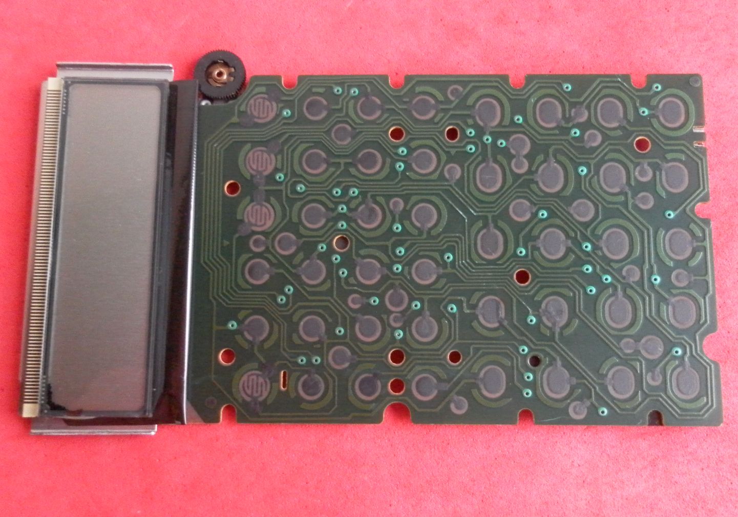

The Printed Circuit Assembly keyboard side, after removing the keyboard key's foil.
[Image: Casio_fx-5000F_003.jpg]

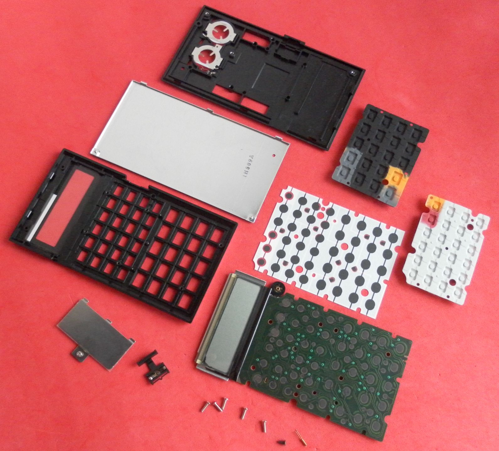

General parts view.
[Image: Casio_fx-5000F_002.jpg] [Image: Casio_fx-5000F_001.jpg]
