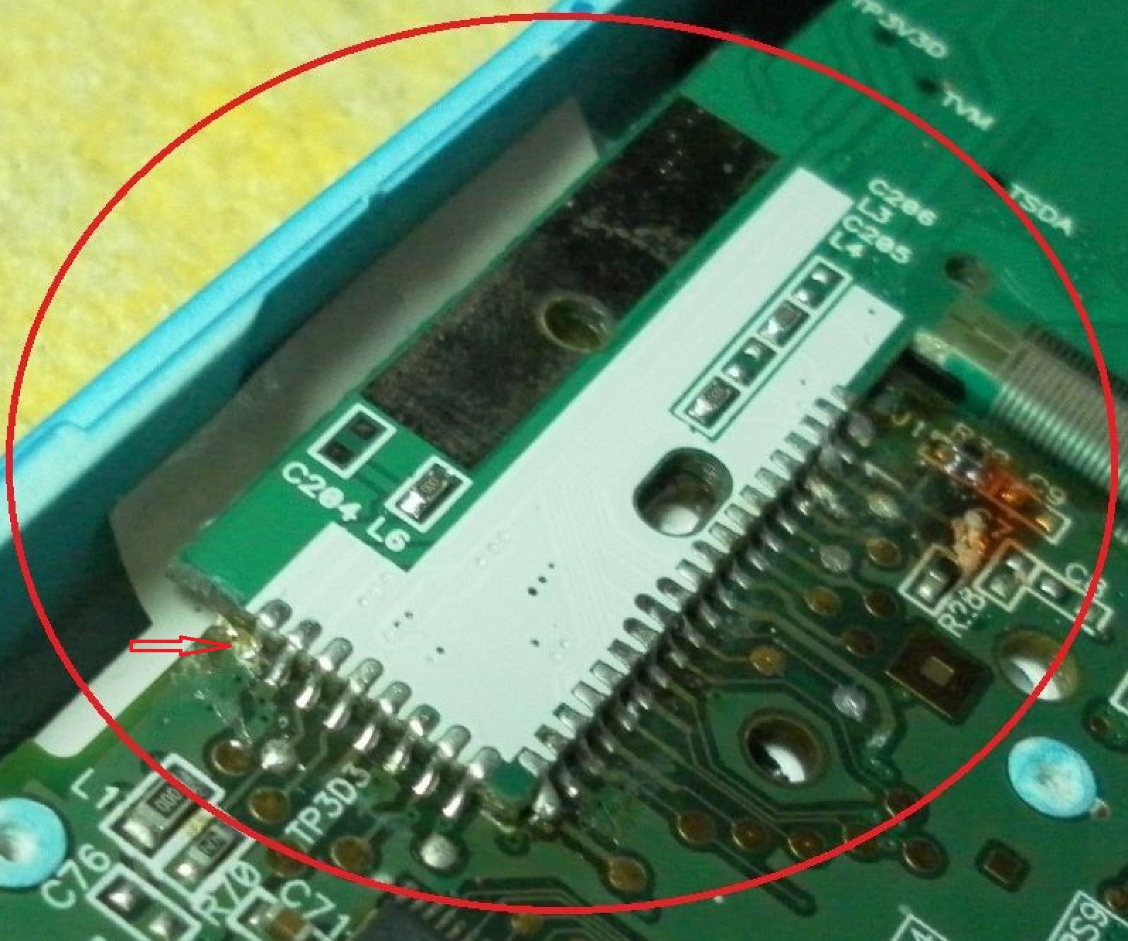

[Image: HP-50G_Blue_Repair_004.jpg]
The two PCB components quality is good and up to the current standards in automated manufacture.
However, the assembling of the PCB's really have space for improvement...
The solder joints were left uncleaned of the solder flux/resin, some had that look of badly soldered joints, most probably due to insufficient applied heat to melt the solder with the leads.
Obviously this was a manual assemblage using man power working under pressure with not enough time left to do a better job.
So, because the display failure was caused by a sudden deceleration, and considering the lousy aspect of the solder joints, I used a ohmmeter to check it.
And yes, one of the solder joints was simply broken.
Now, this solder joint was a time bomb waiting to explode any time. The calculator accident just triggered it.
[Image: HP-50G_Blue_Repair_005.jpg] [Image: HP-50G_Blue_Repair_006.jpg]
So, I was lucky this time.
Took me 5 minutes to open the calculator. Another 10 minutes to find the fault. And 5 minutes to fix it.
I have used a low power solder iron to fix the joint, then used Isopropyl Alcohol to clean the joints.
After inserting a set of batteries, the display was back to life!

IMHO, the 50G has got two PCA's (the processor/keyboard and the display), and both were produced in an automated assembly line due to the components technology in use (SMD insertion is much faster done by a robot than by a human).
However the machine have several more components that are very old style (from the pre-SMD era), and these are manually soldered and routed and taped (battery holder, memory backup capacitor, power supply wires from the two battery holders to the PCA, the buzzer job clearly a manual process too and finished with black tape to cover the buzzer wires solder joints to void a short-circuit on the PCA).
The connection of the two PCA's could be automated, yes, but it was not in my unit. And I can guarantee is was untouched before me, because the RF shield was not broken. So I know this was a standard manufacturing procedure, at least for the batch where my unit came from.
Not that this is a problem by itself. A properly trained operator should be able to solder the interconnect 28 leads in less than 5 minutes including the solder flux removal.
One operator could make at least 80 assemblies per day without working too much.
If you need 1000 per day done, then hire 13 operators for this job. Nothing too much for a manufacturing plant.
Then the installation of the two PCA's inside the case:
- The two PCA's needs to be wrapped with the RF shield, temporally fixed with black tape, and then set on the final position in the upper case where a combination of screws and rivets are used to fix it, and this is a mix of manual processes and automation.
Finally the wiring and installation of the power supply components are clearly a manual procedure, using hard-wiring techniques, and taping the wires to fix them.
I don't see a problem manufacturing thousands of units per week using a mix of robotics and man power. This is what we have been doing along the years, not only in electronic devices but also in other areas like in automobile industry for example.
(01-27-2018 11:21 PM)rprosperi Wrote:  Does it seem feasible that the broken solder joint (broken upon the fall) was a result of poor assembly, or would a similar fall break such a joint if completed properly?
This was a manufacturing defect (cold solder joint), and the fall just triggered the open circuit. The problem would happen even without a fall, given enough time of normal usage (and normal use involves vibration, small "falls" when people put the machine on a desk resulting in some energy that needs to be absorbed as well).
We are talking about a solder joint that, if properly done, is very robust by nature.
The fall could have damaged the LCD itself (it was my fear, really), but that didn't happen because the plastic case is very well designed and built and have absorbed most of the energy.
