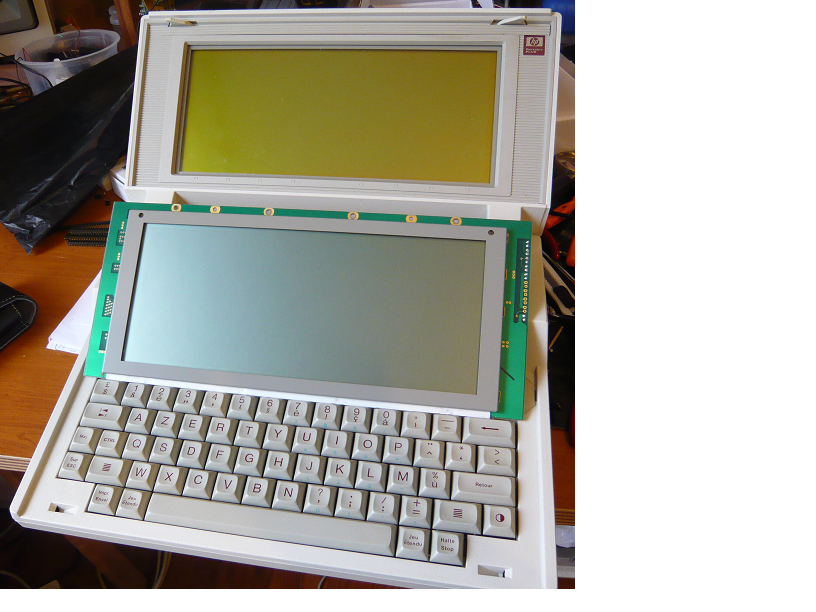

The screen of my Portable Plus was upgraded at the time, and I still have the old one.
The updated one is rather yellow, whereas the old one was rather grey-green.
Anyway, the contrast has always been poor... but I like this machine.
Here are the two displays side by side:
[Image: screenhp110.png]

Thanks, Jean-Francois. The difference is more than I expected.
