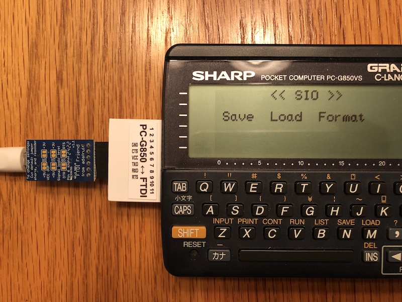

I have built the connection using an older FTDI 232R USB-to-Serial connector, from Parallax robotics kit. Everything looks fine when I do TEXT/SIO/LOAD on the Sharp - it shows RECEIVING and busy indicator.
As soon as I start Tera Term or Putty though, connected to the port (proper settings including hardware handshake), I get I/O DEVICE ERROR on the Sharp...

SUCCESS!
A new FTDI adapter did the trick! Now I just need to make it into a permanent cable with the 10k resistor, and I am in business.

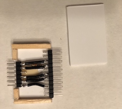

The adapter box
I made mine with polystyrene, which was a lot simpler than 3D printing. I also cut two matches (the ones that come in a larger box that are thicker and longer than the standard matches) which I superglued to form the edges of the box. The diameter of the matches are exactly the right width to form the box: the connectors fit perfectly. Then a few dabs of hot glue to close the box.
[Image: FTDI-adapter-1.jpg]

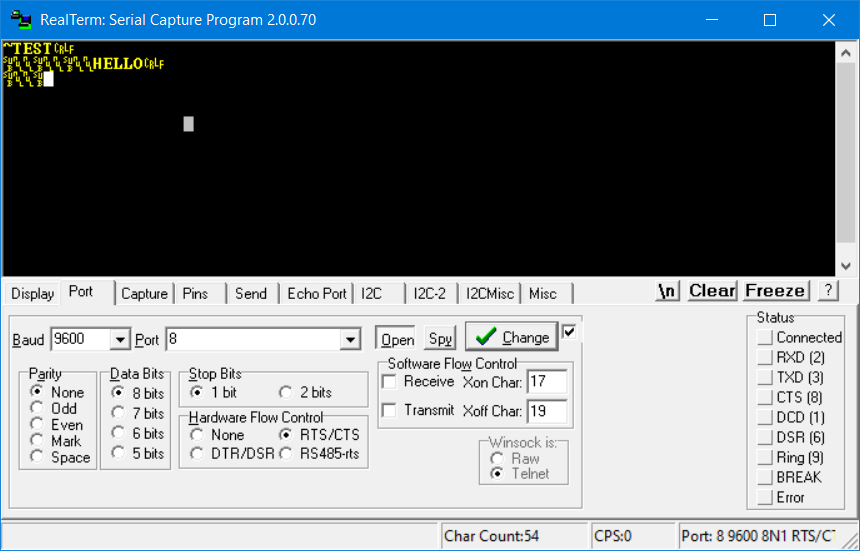

Update
Further down the rabbit hole...
It seemed crazy to me why the FTDI driver didn't respect the CTS input from the PC-G850 on my MacOS M1 machine as I stated in the checklist. I tested with an Adafruit FTDI Friend and a FTDI USB cable from the FTDI manufacturer. The problem is a bug in the latest FTDI CP210x/VCP driver 1.5.0 for MacOS 12, because testing on Windows with RealTerm shows that the CTS input levels are correct and in fact respected when sending to the PC-G850, as shown in the images below.
CTS is low when PC-G850 not ready to receive and sending to the PC-850 is indeed blocked:
[Image: RT-1.PNG]
CTS is high when the PC-G850 ready to receive, e.g. TEXT Sio Load:
[Image: RT-2.PNG]
Strange behavior with the FTDI 5V adapter however remains, even on Windows, whereas the FTDI 3.3V adapter is fine. It is not possible to send from the PC-G850 to the PC with the FTDI 5V adapter when DTR is set. It should be cleared first manually, before the PC accepts data from the PC-G850:
[Image: RT-3.PNG]
For this reason to fiddle with DTR, it's not practical to use FTDI 5V, but I can't put my finger on the reason why this is any different from the FTDI 3.3V behavior that works fine.
To conclude, the FTDI driver for a Windows machine and Mac Intel machine work. However, the FTDI driver 1.5.0 for MacOS fails to respect FTDI CTS input on a Mac M1. This is totally unexpected and not acceptable!
