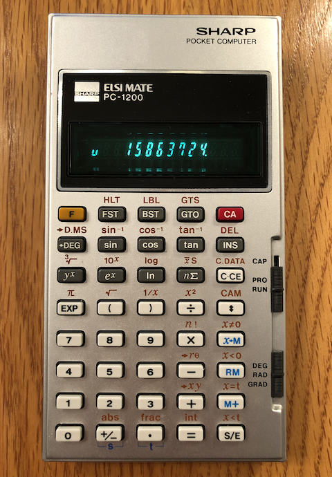

Press CA to run the program from the start. Enter n, for example enter 8 to run the 8-queens benchmark, then press S/E
Solution
In 12 minutes and 42 seconds the display shows the first solution u  15863724.
[Image: PC-1200.png]
where u means user input (the HLT operation). Pressing S/E calculates the next solution, and so on, until the calculator returns -1 without requesting further user input.
The running time for all solutions of the 8-queens problem should be about 4 hours, which is rough estimation based on running all solutions on the Sharp PC-G850 using the same "chopping block" algorithm (in BASIC) and by using the time of the first solution to scale. It turns out that the Sharp PC-1200 is only 10 times slower than the PC-G850 BASIC for this same algorithm (the PC-G850 Z80 CPU runs at 8MHz.) The PC-1200 is a fast keystroke programmable, especially for the 70s.
