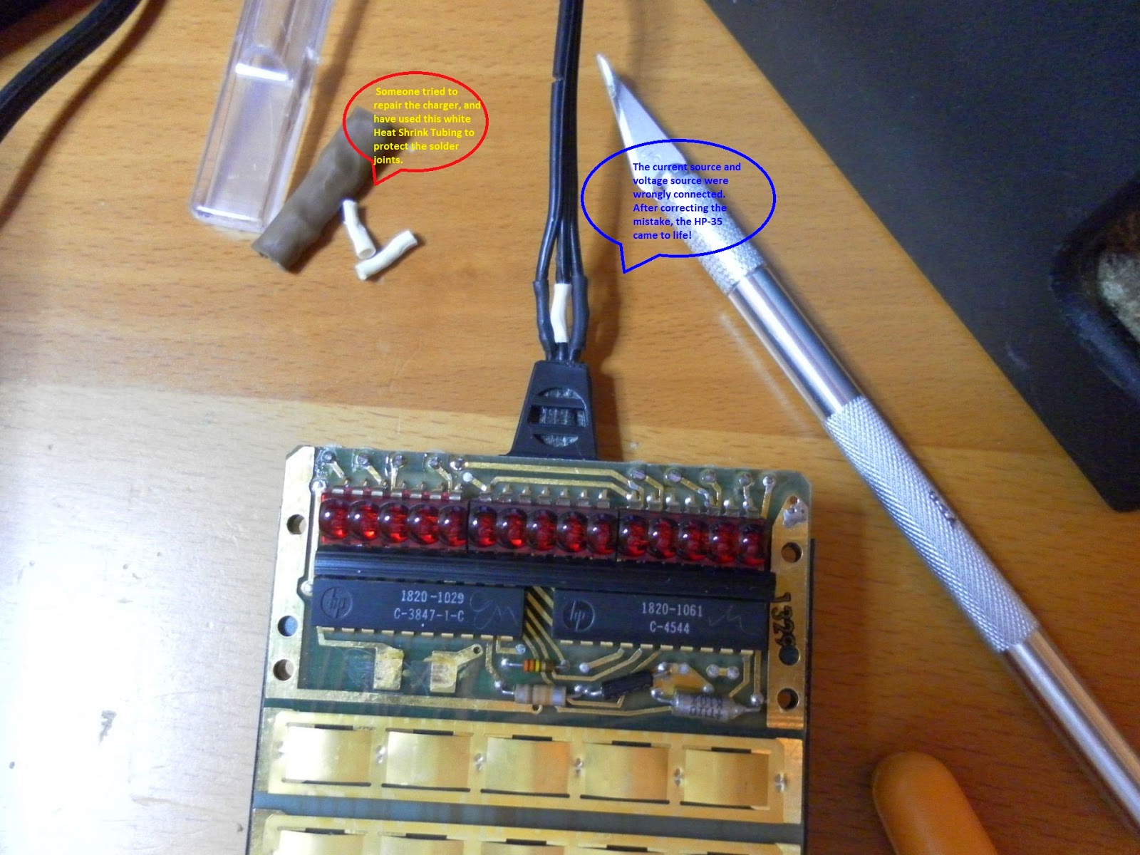

The seller sold it for parts, as it didn't power on.
The charger cable near the 3-opin plug was tampered by someone that probably tried to repair a broken wire.
I was not expecting too much from this item, but when I measured the output of the charger, I saw to my surprise that the readings were at the wrong pins of the plug, having the 16V current and the 5V voltage sources swapped!
So I thought, surely this calculator has been beaten to death by receiving 16V to the power supply DC-DC converter.
What are the odds of these components to survive under these conditions?
Actually, a lot - The 16V are a current source to charge the battery.

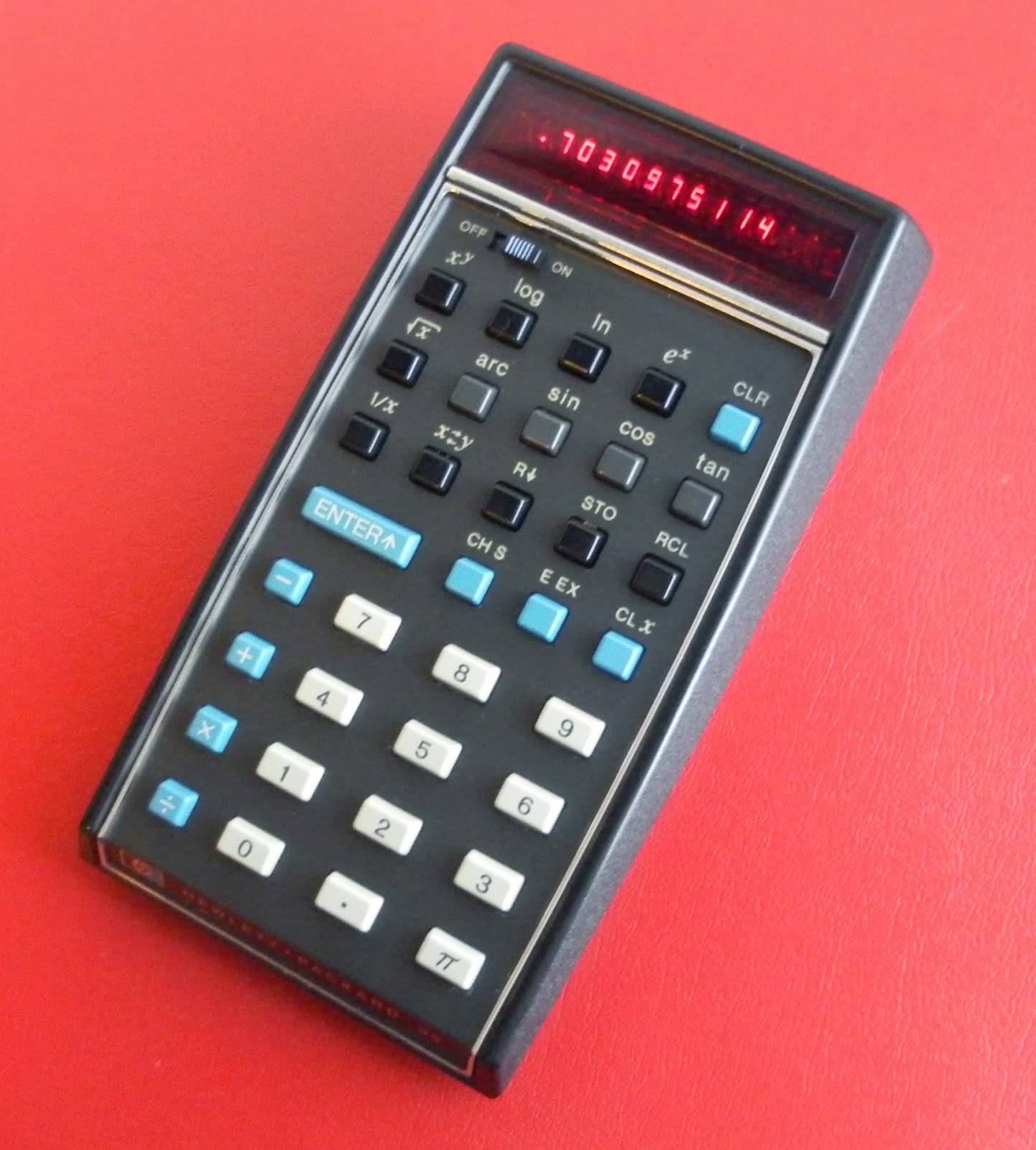

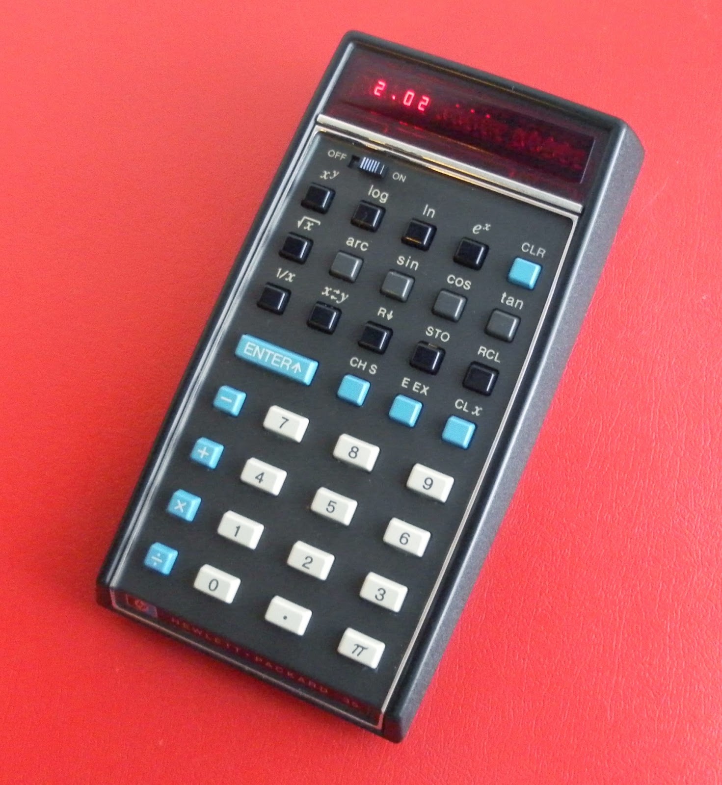

Having corrected the mistake, I couldn't wait!

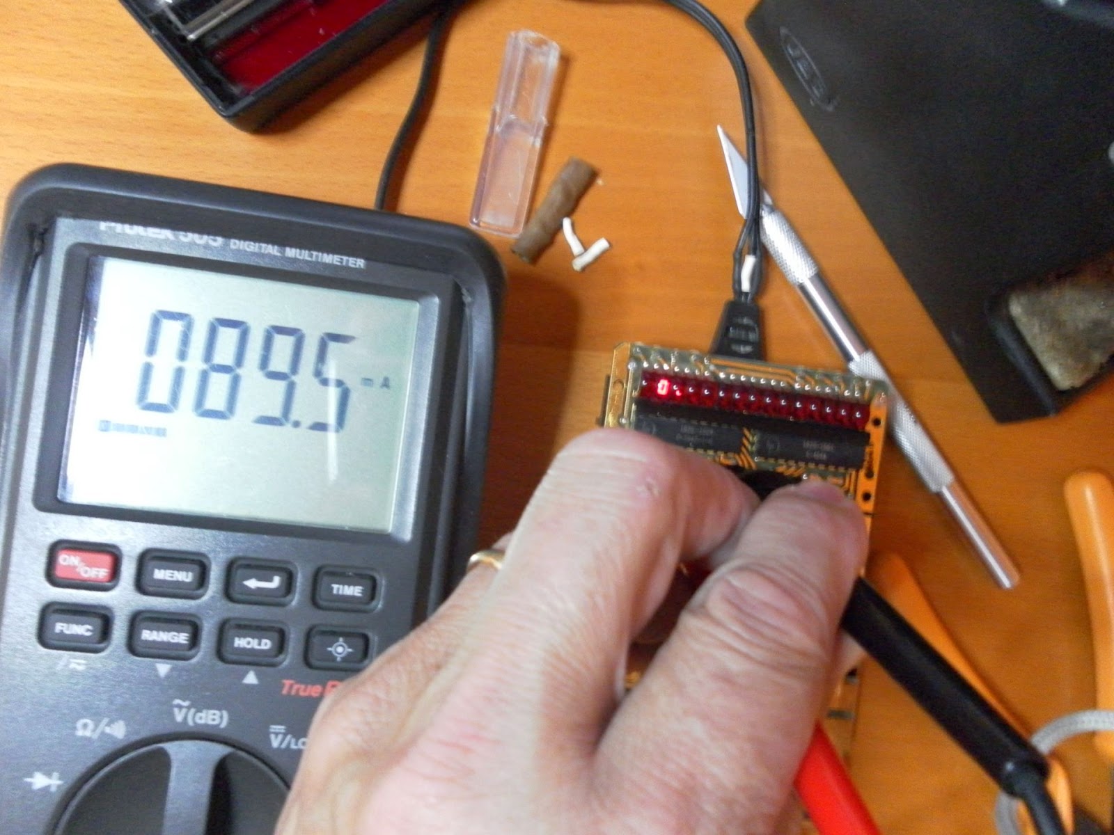

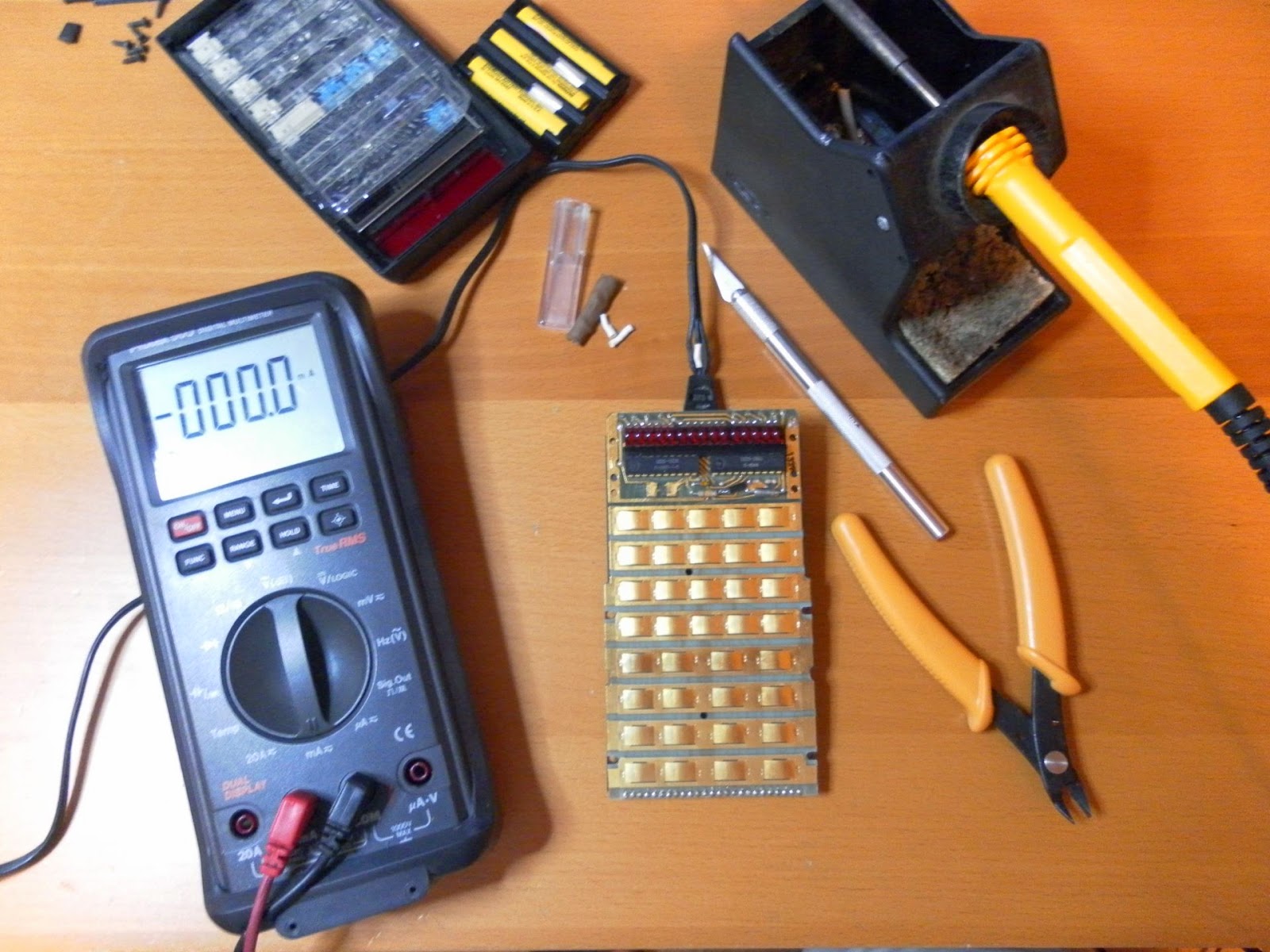

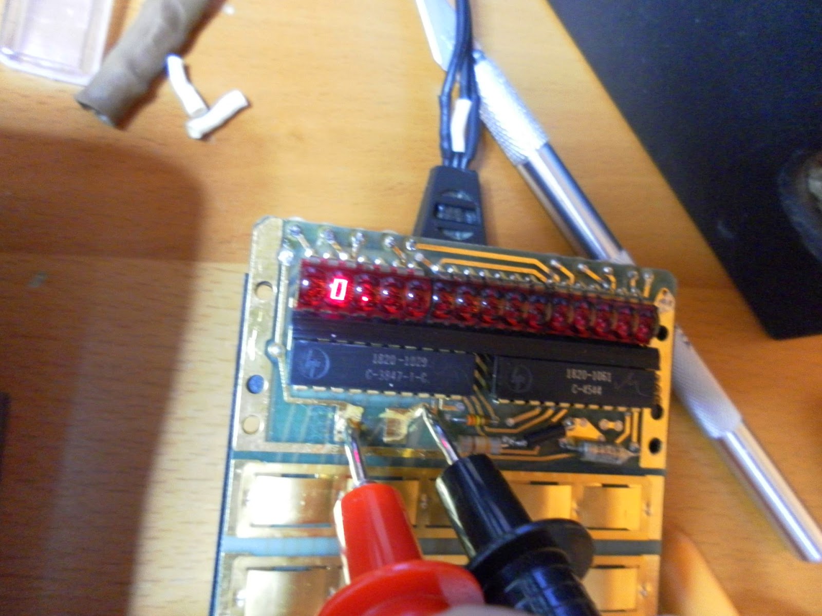

I used the multimeter in current mode and used its test probes as a switch, touching the switch contacts carefully while looking to the current meter... I saw 89.5mA... Yes, looks good enough so far...
And amazingly the calculator came to life on the first try!
The display gave that nice looking red color with a "0.".
I tried the classical multiply test: 12345679 ENTER 9 * -> 111111111
And just to make sure it works: 1000 log -> 3
This calculator was sealed from factory, never opened before, despite a lot of dirt in the keyboard area. So I decided to open it to do a good cleaning.
The electronics PCB is immaculate, though.
I will share better pictures later. For now I'm uploading the spontaneous shots took at the time of the troubleshooting.
[Image: SAM_7873.JPG]] [Image: SAM_7874.JPG]]
[Image: SAM_7877.JPG]] [Image: SAM_7879.JPG]]

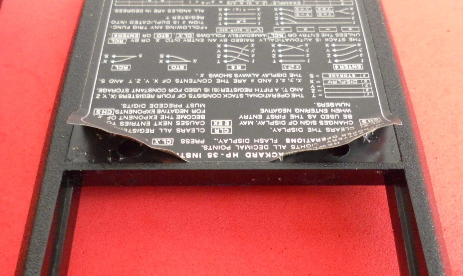

(09-22-2014 08:47 PM)jebem Wrote:  This calculator was sealed from factory, never opened before, despite a lot of dirt in the keyboard area. So I decided to open it to do a good cleaning.
Did you carefully remove the back label with heat and patience, or just poke holes to get at the screws? Which version is it? (Some experts can probably tell by looking at the circuit board and other evidence in your pictures, but I cannot.)

(09-23-2014 11:54 AM)Jeff O. Wrote:  Did you carefully remove the back label with heat and patience, or just poke holes to get at the screws? Which version is it? (Some experts can probably tell by looking at the circuit board and other evidence in your pictures, but I cannot.)
Hi Jeff,
Thanks for your reply.
Well, usually I'm not a patient guy (like I should be on these nice rarities), only because I couldn't wait... although later I really regret by being like this.
So, I should have used a hair dryer, but this time I have just have used this old technique of breathing into the label while using a X-acto knife to carefully lift the label in order to access the screw holes.
I believe the label was not damaged in the removal procedures. I will see later when reassembling the unit after cleaning it.

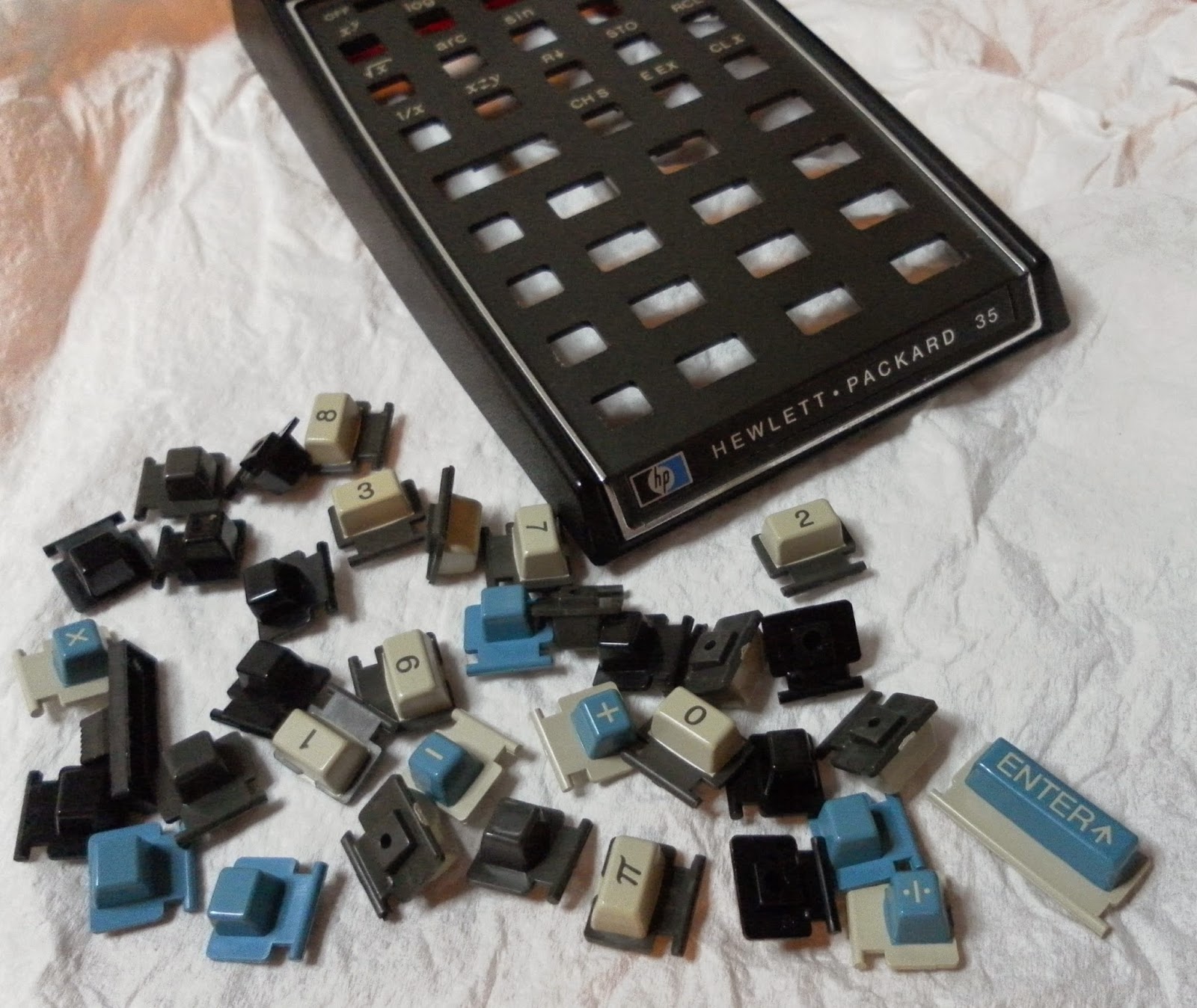

Meanwhile I have cleaned the 35 keys and the power switch, by leaving them in water for a few hours, and then used soft dish detergent and a tooth brush to remove the dirt.
The top cover received the same treatment, but unfortunately the LED lens is just a little bit scratched and so far I am not in the mood to polish it.

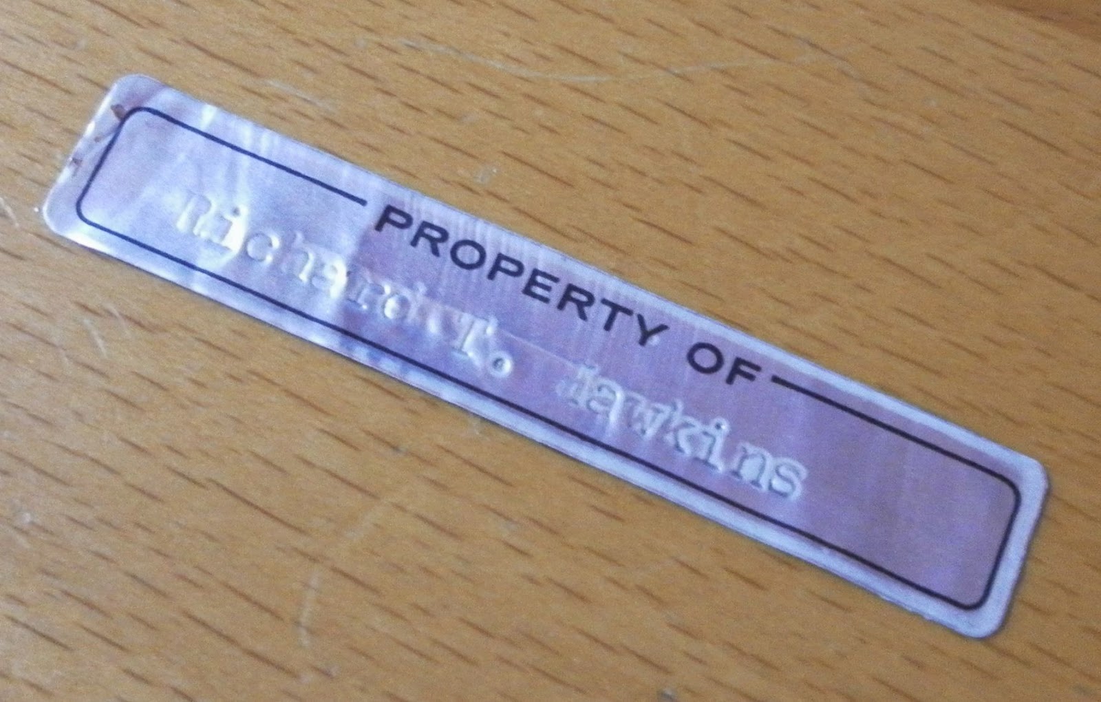

And as a side note concerning the previous owner:
When I was opening the HP-35 calculator back cover, I noticed a metallic label stuck to the side of the battery compartment.
This label has the following information:
"Property of Richard T. Hawkins"
A quick search in the Google machine reveals a number of people with that name.
However, just one fits the typical user profile of such machine, epoch and age, and motivation to put a professional label in their equipment:
Department of Chemistry and Biochemistry Brigham Young University, Provo, UT 84602
Searching just a bit more, I found this obituary:
A retired Brigham Young University organic chemistry professor Richard Thomas Hawkins passed from this mortal existence December 12, 2013, in Orem, Utah, at the age of 84.
And I bought this calculator less than one month ago from a large eBay seller in Salt Lake City, Utah, United States.
Too many coincidences for a random event.
I think I have found the original owner's name. May he rest in peace.
I will take good care of this nice piece of computer history for him.
[Image: SAM_7883.JPG]]

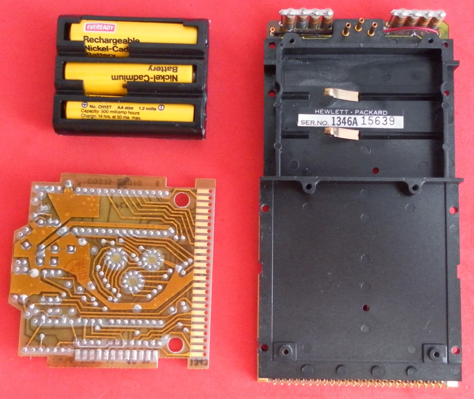

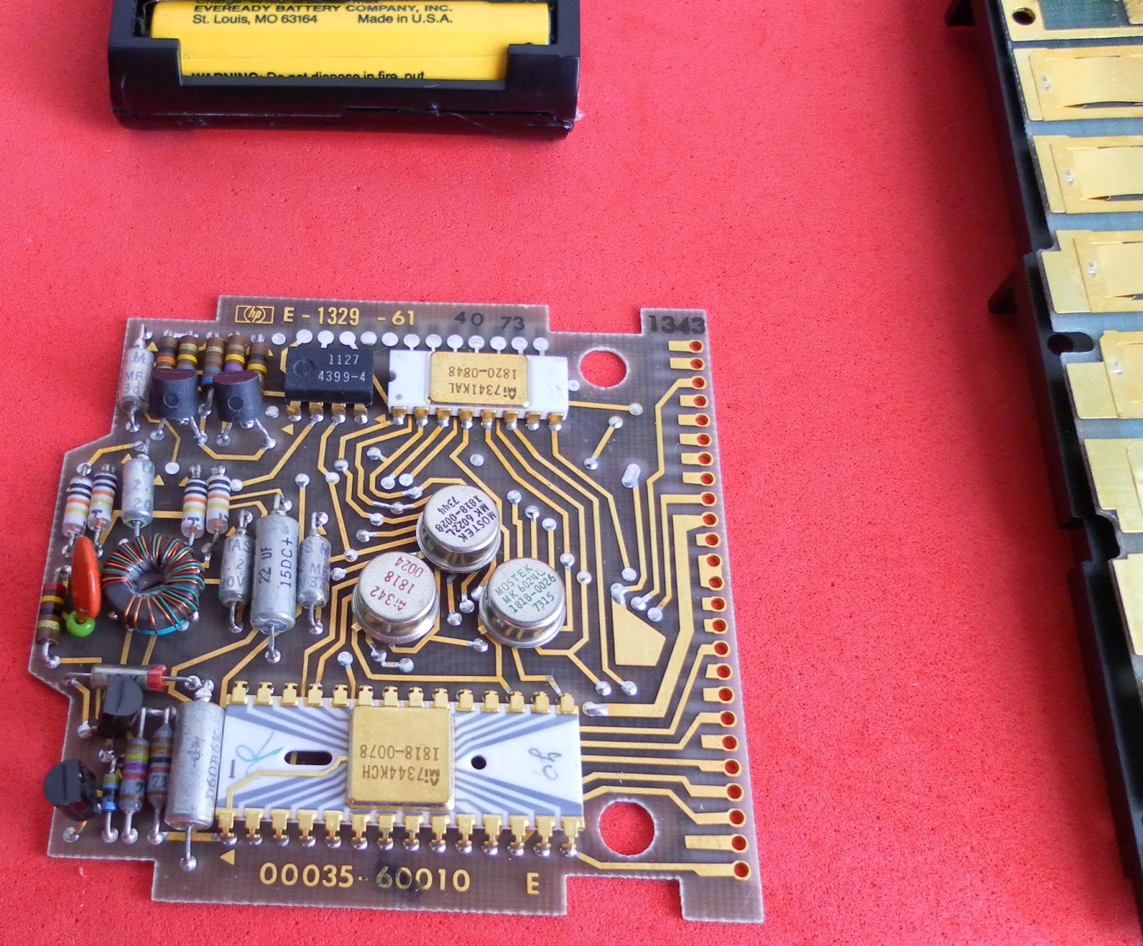

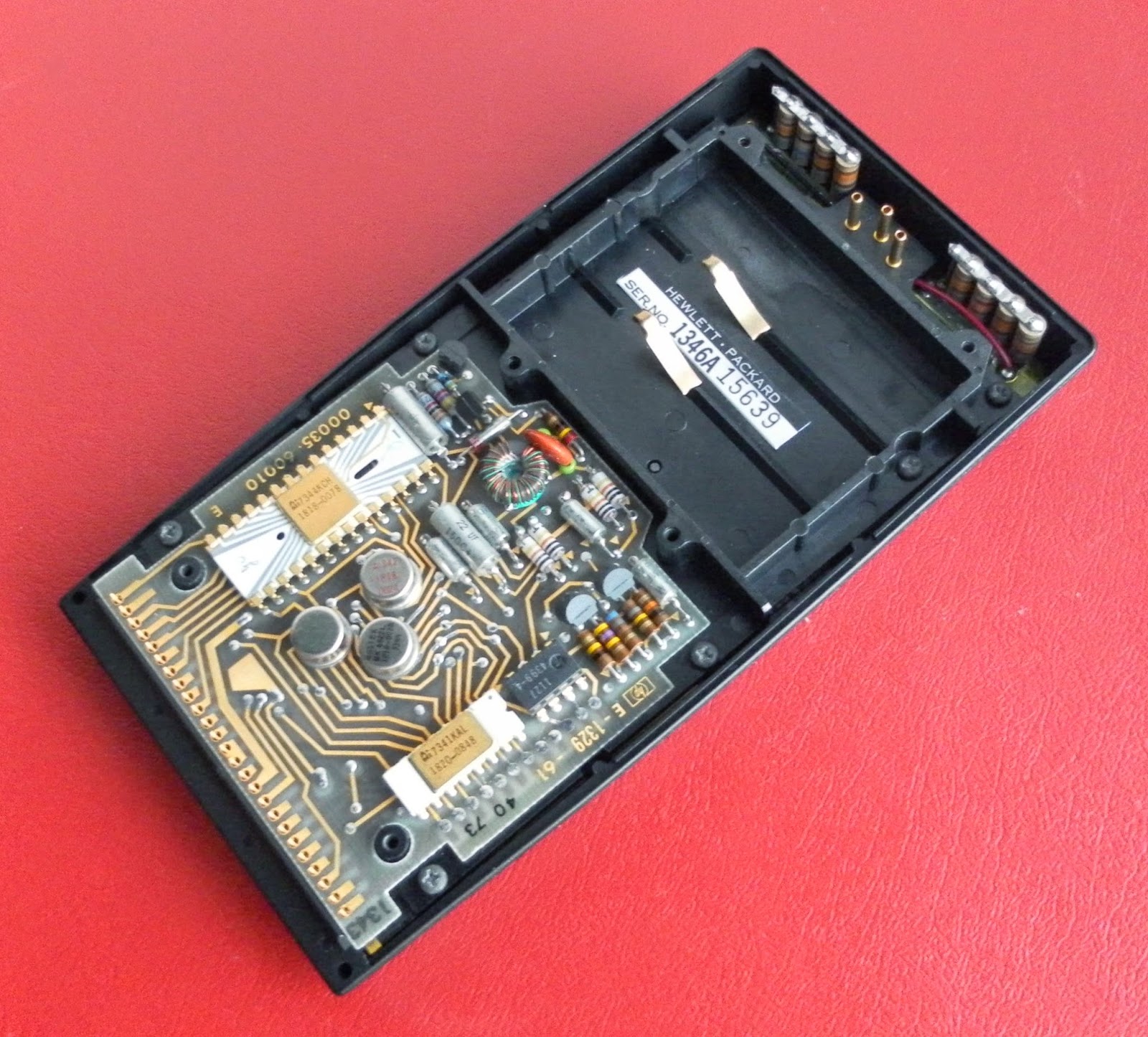

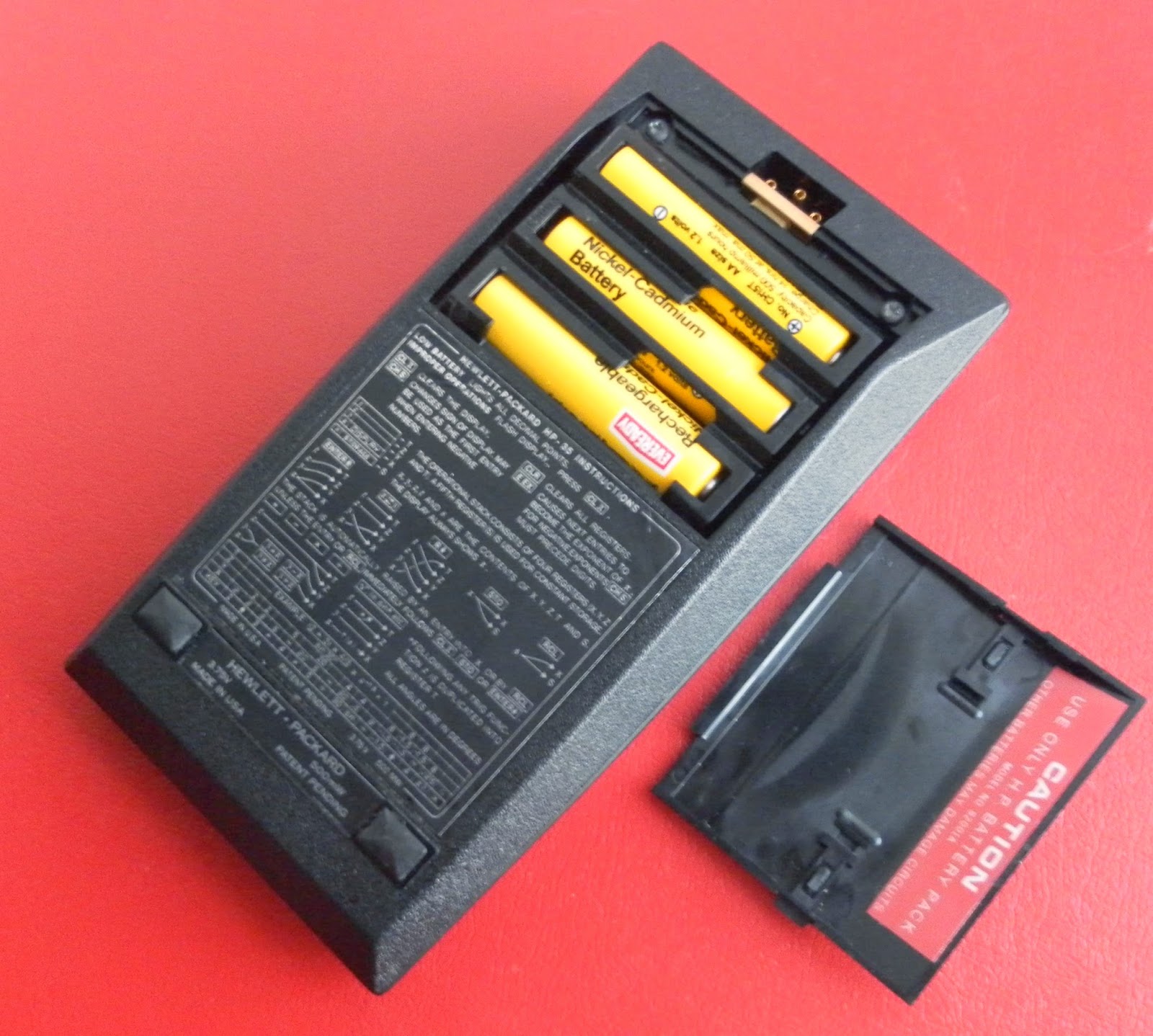

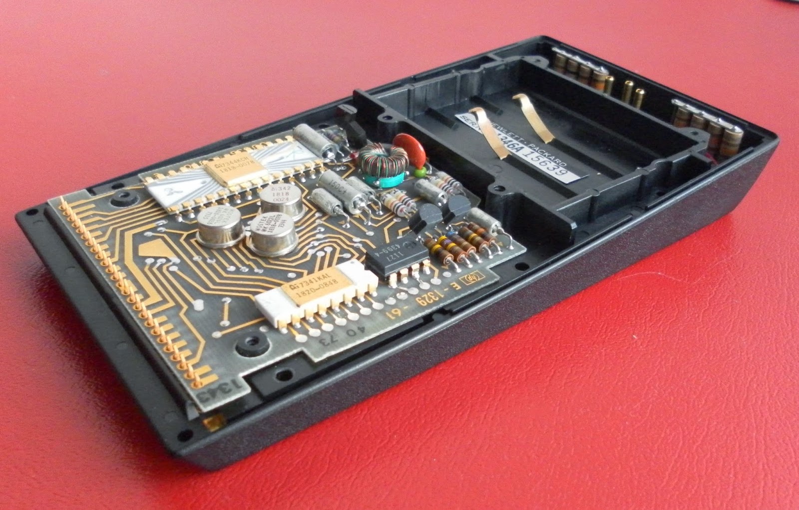

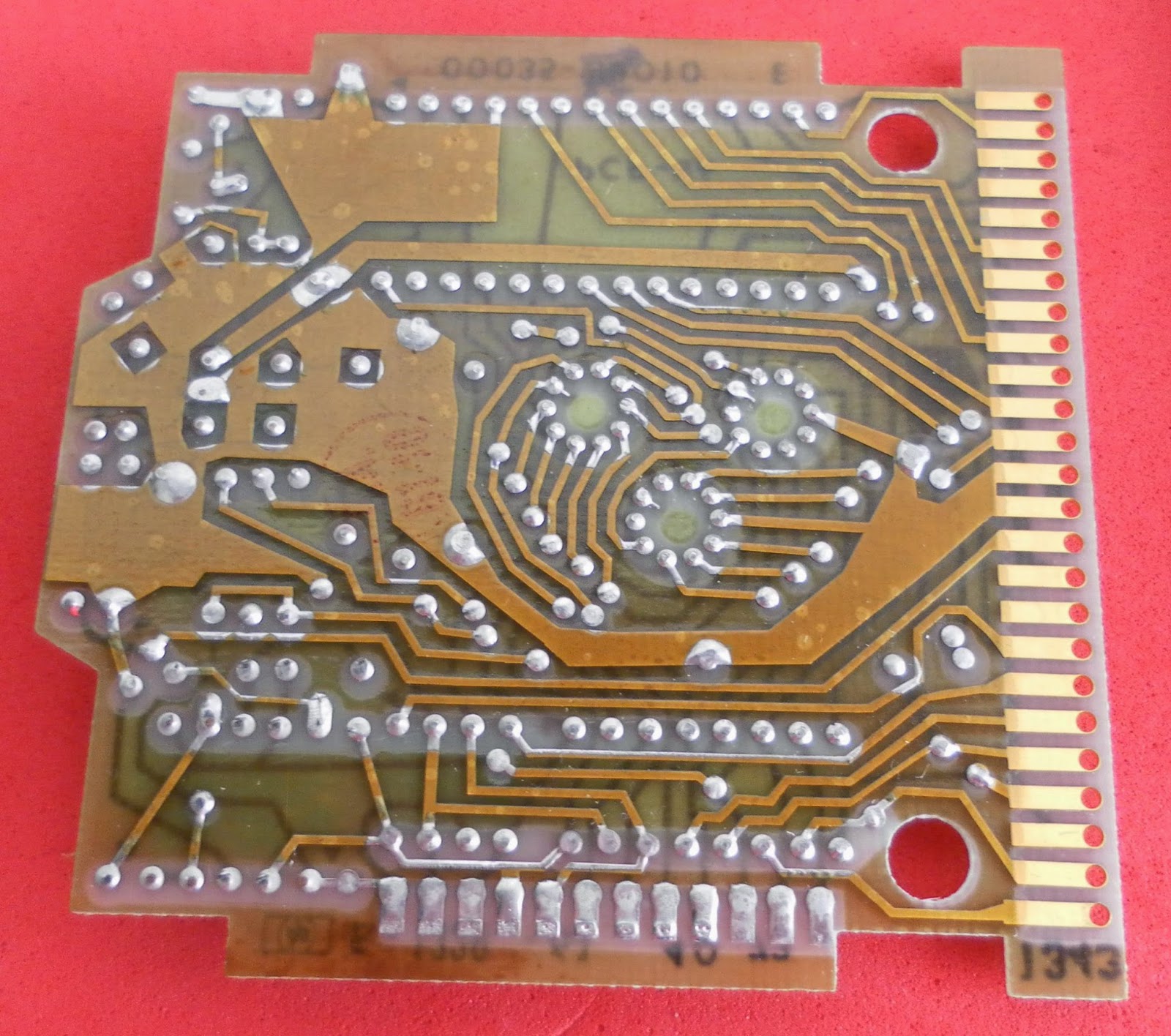

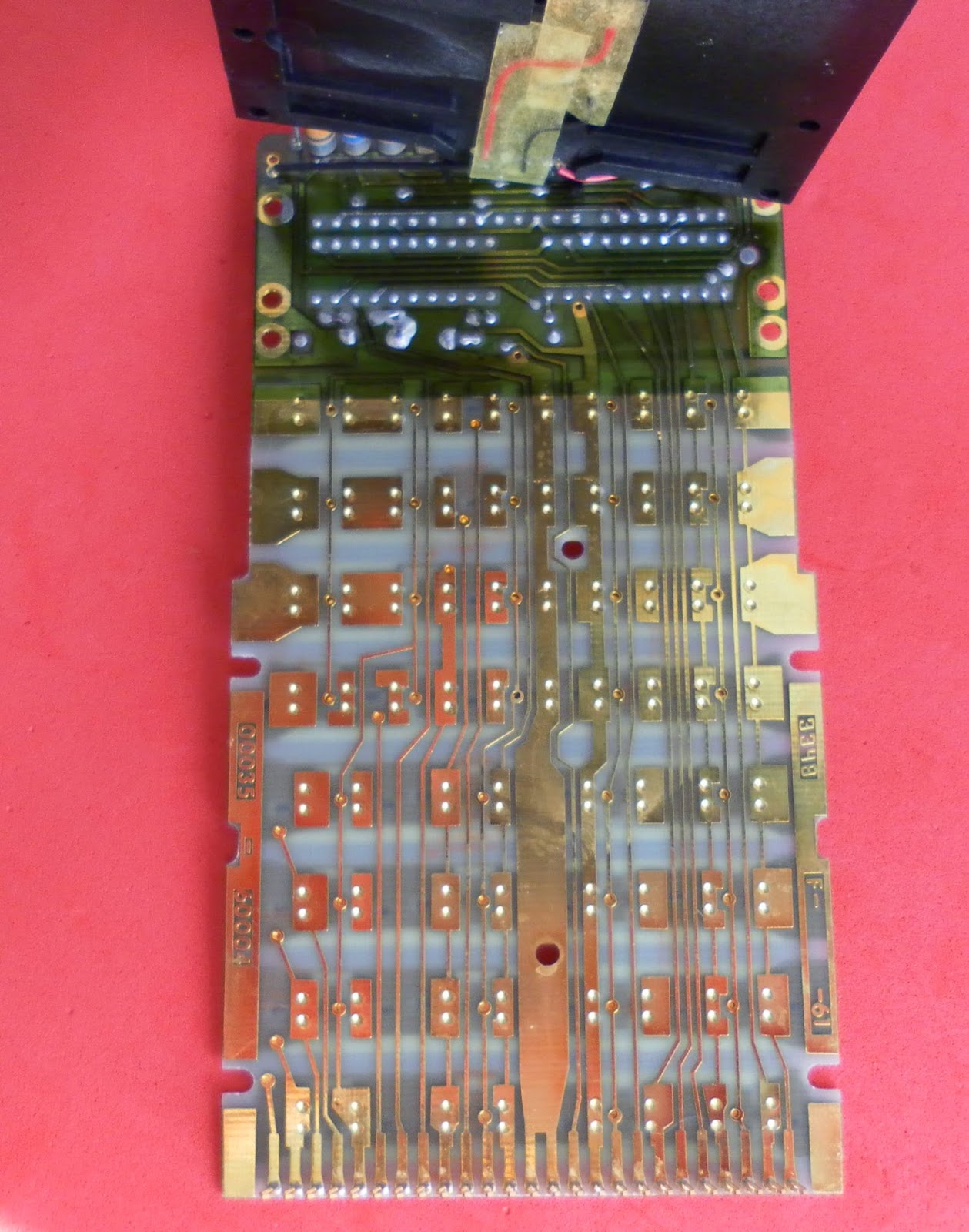

As promised, here are the first batch of photos showing the calculator internals.
As you can see, my lack of patience already destroyed a perfectly good rubber foot only because I was not looking to what I was doing. Silly me. Hopefully the rubber
foot will stick back nicely.
[Image: SAM_7900.JPG] [Image: SAM_7898.JPG] [Image: SAM_7886.JPG]
[Image: SAM_7887.JPG] [Image: SAM_7888.JPG] [Image: SAM_7889.JPG]

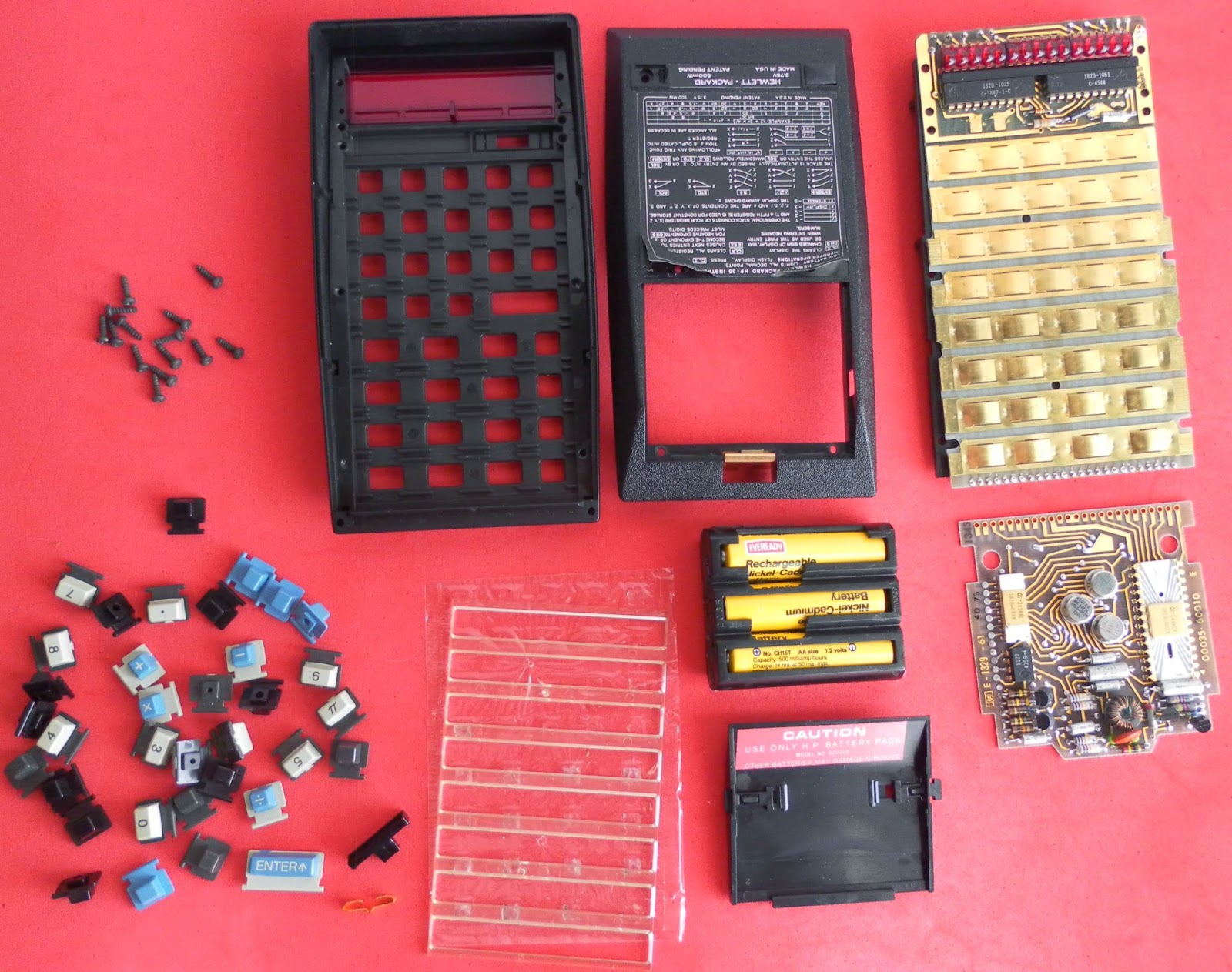

Following are the remaining photos of the calculator internals.

Alright, here it is my last batch of photos of my HP-35.
It works fine, even the battery pack is almost perfect after taking about 14 hours of charging to regenerate the cells.
And the famous "exp(ln(2.02) = 2" bug is of course missing in this firmware release.
