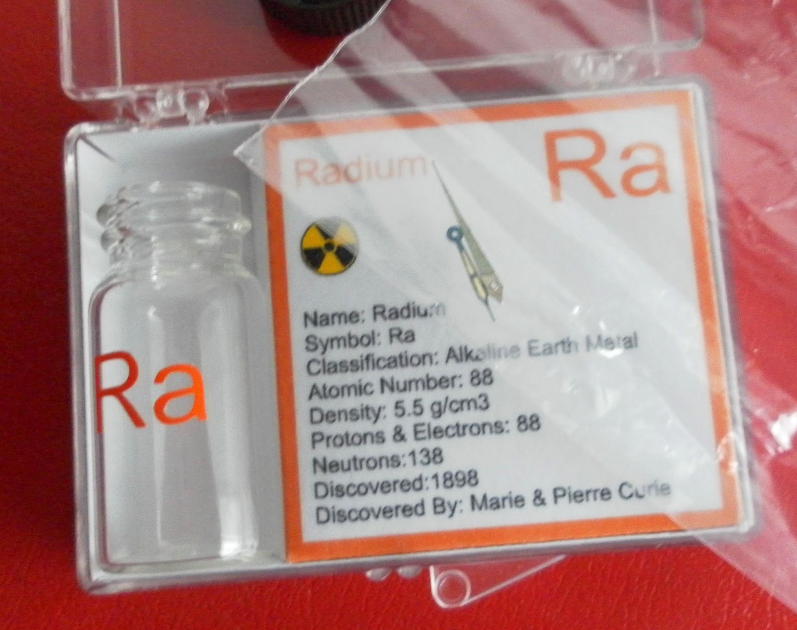

Some time ago I ordered some nice vintage watch hands, guaranteed to have Radium paint.
I wanted to discover how dangerous can it be for human health by comparing the safety accumulated radiation annual dose against what these Radium painted hands can emit.

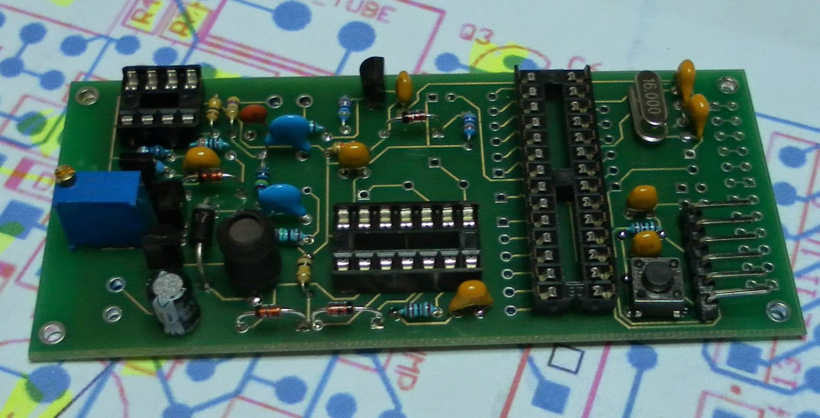

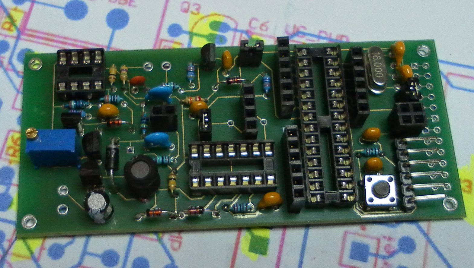

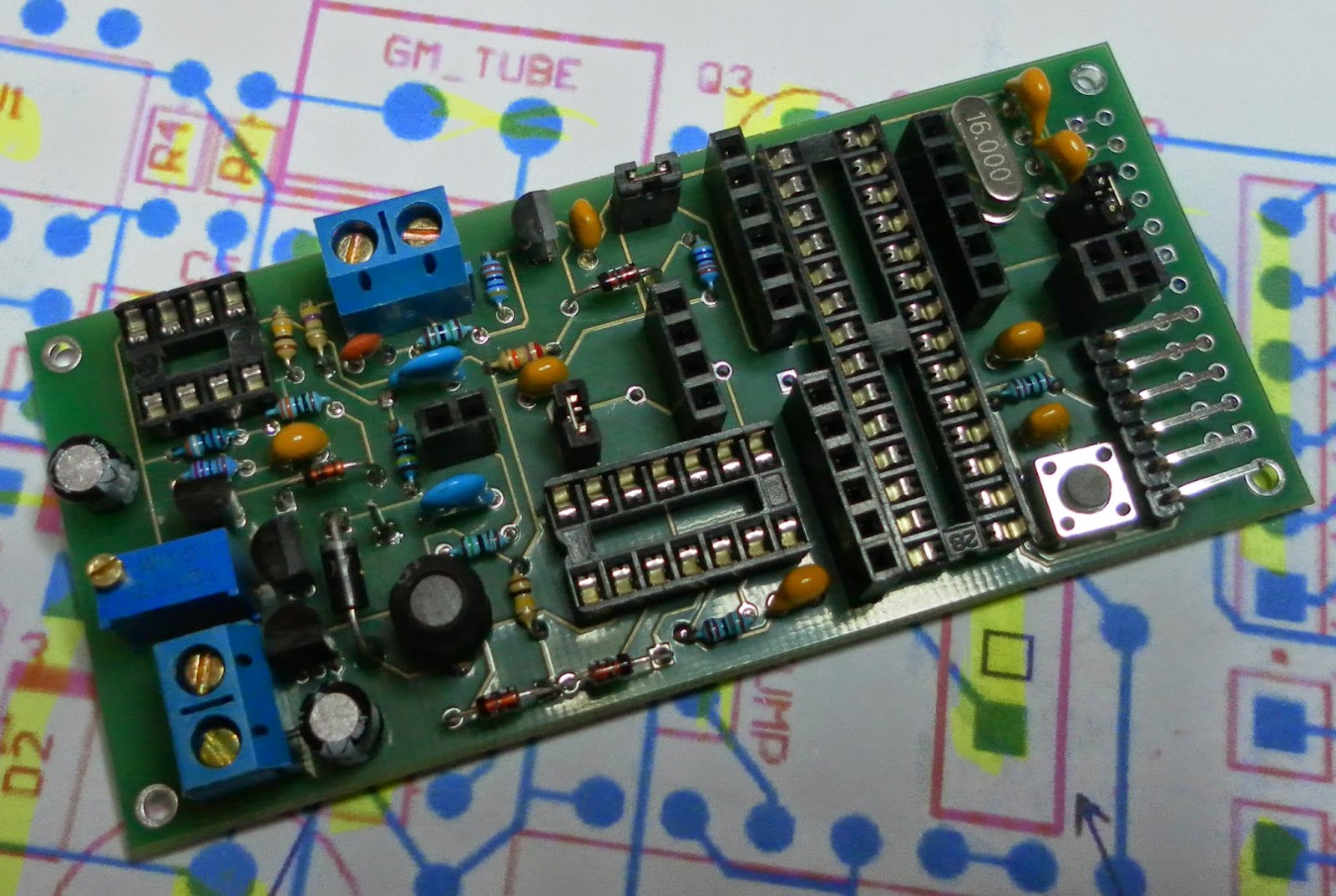

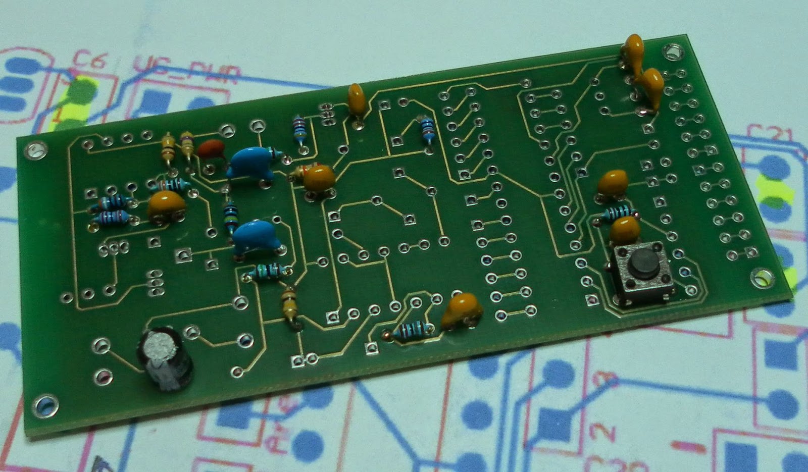

Assembling the Kit mainboard PCB.
Regulated 5VDC power supply, high voltage DC-DC converter, pulse detection and amplification, analog monitoring (visual and audible), and digital calculator based on a arduino open source project.
Following the electronics best practices, place the components as you like best (just kidding).
[Image: GM_Arduino_001.jpg] [Image: GM_Arduino_002.jpg] [Image: GM_Arduino_003.jpg]
[Image: GM_Arduino_004.jpg] [Image: GM_Arduino_005.jpg]

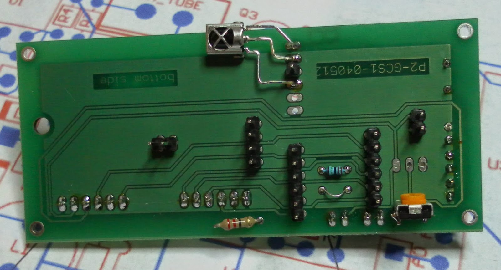

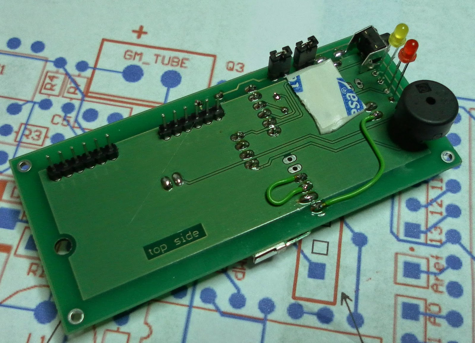

Assembling the Kit LCD display piggyback PCB.
This particular kit offers not only the digital monitoring on Sieverts, but it can also offers a data logger interface, two different menu readings selected by a press button, and at last a menu driven setup invoked using a IR TV like command set (so there is no need to connect the arduino to a PC).
[Image: GM_Arduino_006.jpg] [Image: GM_Arduino_007.jpg]

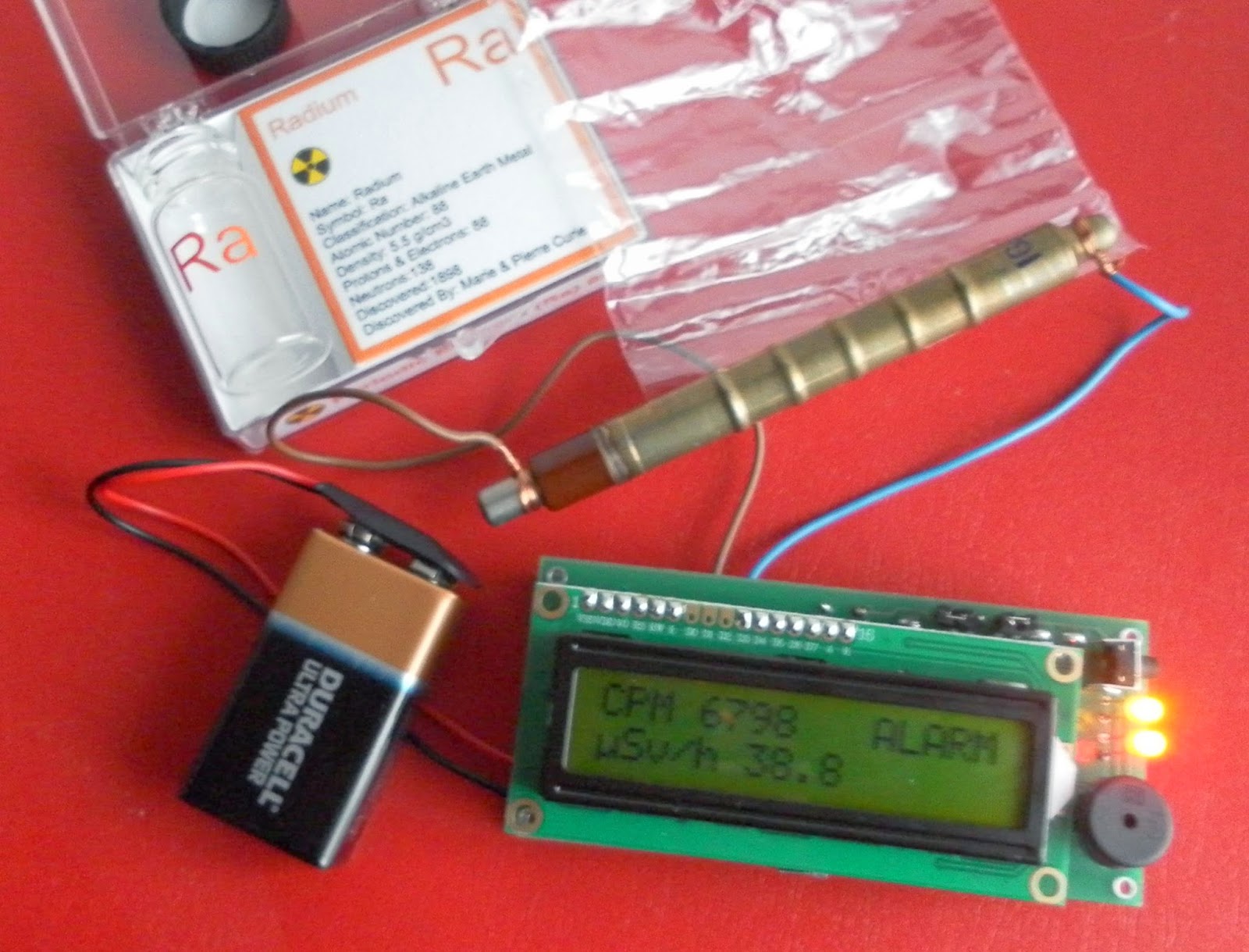

At last, the watch hands radiation emitting testing...
Considering the current safety standards, what would be the risk level for someone using that watch for a full year, accepting the monitored value of 39uSv/h?

(01-18-2015 11:19 AM)jebem Wrote:  Considering the current safety standards, what would be the risk level for someone using that watch for a full year, accepting the monitored value of 39uSv/h?
XKCD: Radiation Dose Chart
That would be about 340 mSv per year. Compare this to:
Quote:Maximum yearly dose permitted for US radiation workers (50 mSv).
Be careful!

(01-18-2015 11:19 AM)jebem Wrote:  At last, the watch hands radiation emitting testing...
The biggest risk with Radium Watches was to the girls that worked in the factory painting the watch faces. Just do a Google search for "Radium Girls" and you can read about the suffering done by these workers just so we could read the watch faces and hands in the dark.

(01-18-2015 01:44 PM)Thomas Klemm Wrote:  ... about 340 mSv per year. Compare this to:
And: Lowest one-year dose clearly linked to increased cancer risk = 100 mSv.
Watch it!
P.S.: Radium decays emitting alpha particles. So a sheet of paper is sufficient for shielding. Once the watch hands are mounted and the cover glass is fixed, there should be no risk anymore. BUT avoid ANY direct contact of that material to your body!!
Radium is almost entirely 226Ra, decaying into 222Rn which is a gaseous alpha emitter, decaying into 218Po which is an alpha emitter again decaying into 214Pb. The lifetimes of 222Rn and 218Po are far shorter than the one of 226Ra. Since it's a noble gas, 222Rn can be inhaled, so after some days contemplating over open watch hands you have some Polonium in your lung where it must not be!!
BTW, German Wikipedia tells:
Quote:Die maximale erlaubte Jahresdosis für beruflich strahlenexponierte Personen beträgt 20 mSv, über ein Berufsleben dürfen jedoch nicht mehr als 400 mSv zusammenkommen.
(~ max. dose per year for professionals exposed to radioactivity is 20 mSv; they shall not receive more than 400 mSv in their professional life.) Compare the value stated above and you see that US radiation workers are more robust (as usual Wink ).
Thanks, Thomas!
It is better to be safe than sorry. I have to put these two watch hands away in the cellar. Just in case!
Clearly these radioactive compound products should be banned from the market for safety reasons. The true is that I bought these vintage watch hands from the eBay, legally, about two years ago.
I believe I took the minimum safety precautions handling it. I never opened the hands plastic bag container, and this package is going to a safer place away from me in my garage/cellar for the next 1600 years Smile
Is that the Radium half-life I'm reading in Google? Really? How come we mortals spend at most 100 years on earth and a tiny heavy atom in excess of neutrons lives as much as 16 times more only to lose half of its material? Not fair! Smile

Jebem, I think no one really needs (nor really wants) to own any amount of radium just for the fun of it. Maybe you can keep it somehow safely now, but can you expect that it will be handled properly in the future?
Alpha emitters when inhaled or ingested become a "fully-blown" Smile ionization source sitting within your living tissue, that's why they are powerful mutagens and even small amounts are dangerous (don't judge these things for their size, but for their activity). This radium paint can produce some nasty powder. The idea of radiological protection is to prevent any unnecessary exposure, more so beyond the general public/student/worker safety limits.
I wouldn't trust or use a G-M tube for dose measurements. Unfortunately DIY people talk about mSv all the time, they have no idea what they're talking about. The sievert is the unit of dose equivalent, which is the product of the absorbed dose by a dimensionless quality factor Q. Q = 1 for gammas and electrons, but it can be as high as 20 for high LET radiation, for instance alphas. What they mean is absorbed dose, which is measured in grays, 1 Gy = 1J/1kg = 100 rad. But in order to measure this you need to measure the absorbed energy, for instance with a chamber where you can apply the Bragg-Gray principle.
G-Ms actually detect radiation as radiation monitors, they count ionizing particle events that get into their chamber (that means that you need a thin window and being really close to the source for alpha and beta particles, because of air attenuation: the range of alpha particles in air is just a few cm), but can't give you any information about their energy or type because they operate in a kind of saturation plateau, so there is no way to measure the absorbed energy. I think there are some variants that claim to use "energy compensation" (this one probably isn't), I haven't seen one myself. People use ionization chambers (often inside phantoms) for these things.
So what are you measuring here?
Decay scheme Ra 226
Decay scheme Rn 222
Well, let's consider the Rad 226. Besides the 186 keV gamma emission of the Rn 222 that happens 3.5% of the time, which you detect mostly through Compton scattering electrons from the walls of the chamber (the G-M efficiency for gammas is a few percents), most of the counts are delta rays (secondary electrons) coming from the 4.6-4.8 MeV alphas in air.
You have have the decay chain of the daughter nuclide as well, Rn 222, which is a dense inert gas that will diffuse around. Its progeny, while emitting more alphas (more delta rays for the counter) and now betas too, will deposit nearby resulting in a certain amount of Pb 210 contamination (that will turn slowly into awful Po 210).
Notice that you have this in a plastic bag, then air, the pic shows the detector next to, but not over the source (it could be closer as well) and we have no idea about the efficiency of the detector (its geometric efficiency is hard to figure), or its calibration (what about dead time?). Those 7000cpm are surely proportional to the activity of the source, but we can't really tell their relation to it.
About your G-M tube, I've found this info:
http://gstube.com/data/2398/
http://mightyohm.com/blog/2014/11/a-spot...nter-tube/
According to this, at 500V you're probably operating it beyond its VDC rating (350V-475V), recommended 400V (there is a 260V min, 320V max starting voltage there). Above the G-M plateau the gas-filled cylindrical ionization chamber is not a G-M any more and you might break it, specially if the quench compound is worn out.
I don't understand the "Gamma Sensitivity Ra226 (cps/mR/hr)" figure. It makes sense it being higher than the one for Co 60, as Co 60 is a >1 MeV gamma emitter but I really don't know how to use that number. If someone does, please give us a hint. On the other hand, I wouldn't trust the specs of a radiation detector hopefully calibrated some 40 years ago.
Please, check this:
https://www.orau.org/ptp/collection/radi...ntinfo.htm
Quote:"NCRP Report 56 indicated that the estimated average dose equivalent to the gonads of an individual wearing a radium-containing watch was approximately 3 mrem per year. The estimated dose from a watch containing 4.5 uCi of radium, a very large amount, would be 310 mrem per year to the gonads. Note that the associated risk here is much lower than if the dose had been the same over the entire body.
In the previously mentioned study of pocket watches by the National Center for Radiological Health, measurements using TLDs and a human phantom indicated that the annual dose to the gonads was 60 mrem (assuming that the watch was worn 16 hours per day)."
As 1 Sv = 100 rem, that high activity watch would yield a dose equivalent of roughly 3 mSv/year to gonads. For the entire body it would be less because the tissue weighting factors are higher for gonads (w_T=0.20) than for instance, lungs (w_T=0.12) or skin (w_T=0.01). The ICRP recommended exposure limit for members of public is 1 mSv/year for whole body exposure. I guess watches are relatively safe to wear (not to tinker with) but, as you might take planes frequently and maybe have an X-rays or CT scan every once in a while, I think there's just no need for that.
My advice would be: use disposable gloves, put that bag in a sealed thick-plastic food container, throw in the gloves before closing it and (assuming you are in Lisbon) contact these people (my educated guess, I really don't know how things go in Portugal, for instance in Spain we have a state-owned company -Enresa- for this) they can measure/dispose of it:
http://www.itn.pt/sec/psr/pt_psr_rrr.htm
Let me recommend you a book on this (I used its full of typos 2nd edition some years ago):
James E. Turner - Atoms, Radiation, and Radiation Protection

(01-19-2015 03:21 PM)Manolo Sobrino Wrote:  (...) I wouldn't trust or use a G-M tube for dose measurements. Unfortunately DIY people talk about mSv all the time, they have no idea what they're talking about.
Excellent analysis and useful information, thank you!
This is just one more toy, and as you pointed out, one can not trust the readings as accurate - this is not a lab nor a professional field equipment.
But the readings are real and gives us enough information about the radiation around us. For instance, inside home the background radiation is about 8 to 10 CPM and this value seems to be the usual in many places around the world.
Concerning the high voltage power supply, it is adjustable - when I mentioned 500V is just the nominal initial value - It can be as low as 200V and as high as 900V in this circuit. I'm running it at 400VDC as recommended in the Russian datasheet.
I don't think that there is currently any reason to wear a radium dial watch instead of a normal watch. My understanding is that the typical luminescent material, for example ZnS, breaks down over the years, so that the radium + phosphor mixture no longer glows, even though there is still plenty of radioactive decay. Do you observe any glow from your watch hands?
Here is a link to an interesting article about the Radium thumb rule, for estimating the activity and the amount of radium that you actually have.
Radium Thumb Rule
Note that your GM tube will overestimate the activity, especially if you choose a short (less than 15 cm) measurement distance. The article explains that if the source is too close to the detector, you start measuring beta particles in addition to gamma rays. The radium thumb rule assumes you are only measuring gamma rays.

(01-20-2015 10:30 PM)everettr Wrote:  My understanding is that the typical luminescent material, for example ZnS, breaks down over the years, so that the radium + phosphor mixture no longer glows, even though there is still plenty of radioactive decay. Do you observe any glow from your watch hands?
It might be interesting for you to try and detect radiation from your source with a webcam.
Thanks for the information.
No, my watch hands are not emitting light any more, so the phosphorescent material is gone.
Concerning semiconductors working as gamma particles detectors, I have been reading a few articles about PIN diodes as well.
I remember my work for WANG Computers in the 80's, where the ECC (error correction code) used extra 6-bits to correct 1-bit in 16-bit words. WANG used to say that even cosmic radiation could cause memory "soft" errors on the dynamic RAM modules. Hence the need to make sure an hardware automatic algorithm to fix those errors.
