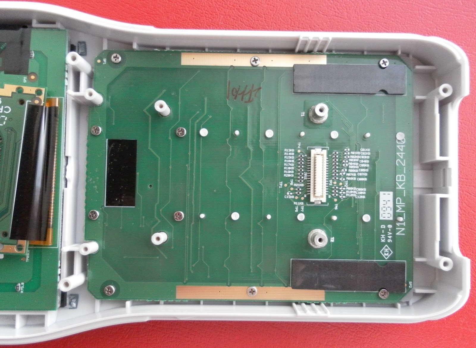

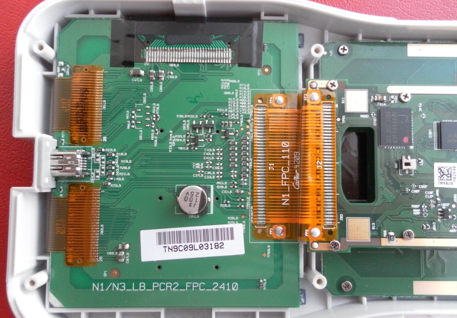

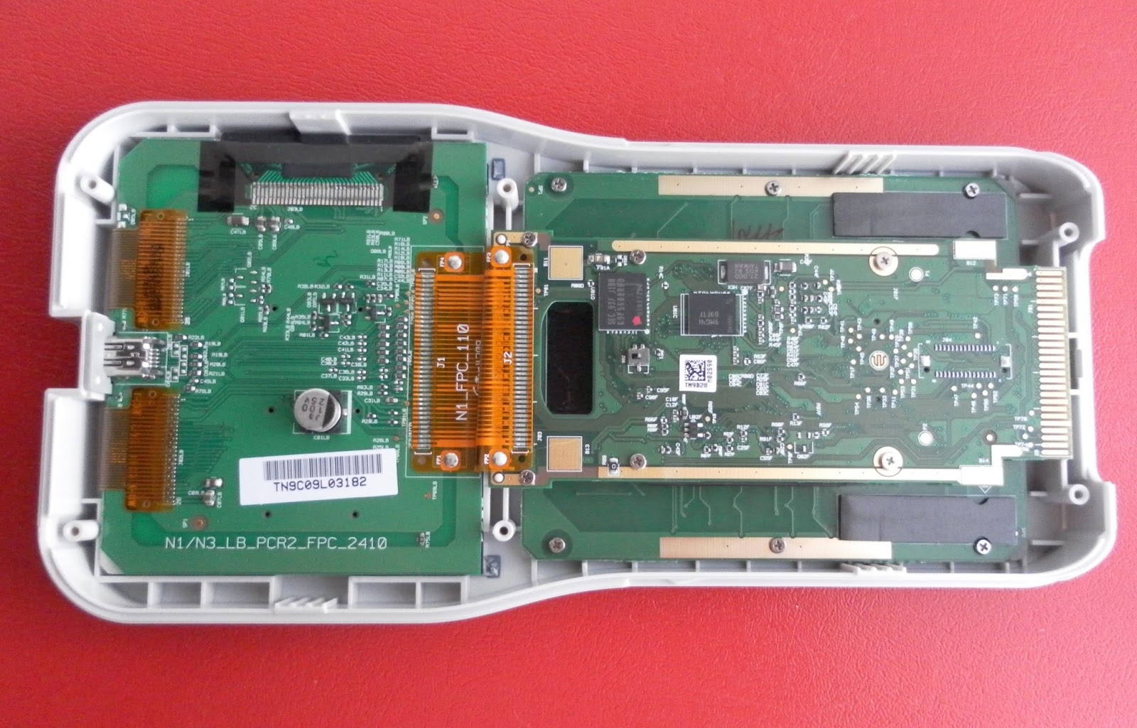

As usual, I opened the calculator to inspect the internal build and condition, and once again I was pleased to find out on how easy is to open the case (just 6 screws), and I saw a well designed and clean inside, that is easy to maintain when needed.
The plastic build materials are good quality, the printed circuit boards (PCB's) and components quality are second to none in this class of equipments, the machine feels compact and on the heavy side, reinforcing the quality feel.
The only weak point is the way they have chosen to connect the battery power supply to the PCB by using metal spring clips. These clips will eventually isolate the power connection due to electrochemical phenomena corroding the PCB copper. Still, this is a easy fix when it happens.

These are great photos.
I never saw such keyboard, very beatiful.
Thanks for this post.
JL

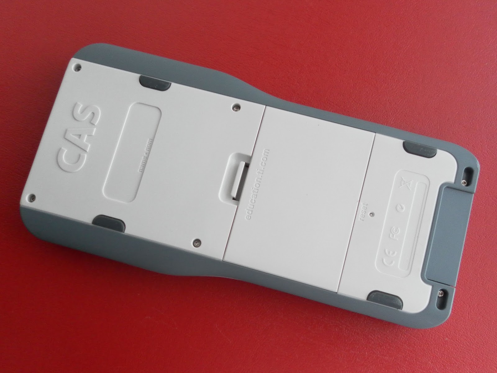

The fact that there's no serial number or date code on the back (picture #2) is highly unusual, given that even most prototypes have serial numbers of a different variety.
The 73 VSC prototype I picked up from the previous libti*/gfm/tilp maintainer, who received it from TI, had no writing on the back (not even regulatory FCC notes), and a sticker indicating that it's an engineering sample not for sale, but that's pretty much the only other such calculator that I can remember of.

(06-28-2015 08:08 AM)debrouxl Wrote:  The fact that there's no serial number or date code on the back (picture #2) is highly unusual, given that even most prototypes have serial numbers of a different variety.
I have noticed the missing serial number, but wrongly assumed that Texas was not printing the serial numbers anymore on these machines.
According to the eBay seller, this machine was "Manufacturer refurbished".
