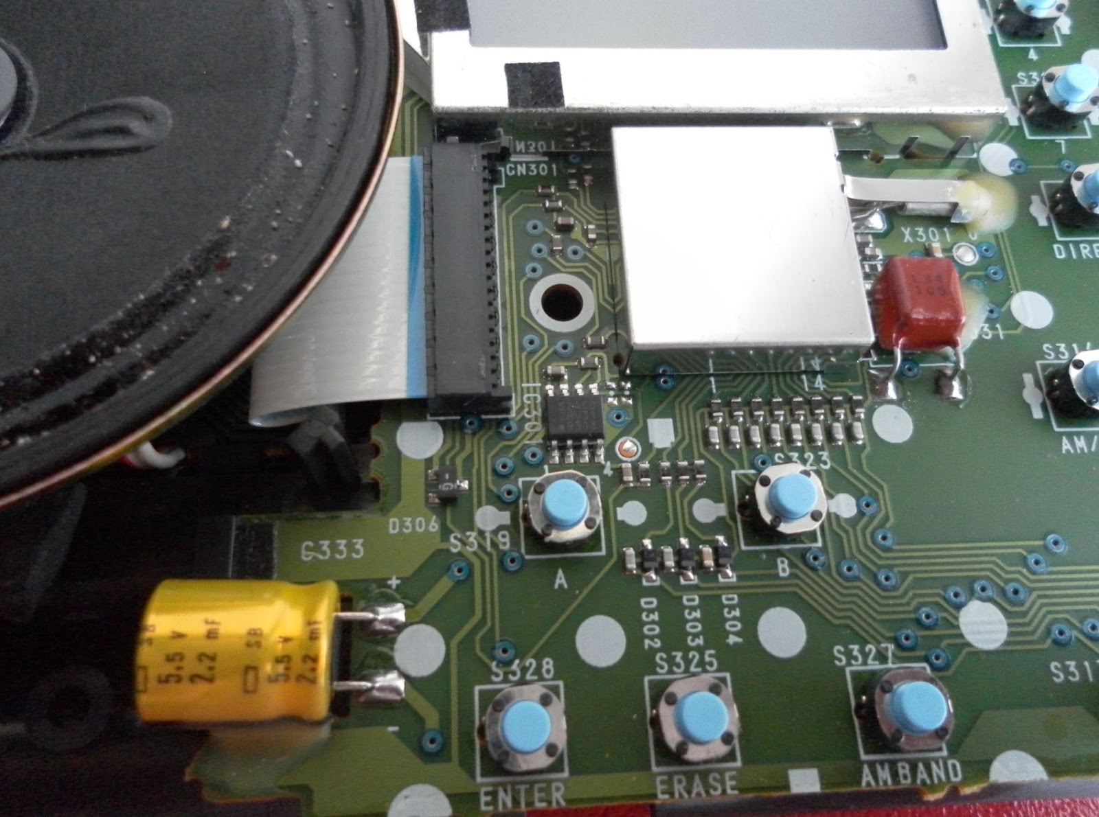

The chassis - front side.
The plastic keyboard key assembly was removed by pulling it out, leaving the key switches visible.
[Image: japan_sony_icf-sw7600gr_014.jpg]
The chassis - front side detail.
Back supply capacitor: 2200uF / 5.5V. It is enough to maintain the clock operation for at least one minute when it is time to replace the four in series AA depleted batteries.
[Image: japan_sony_icf-sw7600gr_015.jpg]

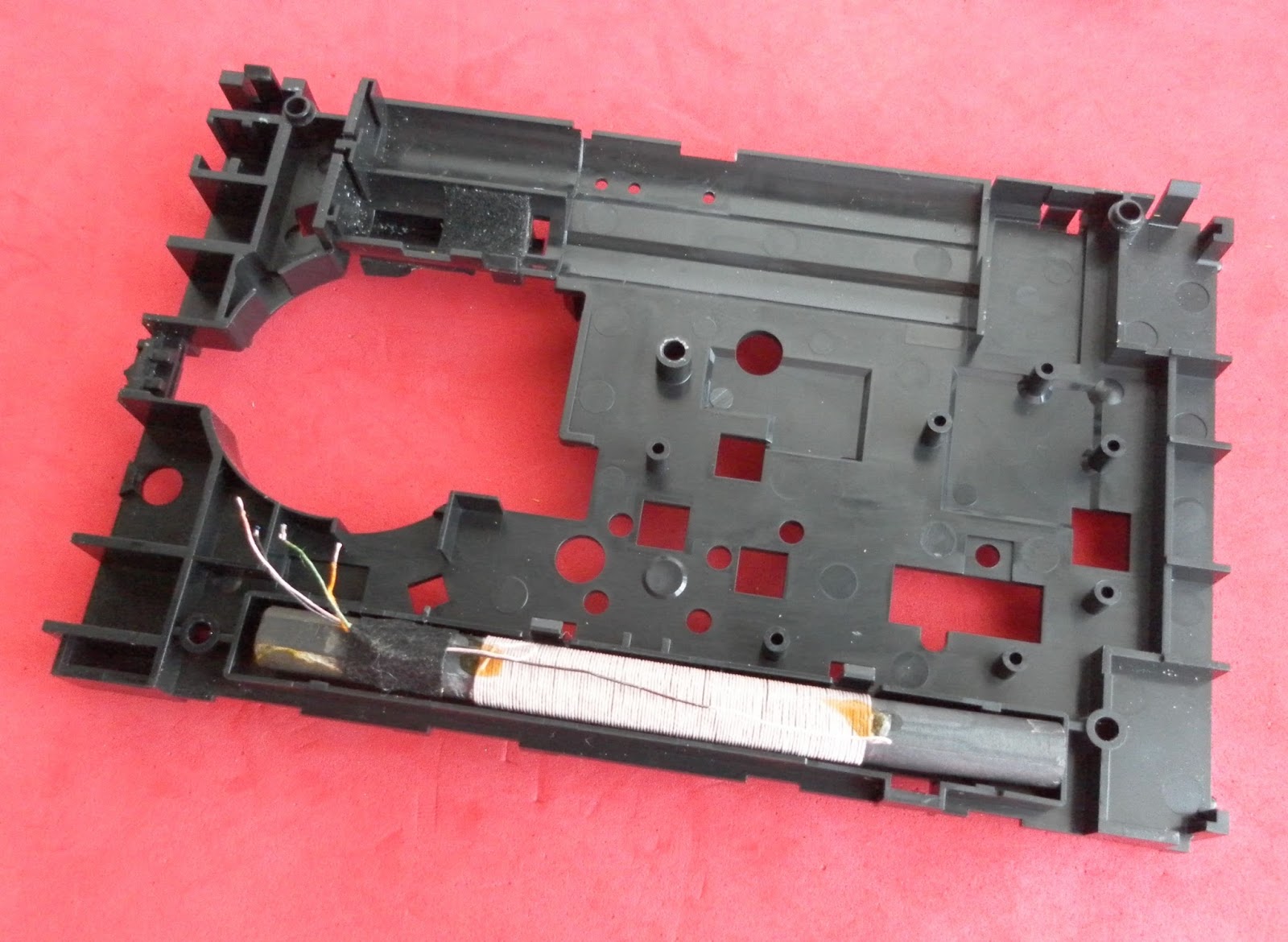

Plastic chassis frame - Back side ( Key Board and Main Board assemblies were removed).
The four wires of the ferrite antenna were unsoldered from the Main Board.

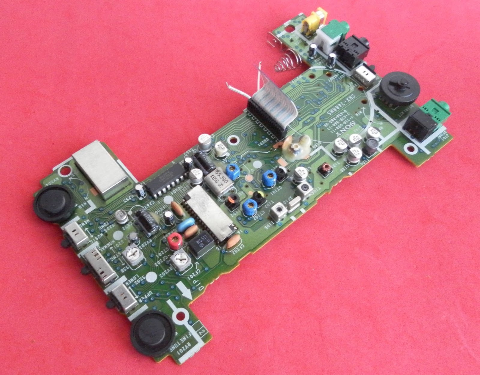

Main Board assembly removed from the back side of the plastic chassis frame.
It is secured in place by four plastic claws. Push them gently to remove the board.

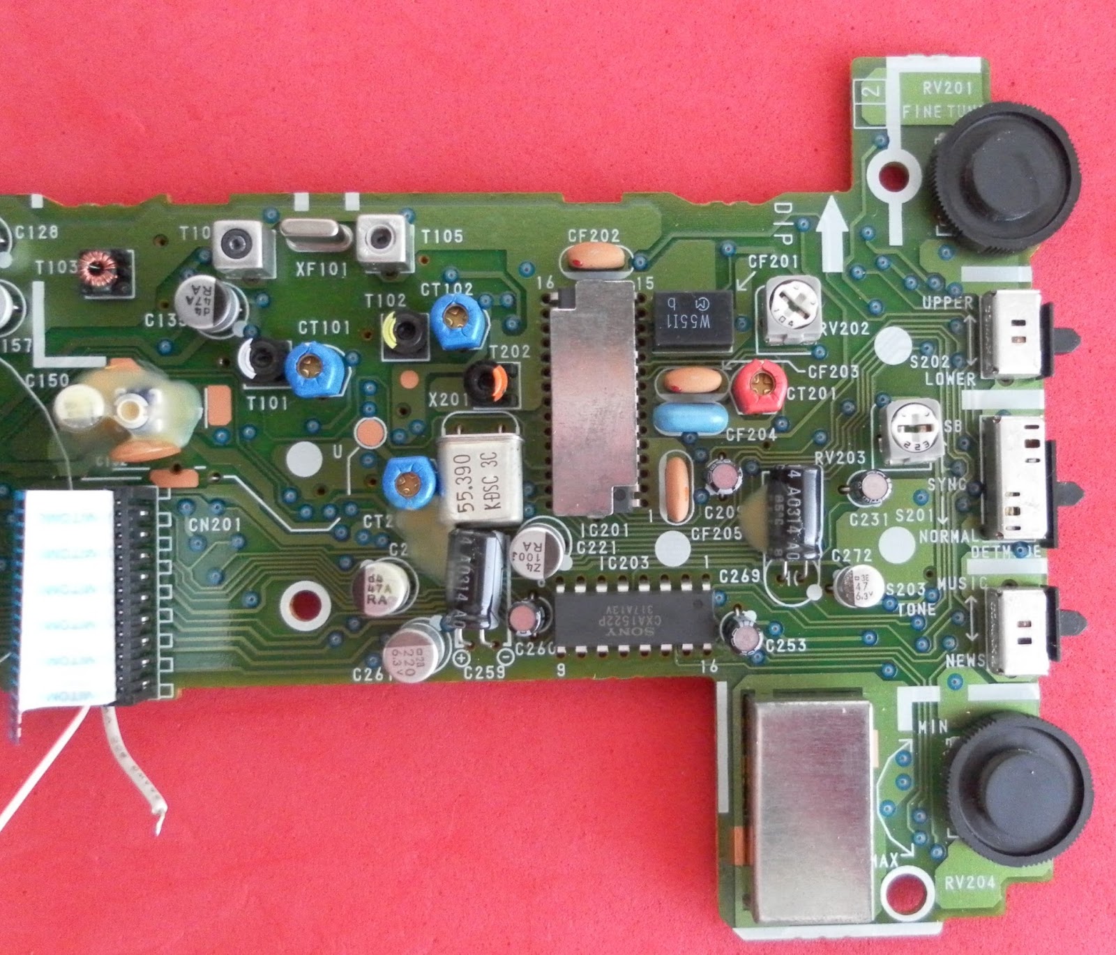

Main Board assembly detail - right side.
"X201" 55.390MHz AM OSC2 crystal visible in the central zone.
"IC203" CXA1522 Pre/Power audio amplifier IC in central bottom zone.
