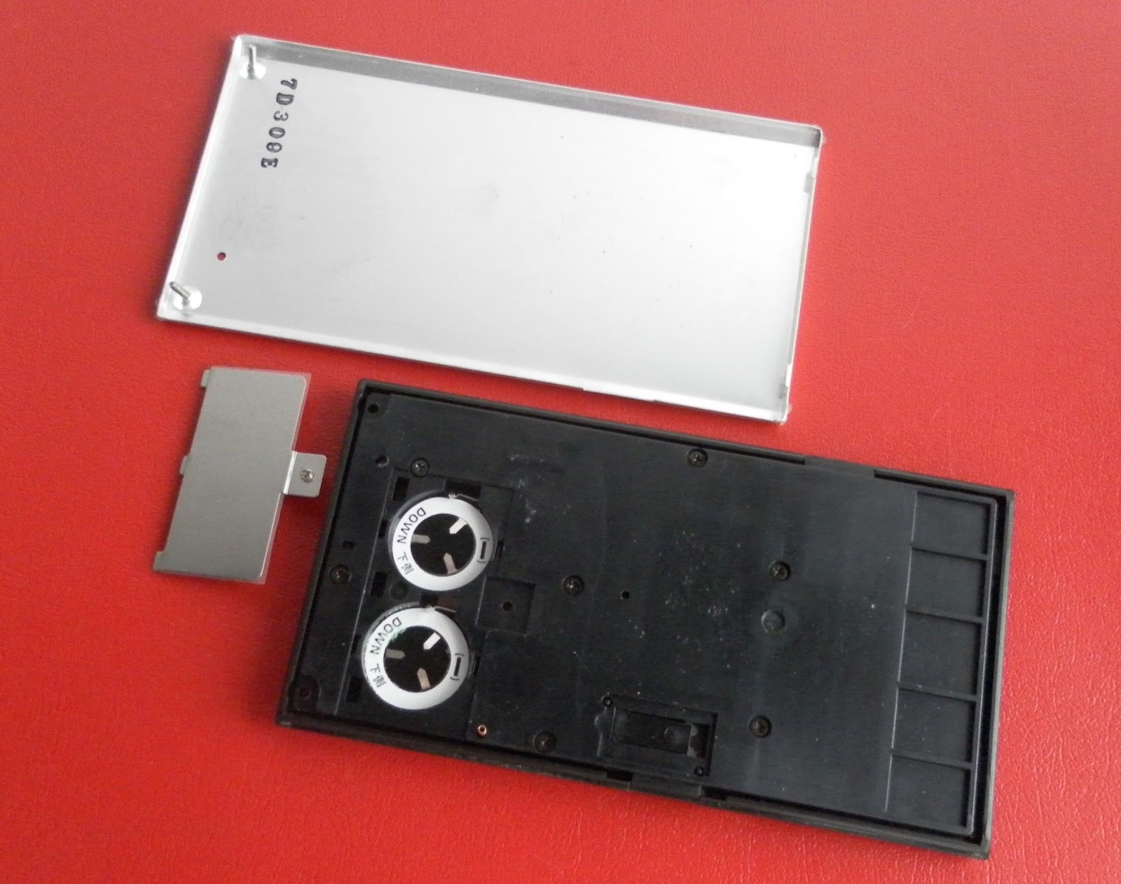

Inside the original Japanese Hitachi CR2032 cells were both dead and fortunately without signs of leakage.
After installing a new set of batteries the calculator came to life nicely.

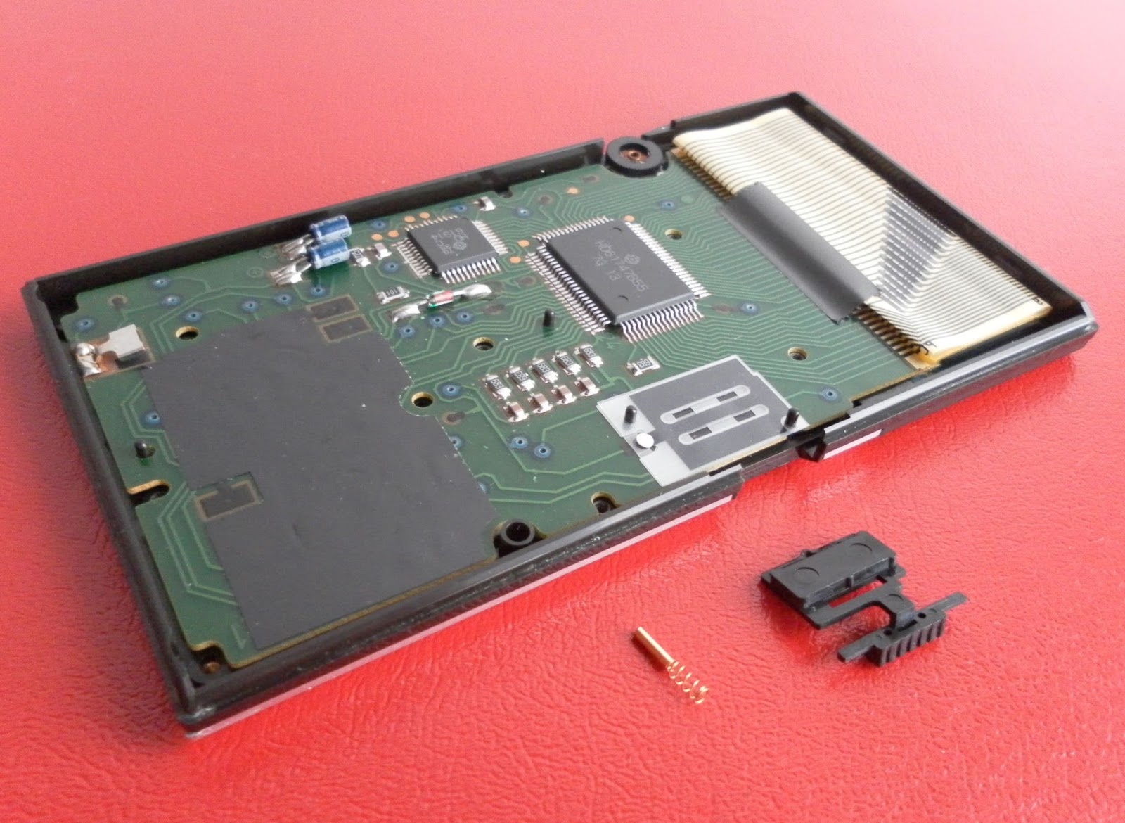

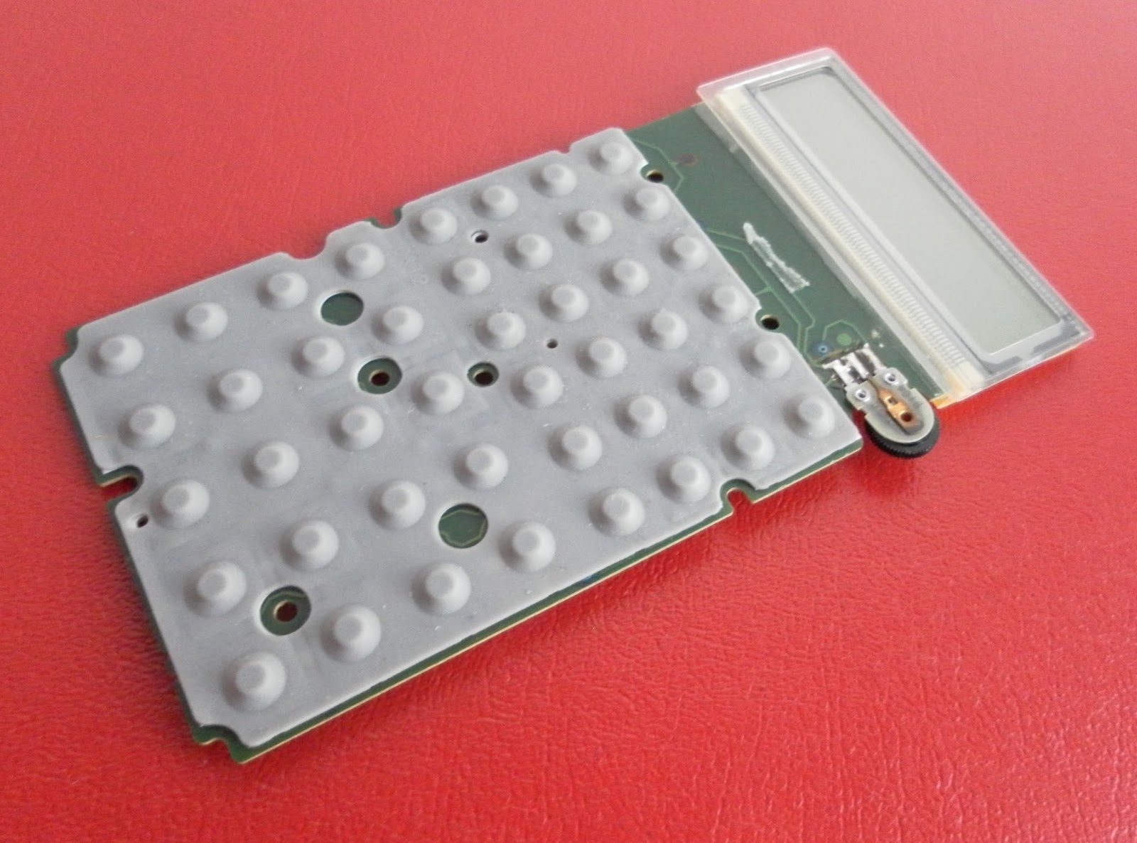

Dismantling for internal inspection.
Well, I have to see my ophthalmologist. When I replaced the old batteries for new ones, I didn't notice a small amount of battery leakage in one of them.
Nothing serious, as the main board has got a plastic protection under the battery compartment for such eventualities.
[Image: Casio_FC-200_011.jpg] [Image: Casio_FC-200_012.jpg] [Image: Casio_FC-200_013.jpg]
[Image: Casio_FC-200_014.jpg] [Image: Casio_FC-200_015.jpg] [Image: Casio_FC-200_016.jpg]
Integrated Circuits:
HD61747B55 Processor.
HD61914 1KByte static RAM.
[Image: Casio_FC-200_017.jpg] [Image: Casio_FC-200_018.jpg] [Image: Casio_FC-200_019.jpg]
