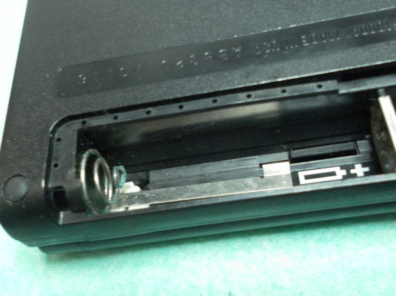

After a brief inspection I saw the problem: Battery corrosion once again caused contact isolation.
Just for testing, I cleaning the contacts just enough to make sure the power supply would not be the root cause.
Plugged in two AA batteries and voilà, it booted nicely!
How simple the world was in the 80's.
An small OS (for Microsoft, that is), probably only beaten by my Sanyo 64KByte CP/M OS running on a Z80 processor.
Battery corrosion ugly head:
[Image: hp-95lx_p005.jpg]
