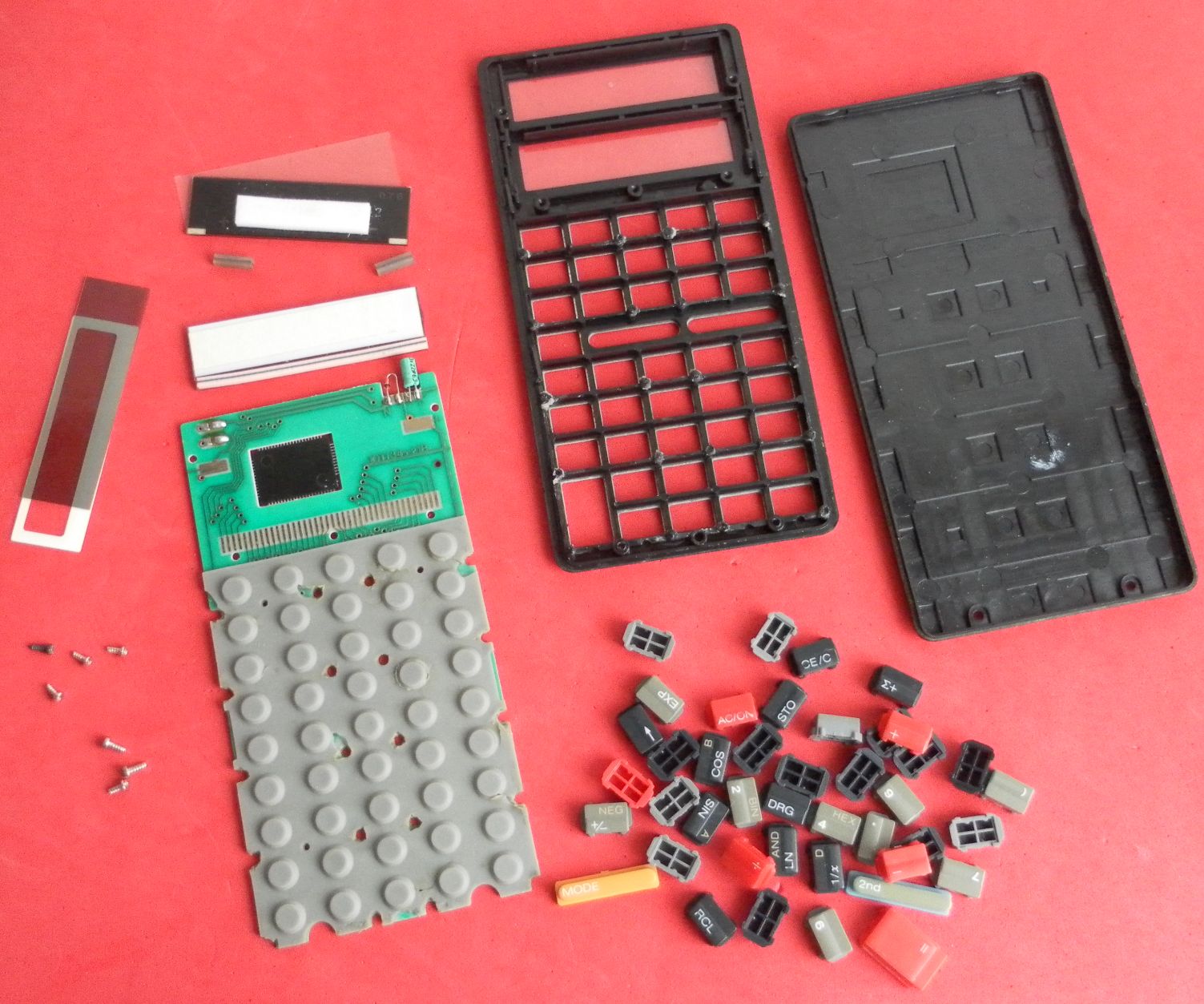

This model is a nice calculator powered by a single power source based on a four elements solar panel. This one was made in 1987, November. This machine was heavily used and abused, showing dents and marks all over the place, and heavy paint worn on the metallic front panel. It was even opened and the PCB removed by destroying the plastic rivets and later fixed back with cyanolit glue that have also stuck the keyboard membrane to the PCB because the glue leaked thru the PCB holes. But it still works fine after all these years and misuse. I have dismantled it and reassembled it with success as well. However I didn't fix the plastic rivets for now, because the back cover have several points of contact with the PCB, forcing it to be in place against the keyboard. Forensics result (9 sin cos tan atan acos asin): 8.999998637 Switching to Mode Hex: NOT(FFFF) = FFFFFF0000 Switching back to Mode Dec = -65536 Back cover label: Texas Instruments I-1187 Assembled in Taiwan R.O.C Jose Mesquita RadioMuseum.org member |

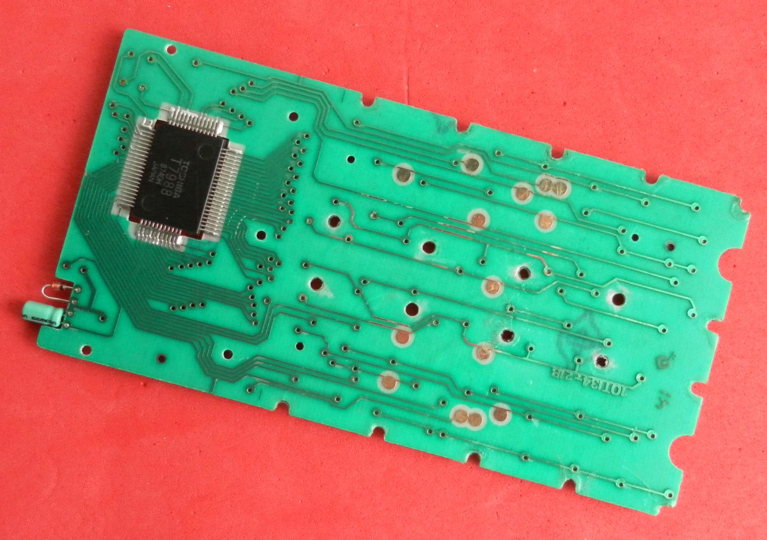

The PCB is fixed by plastic rivets in the keyboard area, and screws in the processor/display/solar panel area.
Unfortunately it is not possible to remove the keyboard membrane because someone made a mistake when using strong glue to do a repair. SoC processor: Toshiba T7988 8740H Japan PCB ref. 10TI34-21B EDIT: Amazingly, the T7988 processor datasheet can still be found! Power supply limiter/regulator: a 1.75V LED and a 22uF capacitor in parallel with the 2.2V solar panel. LCD display. Zebra strip used to connect it to the PCB. Jose Mesquita RadioMuseum.org member |

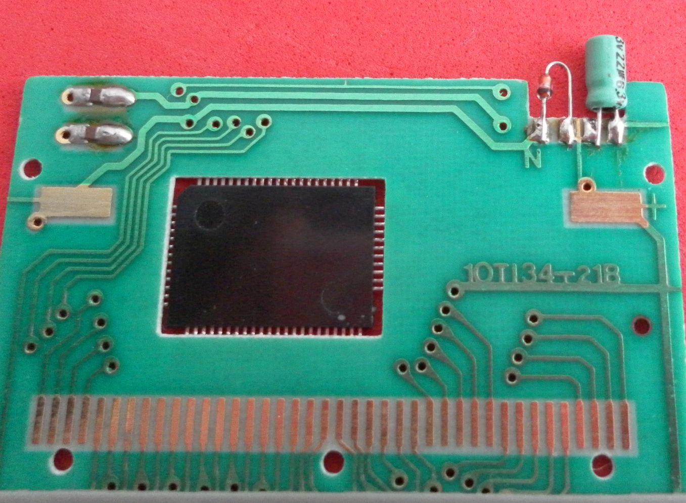

Four elements 2.2V solar panel from National. Two zebra strips used to connect it to the PCB.
General parts view. Power supply details. The solar panel generates 2.2V unloaded (off-circuit) under strong light conditions, and 1.75V under load (in-circuit), due to the tiny axial 1.75V LED installed in parallel acting as a limiter/regulator. The 22uF capacitor gives about 10 to 20 seconds memory contents retention under zero light conditions. The tiny axial 1.75V LED can be seen here being tested off-circuit. Check the bright red light at 3 seconds mark. Jose Mesquita RadioMuseum.org member |
