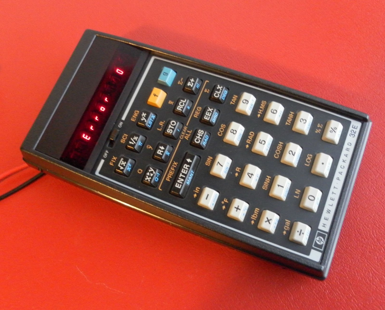

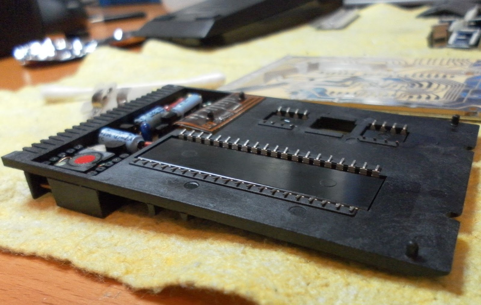

(11-12-2016 11:02 PM)jebem Wrote:  Just for fun, tried to get SQRT(-2). Got an Error 0.
[Image: HP-32E_041.jpg]
And again the self test passing with flying colors.
[Image: HP-32E_042.jpg] [Image: HP-32E_043.jpg]
The AC battery charger i got with this machine has the p/n 82090B.
The battery that came with this machine has the p/n 1420-0313, Made in Japan
(Edited to correct the part number. Originally typed as 1420-0813, but closer inspection of the battery pack label gives me the impression that the correct digit is "3" and not a "8".)
[Image: HP-32E_045.jpg]
[Image: HP-32E_046.jpg]
