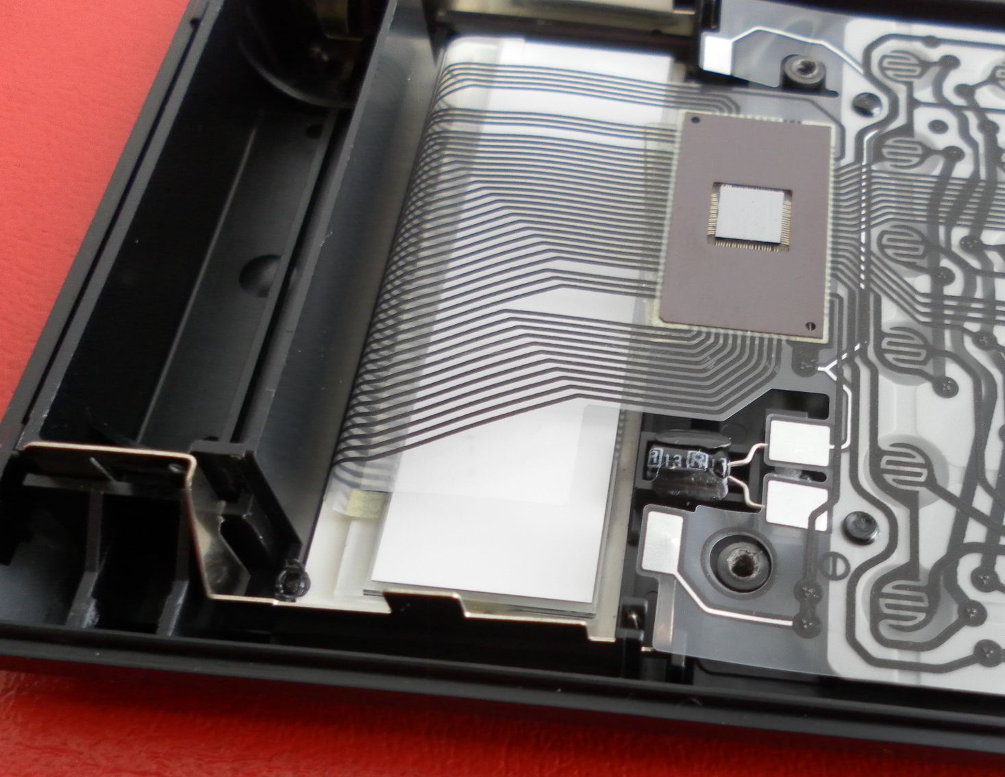

[Image: Casio_fx-180Pa_006.jpg]
The keyboard keys carbon contacts are installed at the back cover.
[Image: Casio_fx-180Pa_007.jpg]
There is no conventional rigid PCB (print circuit board).
The keyboard matrix and SoC processor are deposited on a ultra thin plastic foil acting as a flex PCB that is fixed over the keyboard membrane by using melted plastic rivets.
And there is no soldering at all either.
The battery bypass electrolytic capacitor leads are just melted to the plastic front cover, as well the battery terminals, and they connect to the main flex PCB by just the natural elastic nature of the parts with the help of the back cover.
[Image: Casio_fx-180Pa_008.jpg] [Image: Casio_fx-180Pa_009.jpg]
To fix the missing LCD segments, I used an very old trick that can work most of the times on this kind of LCD "flat cable" connections where the "wires" are just conductive paint deposited over a thin plastic foil.
Because the are no real wires and no conventional soldering involved, we can't use conventional tools and techniques to fix it.
However plain hot air can fix this kind of faults.
So I used a conventional air dryer over the flex PCB near the LCD "flat cable" interconnection for a couple of minutes. Job done. I got a new high contrast LCD display.
