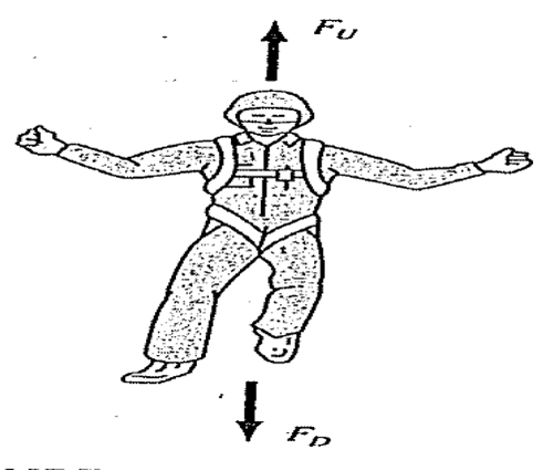

Source: NUMERICAL METHODS FOR ENGINEERS Steven C. Chapra & Raymond P. Canale
[Image: paracaid.png]

Please someone can help me by rewriting the above code to work well
Thanks
