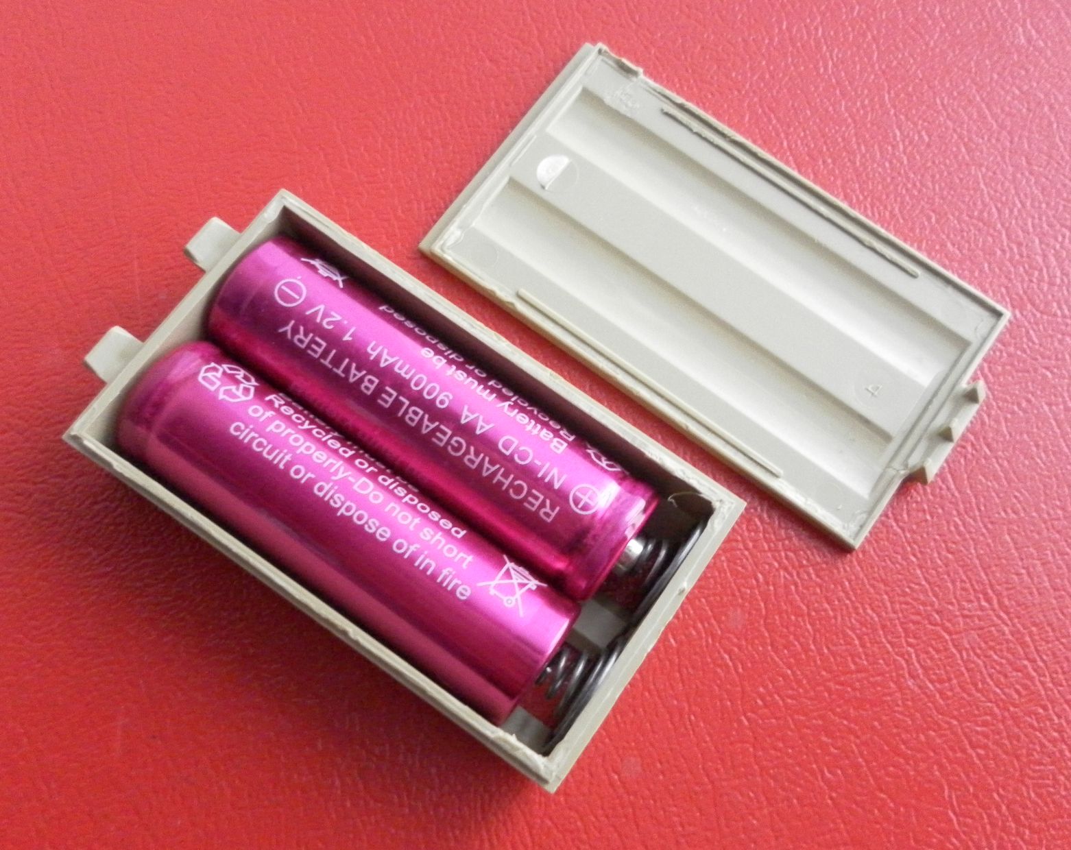

I had the same issue after replacing the original Ni-Cd batteries on one of my HP-25 machines with a new set of Chinese 900mAh Ni-Cd batteries which obviously are a little larger than the originals.
To replace the batteries, instead of breaking the plastic holder at the usual place to remove the dead batteries (cutting the middle plastic strip at the batteries side), I prefer a different approach.
The battery holder is made of two plastic pieces welded together at factory. So to open it on the original place we can use a X-acto knife and lots of patience to not destroy the plastics (or your fingers...).
After inserting a new set of batteries, the back cover can be glued to the case.

(01-22-2018 11:01 AM)jebem Wrote:  ... I prefer a different approach....
I prefer not to take the top and bottom side apart, because it is more laborious. And you cannot recharge the batteries externally after some weeks. But of course, it works well.
If you have to remove the original NiCd cells it is a little more difficult to remove them, when only the middle plastic strip is cut, because they are welded together by a steel band at the rear side and you cannot remove the batteries one by one. But it is possible.
