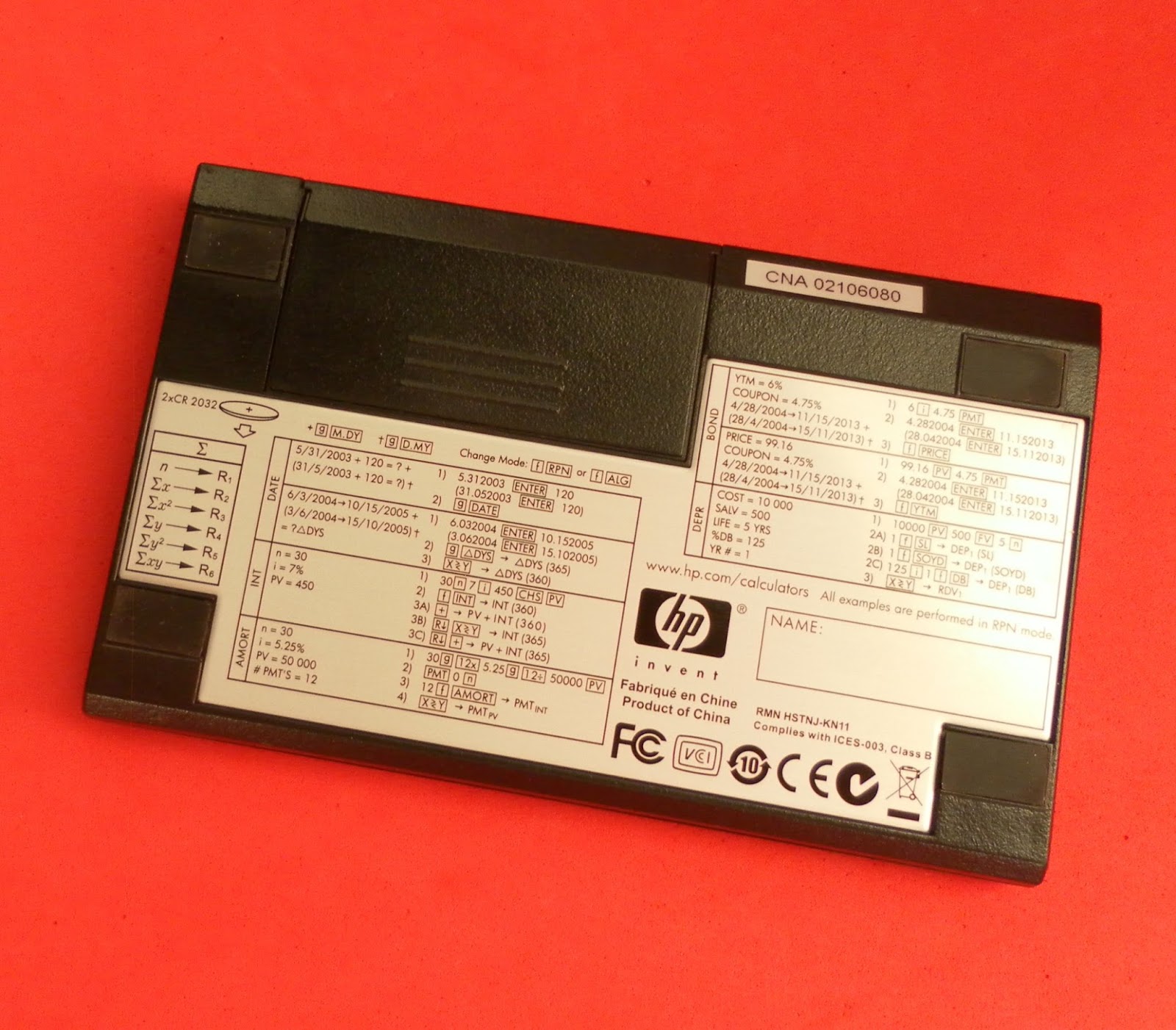

This is my first HP-12C to join my collection, and despite this model belonging to the new manufacturing processes and materials, I'm glad to have acquired it as it looks almost classy as the original models and it works like a charm.
I understand the 12C is the most successful HP calculator of all, and this MoHPC forum has plenty of posts discussing it along the years.
However, for me it is not 100% clear on exactly how many different hardware/firmware versions did HP released along the years.
To increase my doubts, the HP site keeps mentioning that the Platinum uses only one CR2032 3Volt cell (in the specs and on the available user guide).
But mine uses two CR2032 cells in parallel.

I'm not in the mood to open my calculator just to check the processor reference, but eventually I will do it to satisfy my curiosity.

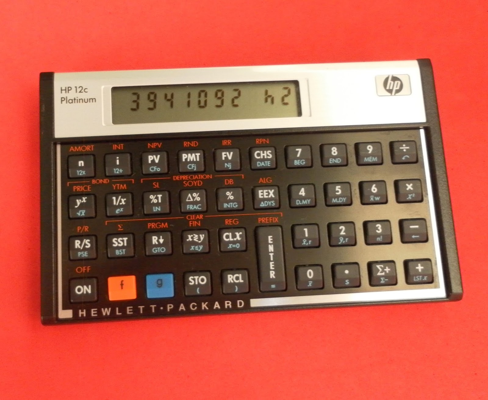

Press 4 (CPU speed): Displays "3941092 h2" (CPU speed of 3.94 MHz ?)
The value will change in the last 3 digits between test runs.
