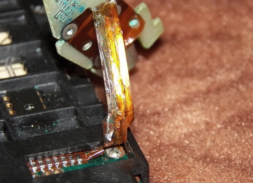

http://www.maxes.ho.ua/Pics/Calcs/Shlrep.jpg
You can do repair this way (as I already done).
Thin wire was fixed by glue after cleaning, but you can try scotch instead...
In the photo above, I do not complete contacts cleaning, as I've done it after making cam shot.
